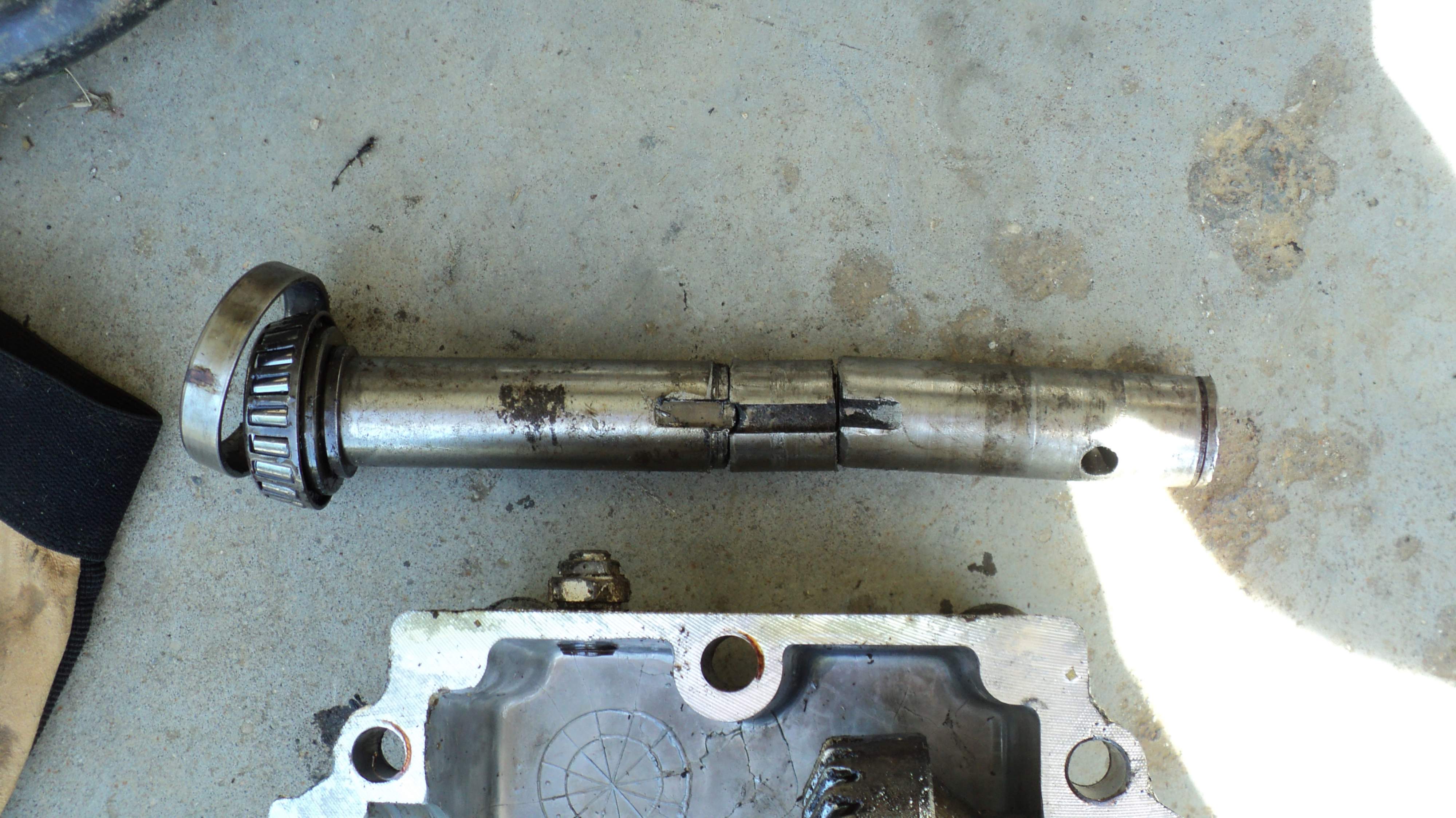

Hello fellow Iseki owners I'm back yet again looking for some advice and hopefully some parts.
I have a Bolens 3 point finish mower that broke an input shaft, I contacted Sam's Bolens and he couldn't get the part so figured nobody else could get a NOS part either so was hoping someone here would possibly know of someone with a parts mower I could scavenge from.
I hate to see the mower go as it is a tiny beast, but if I can't find parts I may have no choice but scrap it and move onto something else.
Thanks for any and all help!

Take a picture of whats broke, maybe I or someone else has an idea.
I could ask a bunch of questions but like they say a pic is worth a 1,000 words.

Thanks for your reply John, I can do that but the part that I need is in a few pieces now as I had to take a cut off wheel to it to remove the bearings from one side and the yoke from the other (plus the original break point), it took a bit of punishment after it broke so kinda got bent and bruised.
I can kinda push it together to get an idea of what I need though, I'll get a few pics up tomorrow after work.

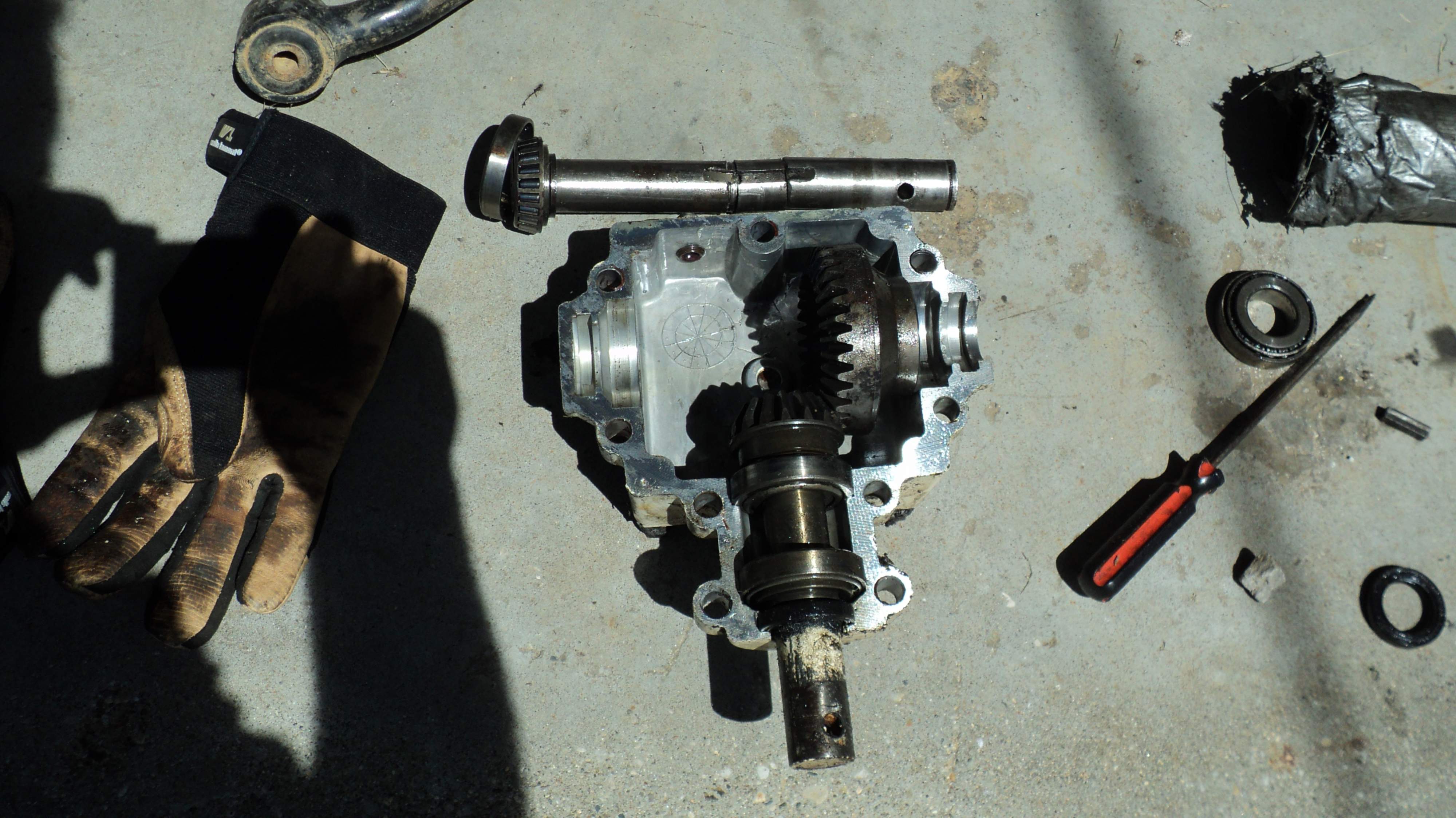

Would be nice if one of those gearboxes would bolt right up as that would save me allot of time, but mine seems to be a bit different that what they offer.
Had time to take a few pics today, the shaft I need is the one in 3 pieces positioned where it needs to go but above the gearbox housing. The break was pretty close to the center of the shaft, the one further to the right I cut off myself so I could remove the bearings and yoke.

I contacted the manufacturer of my gearbox and was told that they can supply me with parts but would be about a 12 week waiting period to get them too me, going to order what I need once the sales guy gets back with me on the cost then will wait and see if it will work.

I would get someone to make that shaft. Doesn't look hard at all to make. What is the OD of the shaft and how long is it?
Who makes the gear box?

I'll still most likely buy a replacement shaft as I'm not 100% sure what it was originally made from, I can notch it with a file so it's probably not hardened so I'll try to make it out of a hard stainless and see how that works out.
The gearbox is at work locked in my toolbox so can't take any measurements, but it is a very simple shaft and can be made in probably less than an hour, the OD looks to be the same the entire length.
The gearbox was made by Superior Gear, a salesman quoted me 416 bux plus freight for a new one but not going to pay that much to fix an old mower, a few hundred more and I can buy a new brush mower that has a warranty.
I looked everything over in the gearbox and have no clue to why that shaft broke, I didn't hit anything and the shear pin is still in good shape as well, I'll look everything over again to be sure but my only guess is stress fractures, it has been used as a bush hog for about a year now and I have hit stuff in the past that dead stopped the engine (when the shear pin didn't break) so I'm thinking that could be what happened.

I think you might be right why it broke, you might want to put in a softer shear pin. I don't know S---- about what kind of metal to make it out of. Maybe the guys at work can help or someone here well see this and give you the info. I sure would go for making it.

I have asked and begged to make it at work but it is a no go unless I pay for materials, labor and have a detailed drawing of the part to be made, it has to be treated as a request from any outside customer.
The part made then shipped to my door from the OEM will run me less than it will cost for me to have it made where I work so I'm having the OEM make it and mail it to me when it's finished in about 12 weeks, I'm hoping the new part will work since my gearbox is over 20 years old now.
