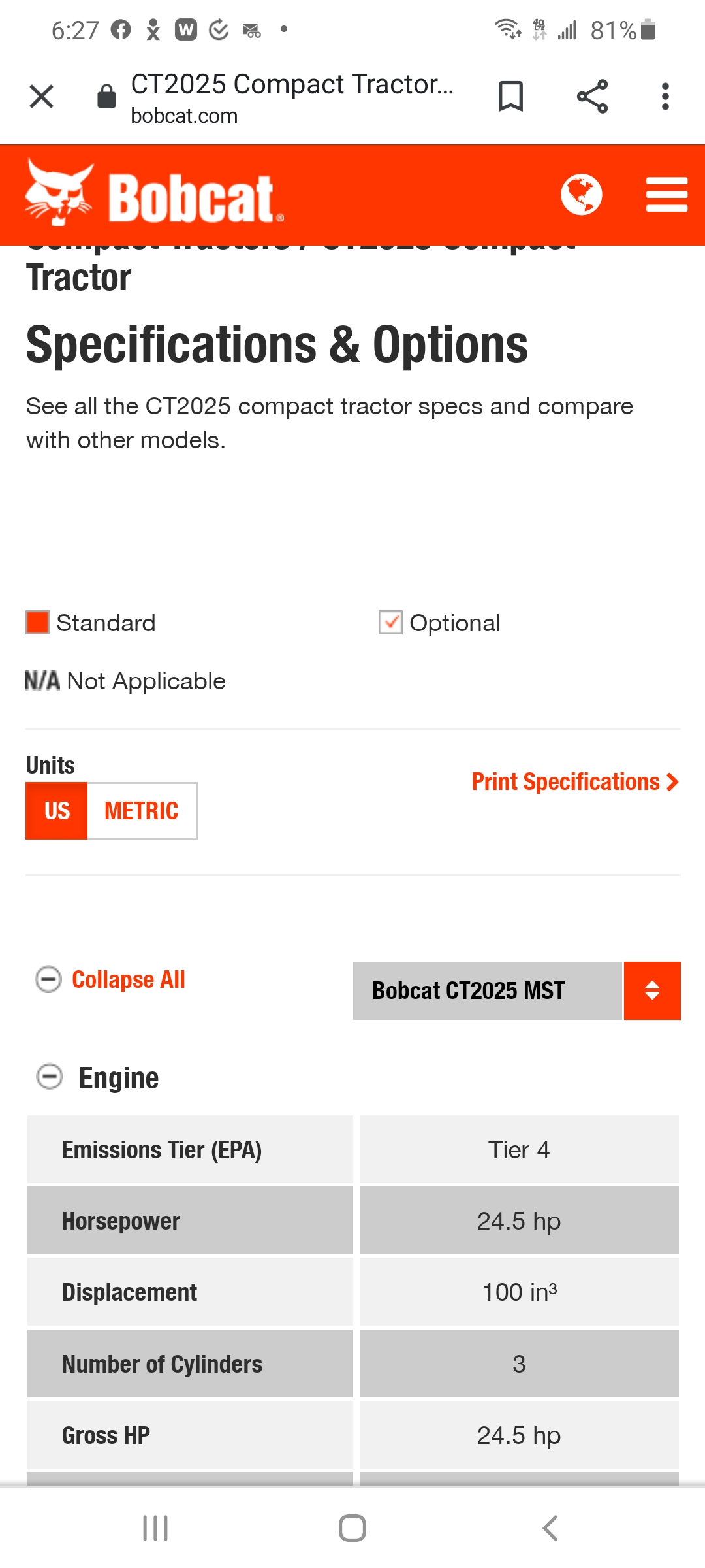

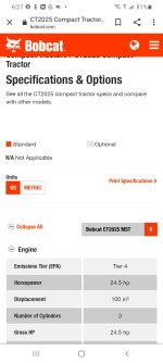

Under the hood... really complicated looking... No DPF
but dealer sent me this when I asked and I remember seeing it before but the engine is under 30 HP so I thought it didn't apply

Even the under 25 hp are tier 4. Difference is EPA standards for the lower horse power are different and engines do not require electronic injection or exhaust after treatment.
New Kubota will also be Tier 4.
Thanks that answers that question. Seems that less fuel would be used then to burn off soot accumulated then.
