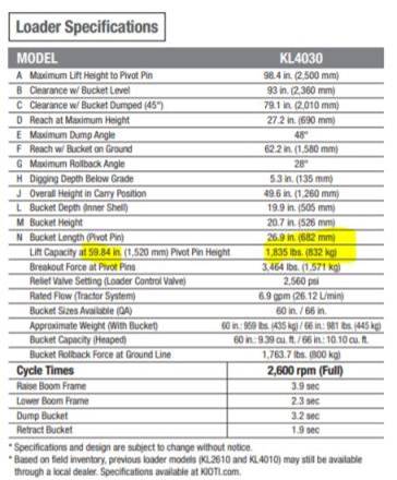

Check that 4030 again please. Lift Capacity at 59" is not the same as Lift Capacity at full height. See Below.
Yeah I know, this topic has been beaten to death already. It's frustrating that Kioti rated the 4030 loader this way. But I'd still wager it could lift more than 1369 lbs to 95" (the ct2025 / FL7 specs), don't you think?
