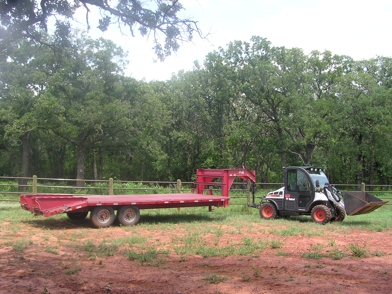

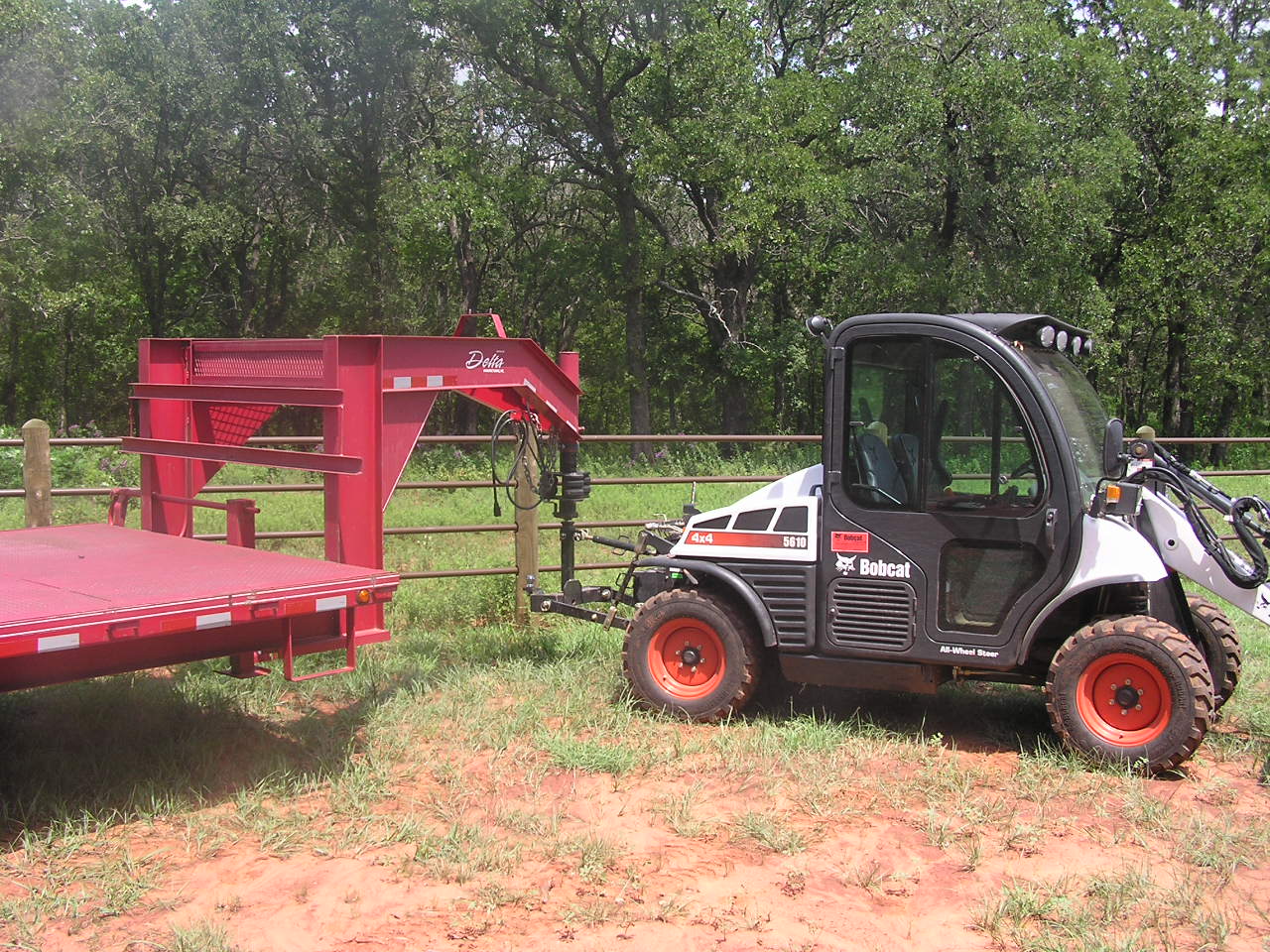

No problem hauling a trash trailer, just don't try this at home! :D
The trailer is 1,000 pounds heavier than the 4,000 pound tow rating. :shocked:
I think that's going down the road, really, and they're fairly conservative numbers. My L3650 was rated for 5,500 lbs... and I routinely moved my 14,000 boat + trailer with it as it was MUCH easier to maneuver around the yard. I've also moved the dump trailer which was about 10-11k loaded many times.
Pulled the stuff a few times with the NX, and it's rated for 9400 lbs or so. No problem at all. I love hitching up trailers with the 3 point and moving them without ever getting out of the cab!

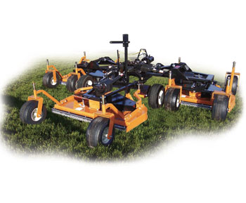

I wouldn't get a flail, I would go with a batwing turf mower (or I would get both). That will give you a 10-15' cut and will leave a nice finish cut.
Here is a batwing turf mower:

For my sports fields there are too many areas a ten foot mower would not fit. I used 72 in scag but had to be careful not to scalp some areas outside of the fields. Traded 72 for 60 to solve that problem.
