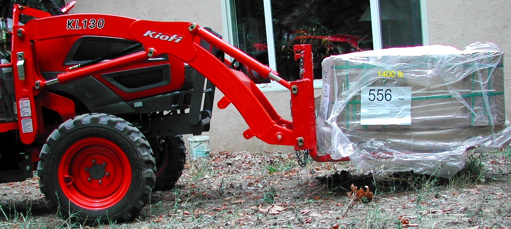

All these loaders lift LOTS more when down at lower heights AND you just
destroy your capacity by using those 500-600 lb pallet fork frames.
Here is a photo of me lifting 1400# of ceramic tile on a pallet that weighs
maybe 80#, on a fork frame that weighs 200#. That is 1680# (verified)
that I could barely lift off the bed of my PU. Note that I can also lift even
more by using the curl function of my loader, which I have enhanced by
increasing the bucket pin spacing. After 4.5 y, I am happy with this FEL.

   / Bobcat FEL's - 7TL, 8TL, 9TL what are your experiences? #15
That's correct! Published pecs for backhoe attachments are not easy
to compare either.
My new Bobcat CT230 is supposed to come with the 7TL FEL, which has
lower specs vs. my Kioti's KL130. I will compare them when the new
machine comes in. It will have the BobTach.
I think you have it backwards. The 7tl has higher specs than the kl130.

   / Bobcat FEL's - 7TL, 8TL, 9TL what are your experiences? #17
Yeah, I got it confused with the FEL for the CT122 (6TL?), which lifts
less than the KL120 on the CK20.
Now to see how the BobTach reduces the lift capacity on the 7TL.....
