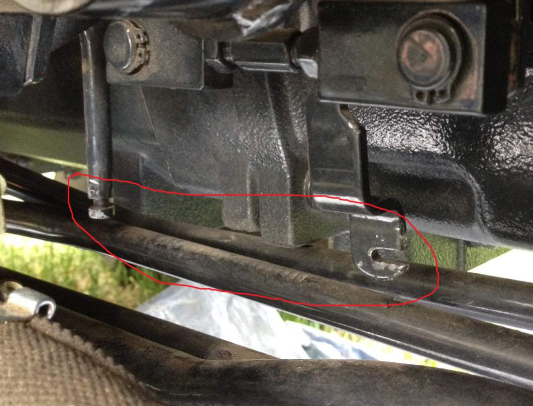

I was recently out in my woods and had a little excitement when I couldn't get my tractor to stop. After inspecting the tractor I found I'd lost a part that looks like it should be some sort of damper or spring that would attach to the circled ct440-1.jpg. whatever was there must have broke or was taken off by brush?

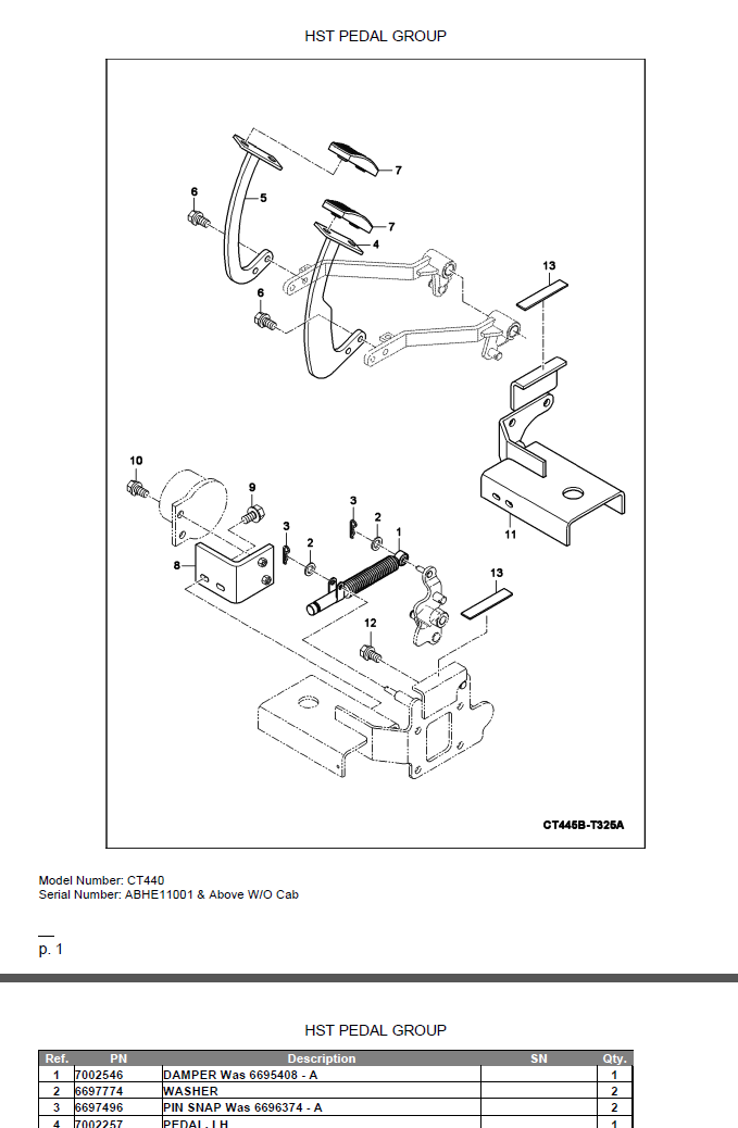

The local Bobcat dealer sold me part number 1 from this diagram ct440-01.PNG. They didn't have any other Bobcat tractors for me to compare mine to let alone an older one. I returned the part as there is no way that it will work. I noticed the parts diagram says ct445 even though the service tech was looking under the ct440 list.

I looked on my CT445. On the side with the forward/reverse pedals it has what your picture shows.
There's a spring approx 1/2" diameter connecting the pieces where you have drawn the red circle.
There's a picture (P-81577) of it on page 30-40-1 of the CT440,CT445,CT450 Service manual
Note that the text block with P-81577 obscures part of the picture of the spring.
I'm unable to locate an expanded drawing or any other reference to the part.

thanks for the info!
I did a little more digging in my book and found a another picture as well in the maintenance manual. Now that I know what i'm looking for maybe i can make some progress at getting the right part. last resort maybe i can find something at the hardware store that would work.
