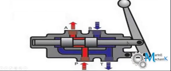

It would help your understanding if you got used to using the correct terms as it makes finding info much easier.
Look at the first illustration posted which is of a simple hydraulic valve.
The ports are identified P (for pump) which is the flow from the hydraulic pump, T (for tank) which is the flow to the reservoir from the valve which is from moving cylinders and the relief valve.
A and B are the work ports to a hydraulic cylinder.

On a loader valve as you describe, there will be 7 hoses. 4 for the loader arm and bucket cylinders, a P, a T and then the important one for your project.
Power Beyond or in some circles called HPCO for High Pressure Carry Over is the port/line that should be used to feed another hydraulic control valve.
Currently, the PB line is likely used to supply the 3 pt hitch.
Valves typically do not come with PB but rather have provision for an optional plug or sleeve to be installed which then provides the PB feature. See attached illustration.
A T port, possibly a T2 port will have a plug that is removed to allow the PB option to be installed.
Compact loader tractors with a backhoe often have a power beyond loop to supply the hoe.
To get into details of this setup, more info is needed on the valve your backhoe will use.
