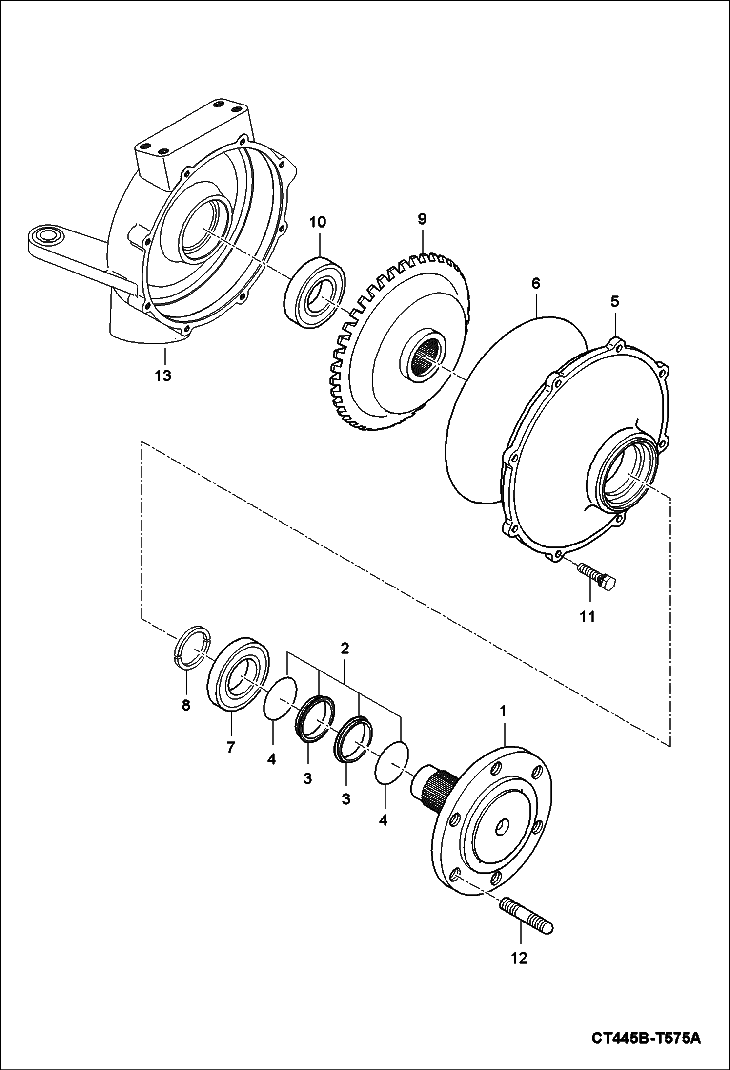

OK folks...think the problem just got more expensive....turns out the issue is in the following: View attachment 663372
#7 Bearing was shredded, that in turn caused group #2 to shred and then the real issue....#1 on the base of the axle shaft there is a small (1/16 maybe 1/8 nick) and (it gets worse) #5 where it seats against #1 is all eaten up and chunks missing.
I could grasp pictures if needed but I think the diagram and my explanation should suffice....the question is #5, that's all integrated as one piece, correct? I can't press out the damaged pieces and replace just them? Regarding the nick on #1, does that nick require replacement of that as well, or can I sand it relatively smooth (ie, take away the edges) or would that ruin the seal for the #2 group.
I think I know these answers, just hoping that someone else has some real word experience.
