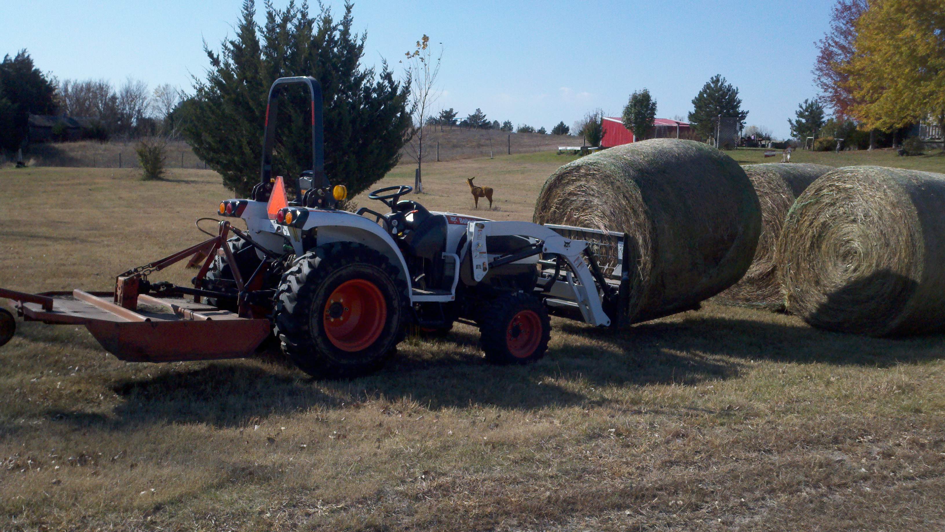

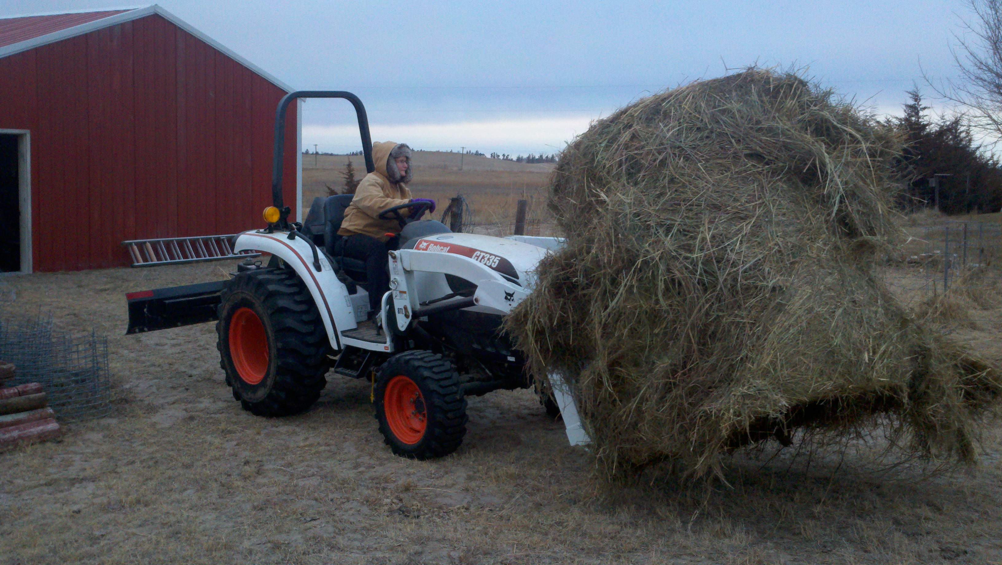

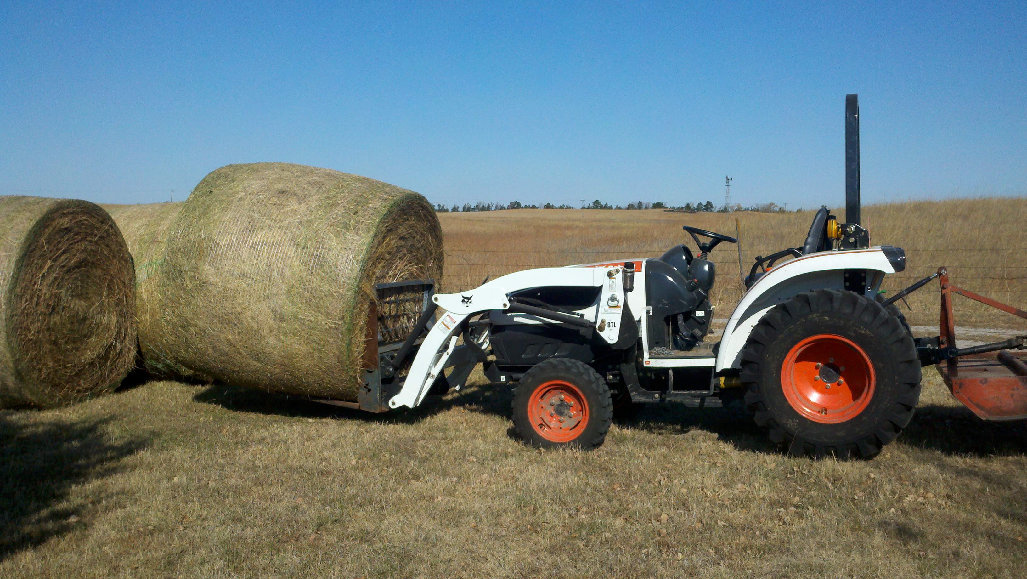

I have a Bobcat CT 335 and I can move the big bails but it is alittle tippy. I had my bush hog on back. You might beable to move them around I just would'nt want to move them very far or on rough ground.
