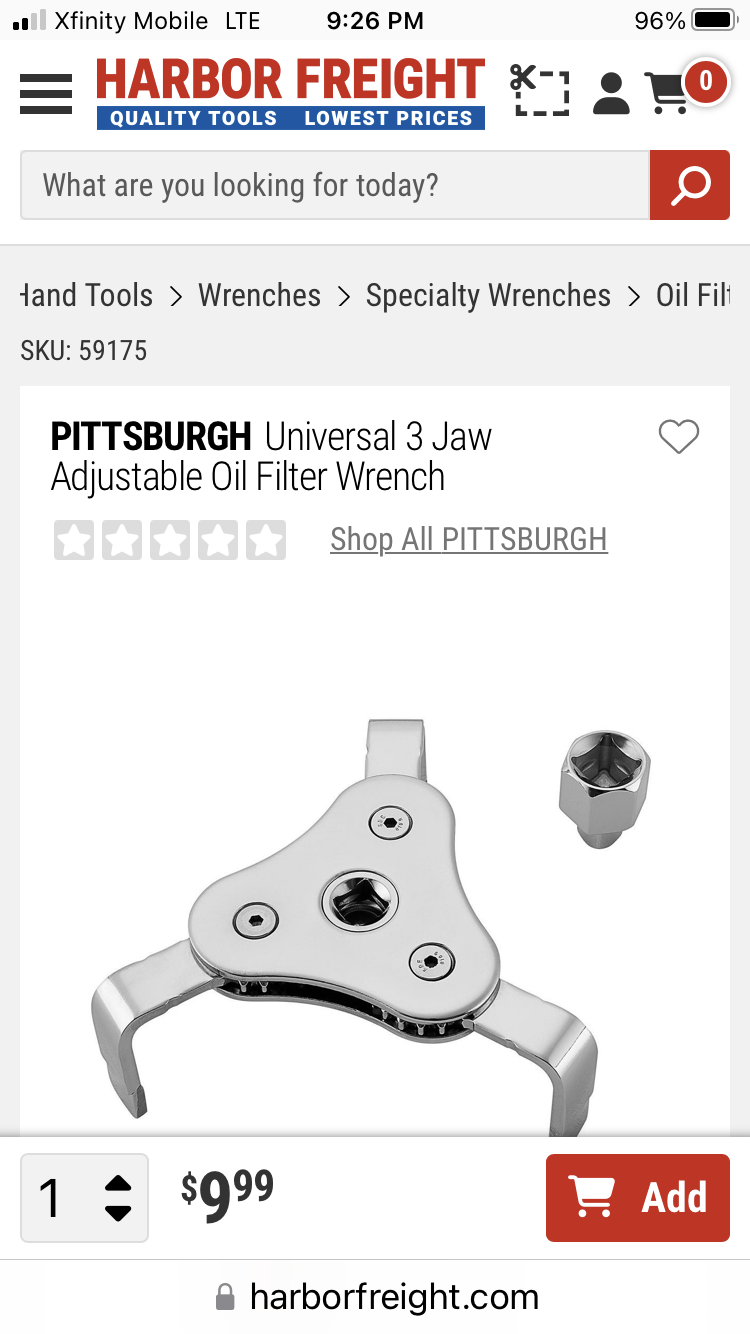

   / bobcat 334 case drain filter replace help #3
Try this I’ve had good luck with them

OK so DUH I've solved my problem. The first main hydraulic filter is in the way and when you remove it a lot of fluid drains out from the radiator. Metal connection so you can't clamp it to prevent it. I had just quickly put the new replacement one on to stop it leaking. Then well I couldn't get at the second case drain filter. Well with the main one out of the way you do have clearance to get a wrench on the case drain filter behind it. At least in the off direction which is most important. Putting new case drain filter on hand tight 3/4 turn is possible if you keep everything clean and have grip gloves. And then, put the new main filter on. Just have to be ready with something to catch the fluid, its not that much, a milk bottle with a cut out fit in and worked fine.
It was raining, and getting dark and and... ok no, I just wasn't thinking, DUH. I will be getting one of the suggested wrenches anyway, can't have too many tools, right?
