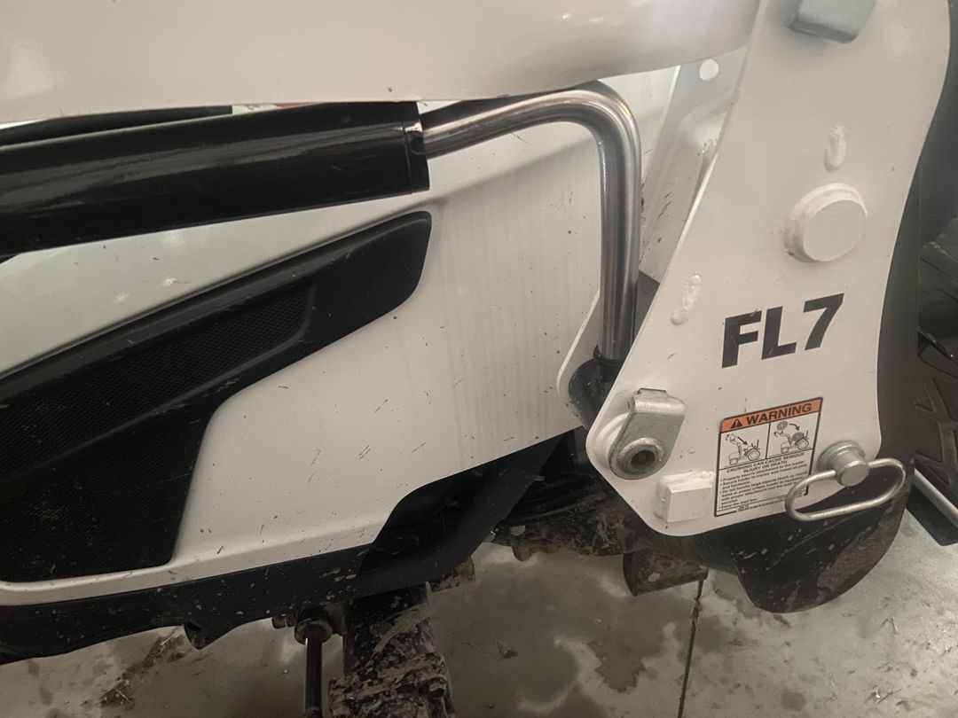

I have an 18 hour old 2025 HST with the FL7 front end loader. The left hydraulic cylinder some bent at a 90 deg angle. I am an industrial vehicle journeyman mechanic by trade and have no idea when or how this happened on my tractor. It took me a little bit to even see this until I went to use my grapple and it wouldn't work correctly. I'm going to take it in to be looked at the dealer but I'm also looking for ideas of how and why this would've/could've even happened. I also noticed that the cylinder part # 7389022 is not in stock anywhere. I've been trying to find the exact specs on that cylinder to try to find a replacement cylinder in case the dealer won't warranty this cylinder. Any help finding the exact specs of this cylinder would be greatly appreciated.

Wow that's impressive!
I'm thinking maybe inadequate heat treatment on the cylinder rod. IMO having the expectation that it be covered under warranty is completely reasonable

Thanks I'm hoping it'll be covered but when I saw the "0 in stock" I'm not feeling very confident in finding one. That's why I'm trying to get the exact specs to try to find a generic replacement that I can buy to be able to use my tractor loader.

If it comes down to it a good hydraulic shop can replace the rod from chromed rod stock
   / Bobcat 2025 HST with FL7 loader hydraulic lift cylinder help #5
How many hours on the tractor and what year? I assume its newer since you mention warranty. How were you using the tractor when that happened?
With where the bend is the loader would have to have been about half way raised, and dont see how one could do that even if they tried. So yea, im leaning toward maybe bad heat treat as well

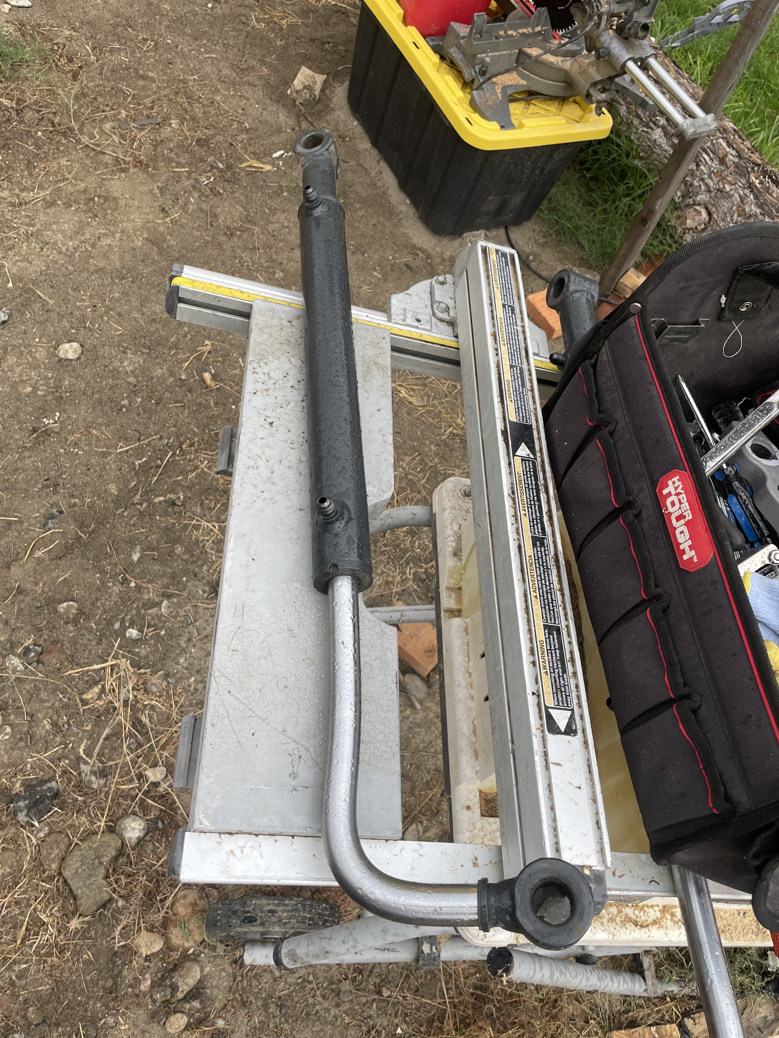

Looks familiar, except both of my cylinders look identical. So what was the outcome. I only have about 50 hours also, I was picking up tumbleweeds with a fork attachment on my bucket. Owned it less than 6 months.. dealer told me it was operator error. No warranty, $800 per cylinder, and as mentioned, none in stock
