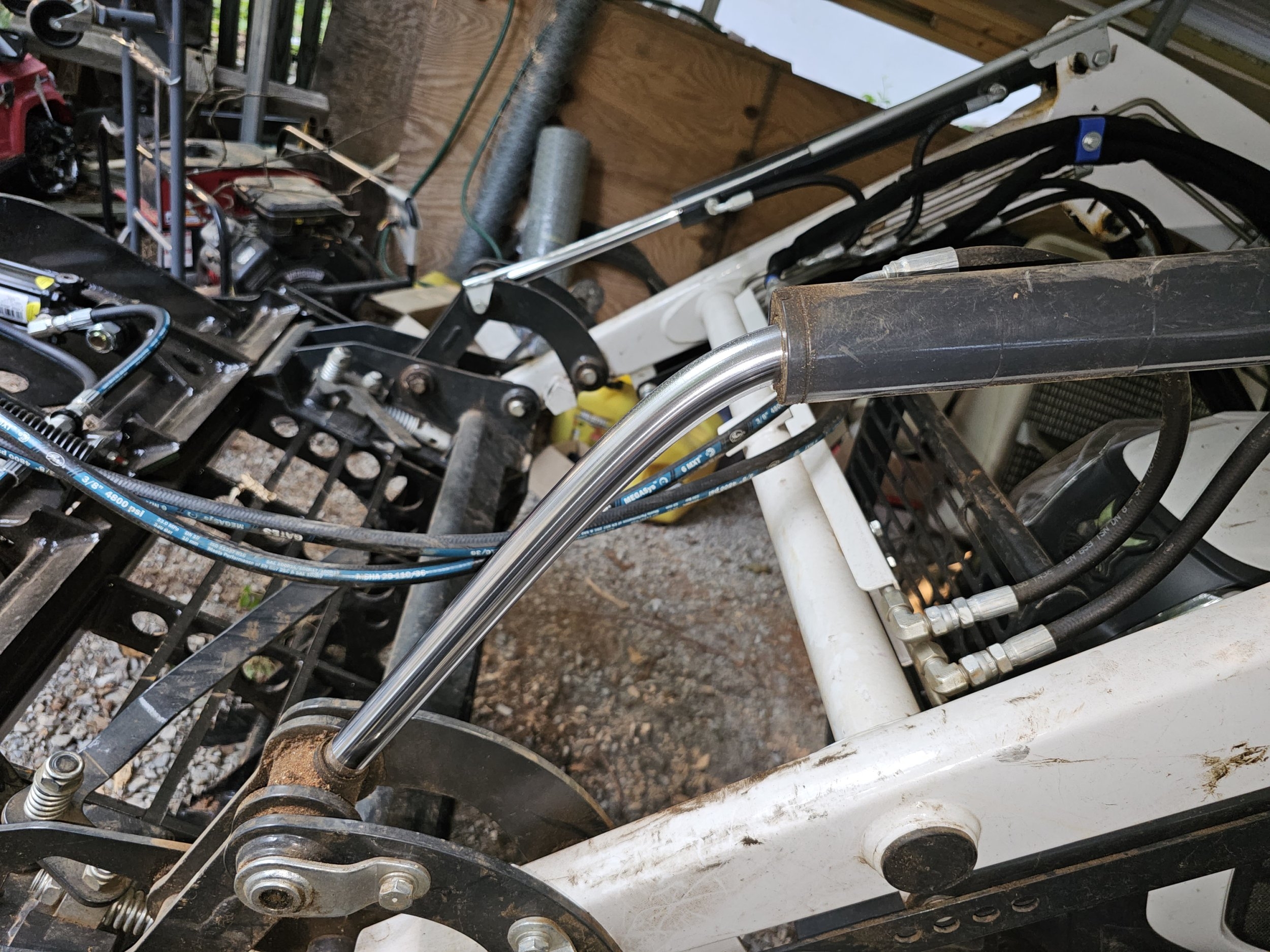

Let's just say things happened, just can't have nice things and now I need a new bucket curl cylinder for a bobcat ct2025 with the fl7. I'm not sure how to measure to get an aftermarket but if I can figure it out I know it would be about 1/4 the price of bobcat, also my local dealer isn't great and bobcat's site doesn't list it. Any help would be appreciated. Recommendations where to order is also appreciated.

If you don't mind, what did you end up doing to fix this?

I just bought the factory cyl for around $800. I messaged online they sent me the part number and I ordered from the site. Took a couple mins to put on. Longer because I was by myself, easier if you can have someone man the controls to b get the right length to put the pin in.

I gotta know how this happened so I can avoid it... that's bent so much!
