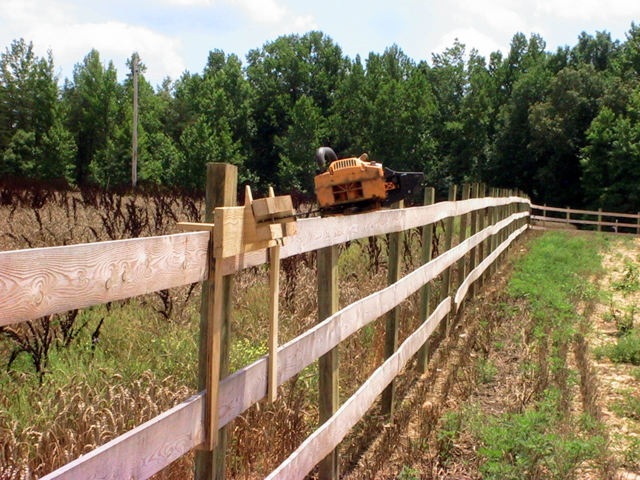

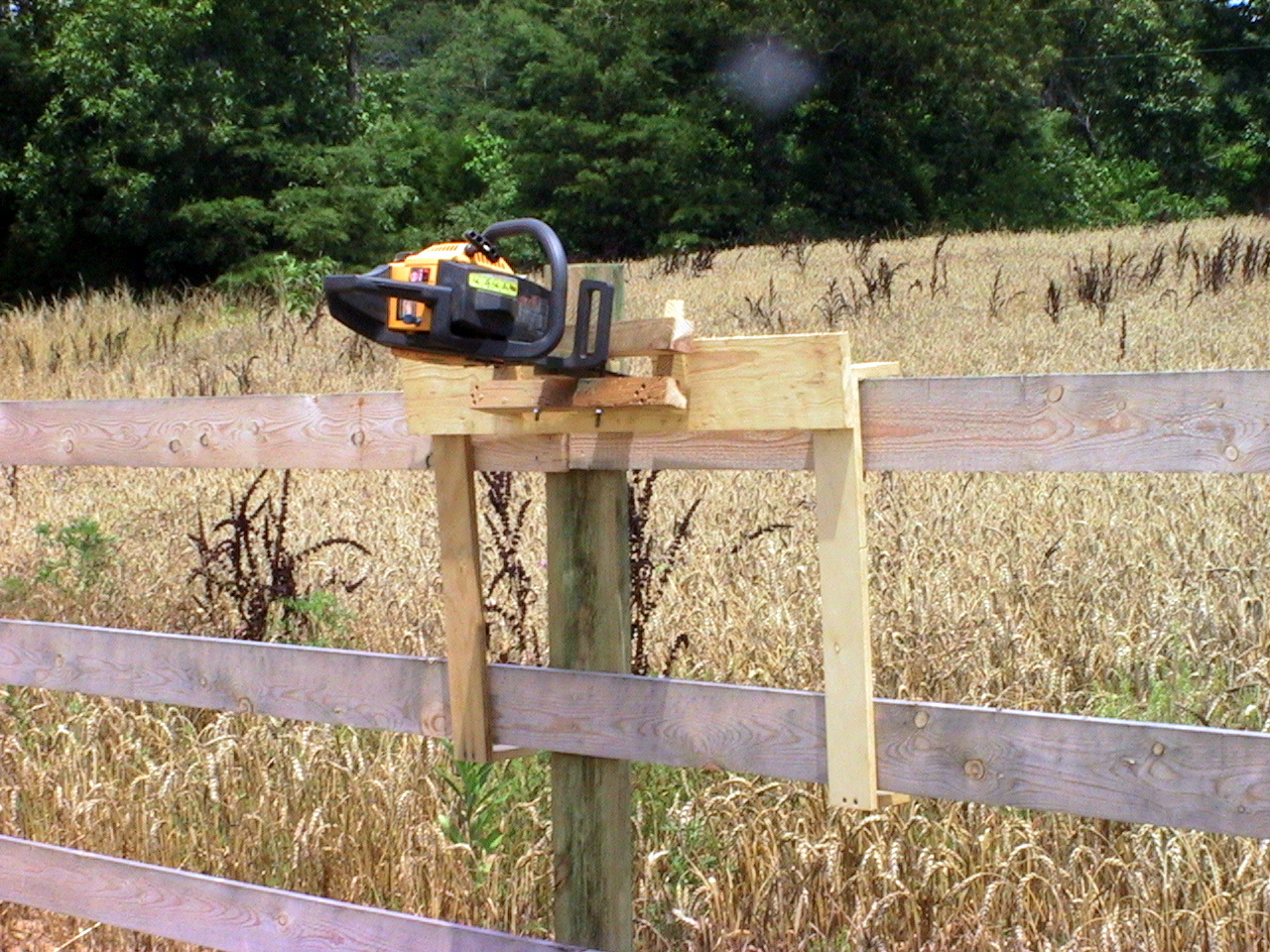

I use a chain that I build a steel jig for that sets on the top rail if the fence. The jig a has a slot in it that interfaces with a piece of steel that is bolted to the bar of a small chain saw (12" or 14" bar) that holds the bar at 12ー angle in my case about 1" up from the top rail. One thing is to do is mount the chain saw so the clutch is facing down so it will not get clogged up with saw dust/chips.
Josh gave me the idea for the jig. :thumbsup:
http://www.tractorbynet.com/forums/projects/156233-board-fence.html#post1808469
   / Board Fence Build - pictures and a question
#26
dieselscout80 said:
I use a chain that I build a steel jig for that sets on the top rail if the fence. The jig a has a slot in it that interfaces with a piece of steel that is bolted to the bar of a small chain saw...
I thought about a jig that would slide across the top rail and touch the backs of the posts.
   / Board Fence Build - pictures and a question #27
That is a really cool jig set up. Looks like it made quick work of that part of the job.
Curious about how long for the whole project?
