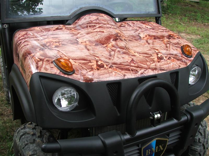

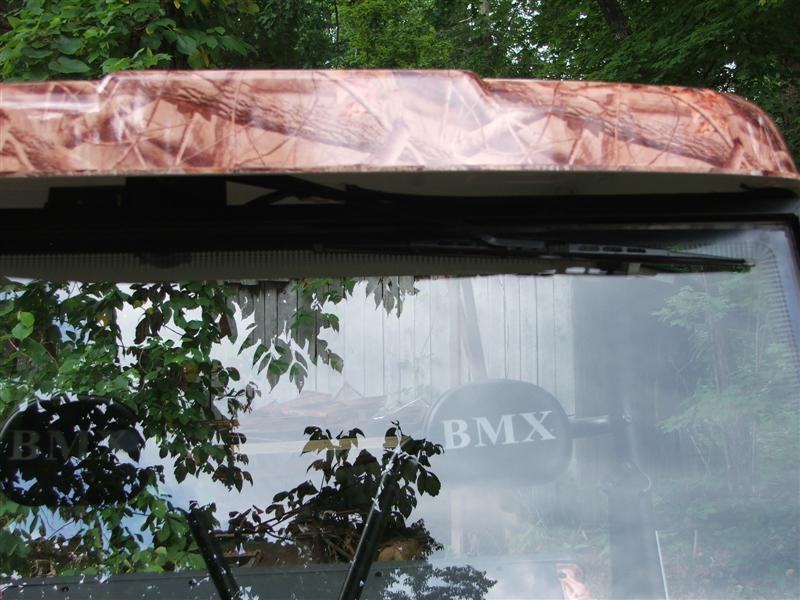

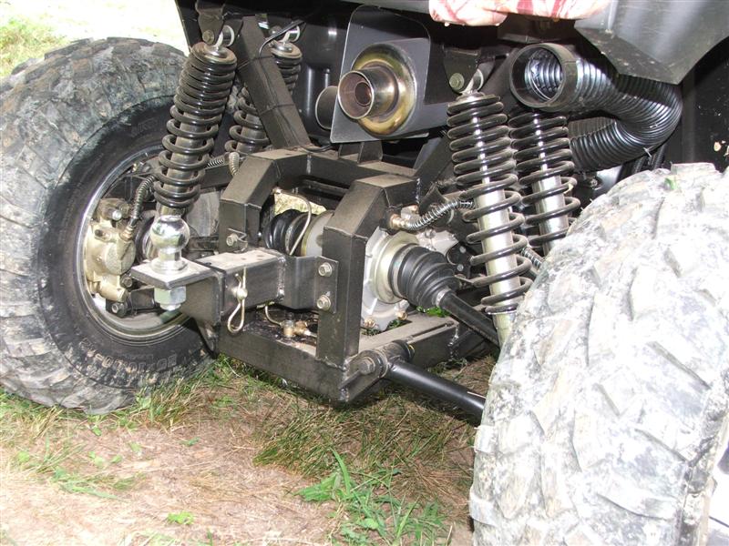

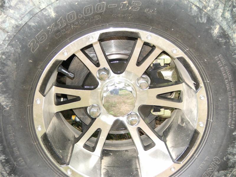

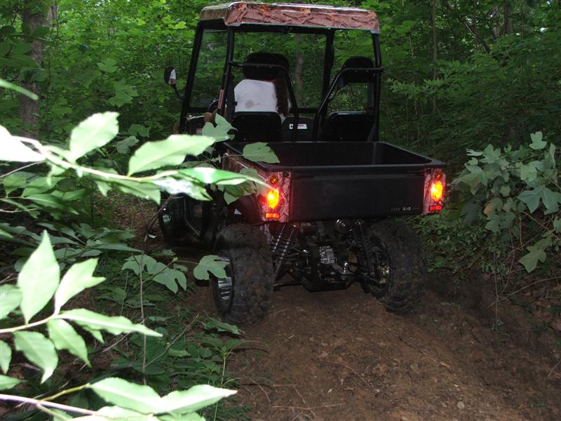

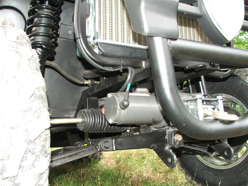

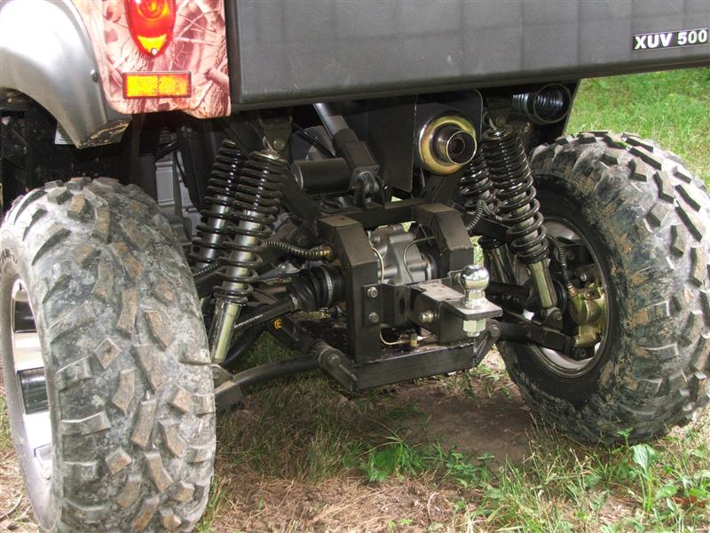

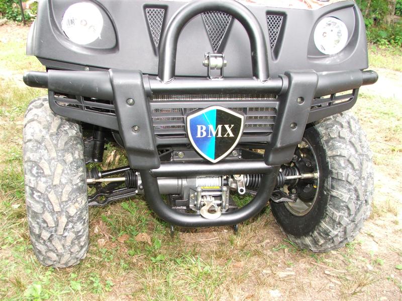

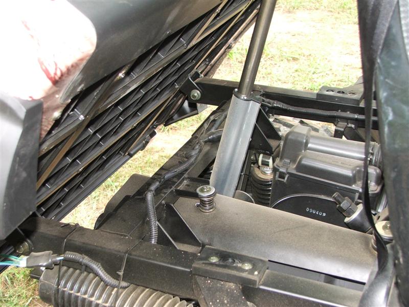

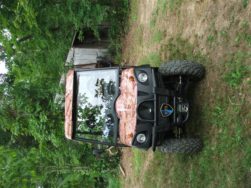

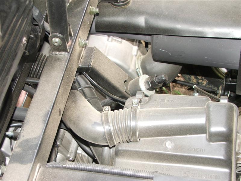

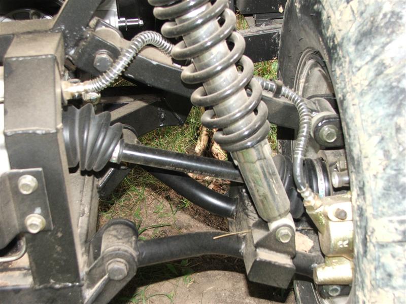

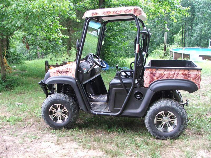

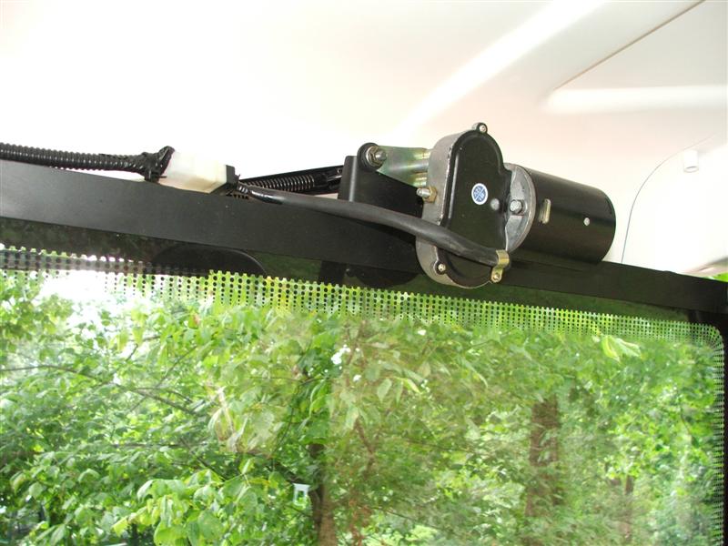

Checked out the BMX, definitely after the Rhino market, rear differential is locked all the time so when it is turned it tears up the grass just like the Rhino. That is one strike against the Rhino for me, works for others. The way it sounded and the way it run, all Rhino. I don't know if the BMX is good or bad, but it goes like stink, impressive with all the extras for the money. I won't get one, but here's some pics to look at.

Milkman: Enlighten me a little bit. Their ad says locking differential. Does that mean it is locked all the time? Is that the way the Rhino is also? Which UTV's are not locked? How did the workmanship appear to be on it? Some of the China ATV's I have seen, look like they used chewing gum. Some have very poor welds. Their ad really sounds good as in my area a old beat up, well run, Rhino will bring $6K. If it was any good I would'nt mind buying one as it would be new and not someone's worn out problem.

John, I looked the frame over and the welds were not sloppy and it had a lot of braces on the frame, we rode it around and there didn't seem to be any flex in the frame at all. The rear end is locked all the time the same as the Rhino and some others, but the front differential is not locked until the three way switch on the dash is in the locked position. The switch has a 2WD/ 4WD/ and 4WD lock position for the front differential. Since it is Chinese, I was surprised that the fit and finish looked as good as a friend's Rhino. It started instantly and the CVT worked like it should and it has a lot of power. It seemed to be more play with some work capabilities as the bed is smaller than the work oriented UTVs and the bed lift is slower than the hydraulic lifts, don't know the lift capacity but I think it is rated at 600Lbs. in the bed and about double that in towing capacity. The machine came in a metal frame and there was some assembly and the instructions were lacking, but wasn't hard to figure where stuff went, could get by without the instructions if mechanically minded. I would not want to guess the price of some other UTVs with all the extras this one has, it even has the 2" receiver and chrome 1 7/8 in. ball included. The only reason that I won't get one of these is, I'm holding out for the machine I've wanted since they've hit the market, the RTV, just waiting for the right one to come along.
