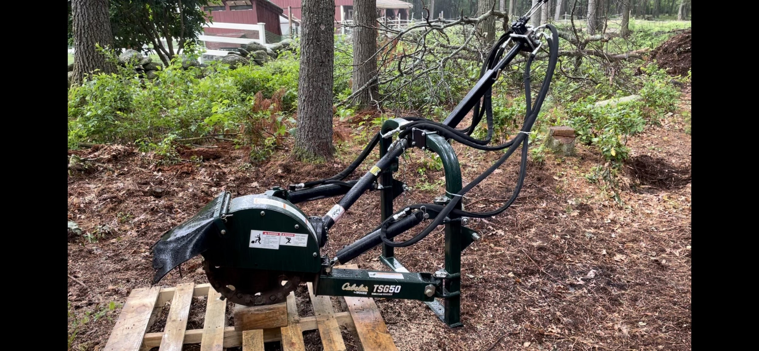

I have a brand new Kioti DK5310SE tractor I just bought this year. I also have a Woods TSG50 stump grinder. I've had two incidents now where I was about two hours into stump grinding, and upon repositioning the tractor and lifting my 3 point hitch, I've blown out an oring on the tractor's rear remote. The oring seals between a side cover plate and the rear remote. It's been to the dealer twice and covered under warranty. The first time they found one of the cover plate bolts was loose. The second time that was not the case, but in each it appeared the oring had been forced out. They've had the rear remote valve off and have mic'd the gland where the oring sits and are telling me it's all to spec. Now they're looking at me as if there's something off about how my stump grinder is plumbed. I've talked to a few other dealers, and Woods Equipment, trying to figure out what the issue might be. Hoping a hydraulic expert on here can help, as it sure is frustrating. I'm afraid to use the grinder again, thinking I need to come to the bottom of this so it doesn't happen again. Here's some details and photos on the setup.

  • Has two dual acting hydraulic cylinders, but only 1 inlet and 1 return hose. To accomplish this:

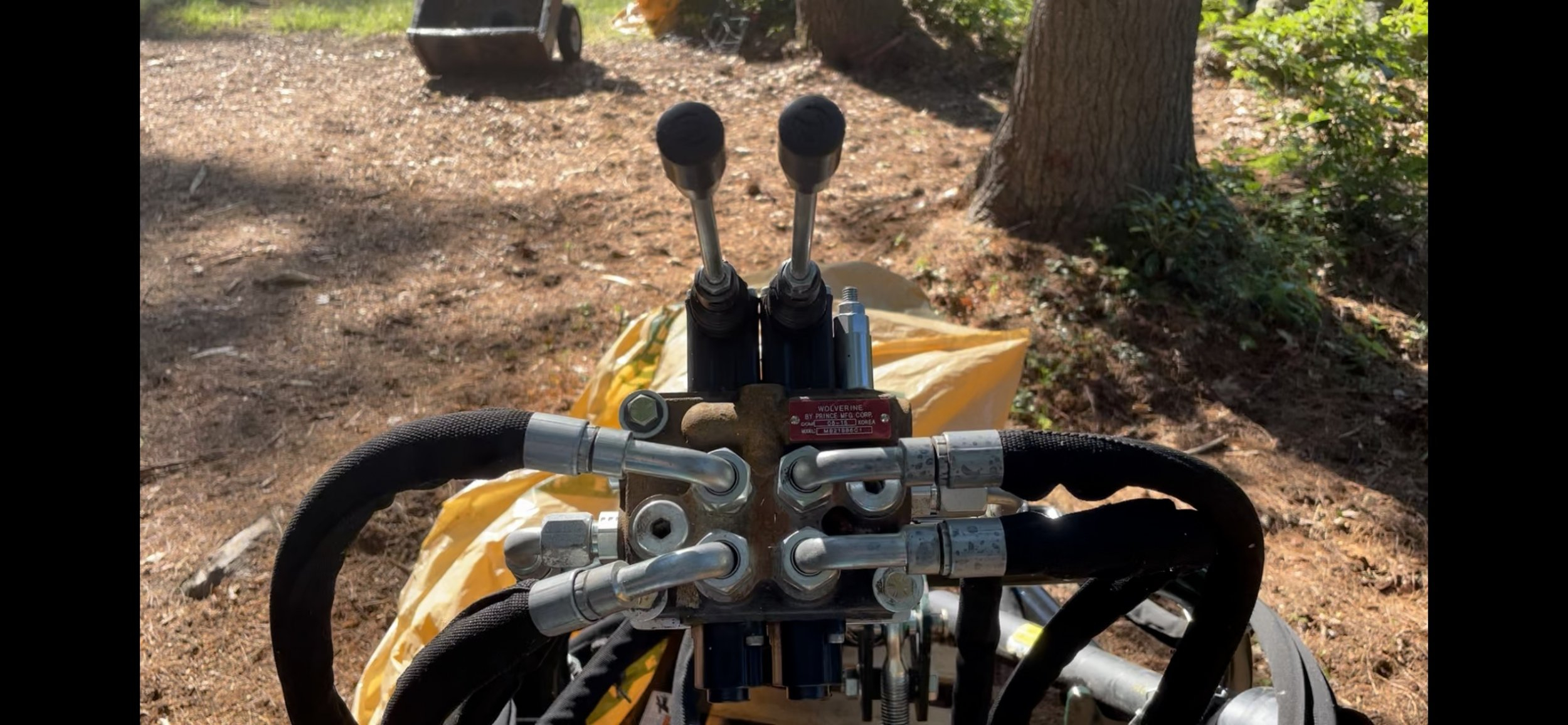

    • Hydraulic fluid runs from the tractor's rear remote valve, to a Prince monoblock, two spool directional control valve. This is also open center and the spools are spring return to center.

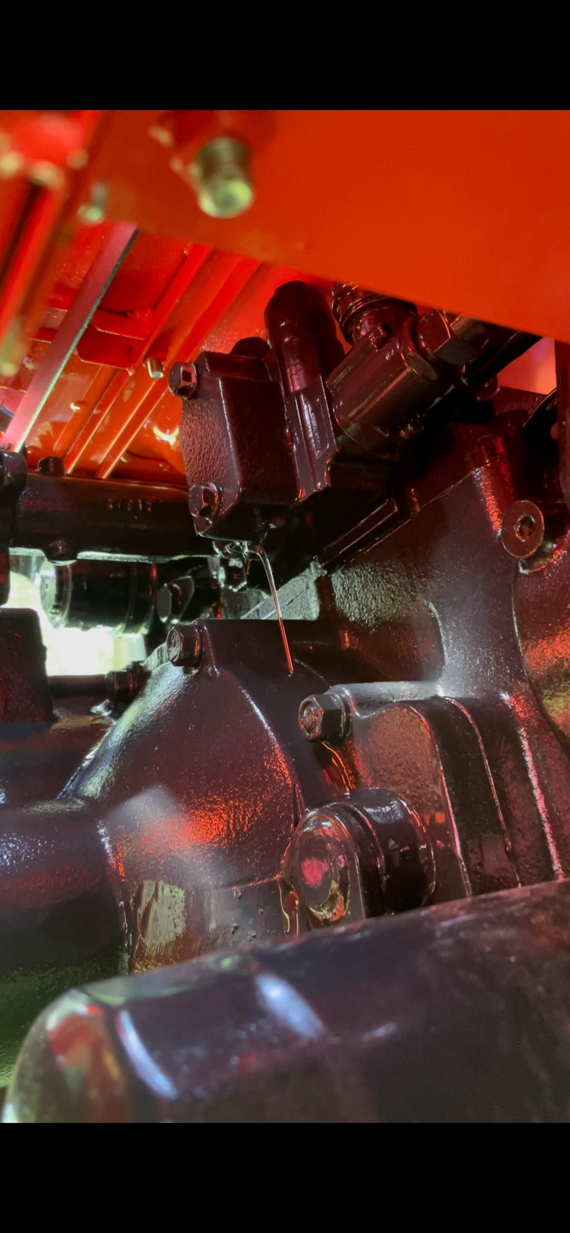

    • Eventually I'll go to lift the 3 point hitch, and one of the 3 or 4 orings that's sandwiched between the tractor's rear remote and this side cover plate will fail, and hydraulic fluid will come spraying forcefully straight backwards out the tractor from this flange.
    • Once this happens, if I take my hand off the 3 point hitch lift level, the spraying will stop, but a continuous stream of hydraulic fluid will start pouring from the flange as long as the tractor is running.

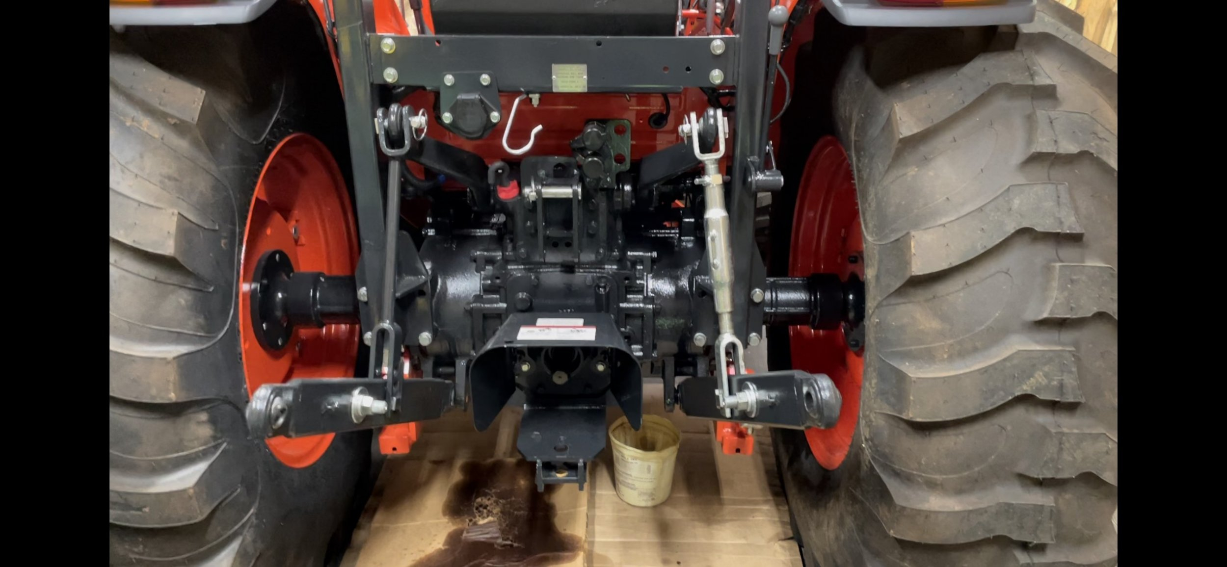

Tractor, you can see the single set of hydraulic quick connects, this is where I connect the stump grinder to.
Here's the stump grinder. You can see the two cylinders, two spool valve, and the inlet/outlet line I plug into the tractor.
Here's a close-up of the two spool valve on the stump grinder.
After oring failure, you can see the constant stream of hydraulic fluid. It's coming from this cast iron cover and the side of the tractor's rear remote valve.

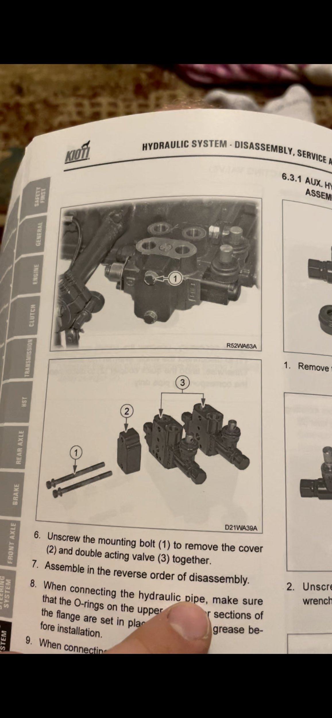

From the service manual, this is a better view of what the rear remote valve(s) and that cover look like. There are 3-4 orings in there.

If you look at the photo of the book diagram above, the rear remote valve is machined on both left and right sides, and is bolted (sandwiched) to the transmission case on the inboard side and with that cast iron cover on the outboard side. Each machined face looks like it has 4 orings, but it's the same oring that's blown out both times, and the fluid shot straight out the back each time. Intuition tells me there's something wrong with that one oring gland that the dealer is missing. Otherwise why that joint, why that oring, and assuming on spray pattern it's that one side of the gland that's bad? Until dealer confirms that they won't start replacing parts.
