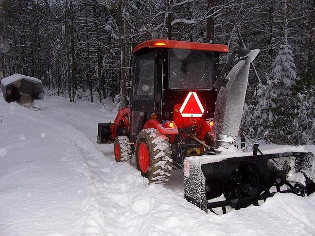

Using my 3ph mounted snowblower is fun as h#!!. With the heated cab, I sit in there with a sweatshirt on in below 0 temps and can do my 200' driveway plus big turn-around in less than 1-1/2 hrs. The snow gets thrown a good 30' or so and all my trees along the driveway have a white pile of snow of their sides about 20' off the ground. My blower is 60" wide, with the main auger for capturing snow and a propeller for throwing it out the chute. It cost $1800 brand new.
Snowblowing is only slow if you are going through a lot of very heavy wet snow (12"+) or banks of snow from the plow trucks. I run my CK20HST 21hp tractor at 540 pto rpms and hold the HST pedal almost to the floor in reverse. I think it is about 7 mph. I have a gravel driveway, so it's kind of tough but on pavement it would be easy.
A blade sounds better for your situation, but I love the look of a clean driveway with no banks of snow along the edges.
See attachment for picture.

Dmace-That's a beautiful picture!! If I lived in an area where there was a significant amount of snow I wouldn't hesitate to get a blower. In fact, I'd probably go out and get one today before even ordering my tractor!! I would, however, have to tell my dealer that I want to now get a tractor with a cab though. I'm sure he wouldn't mind!
