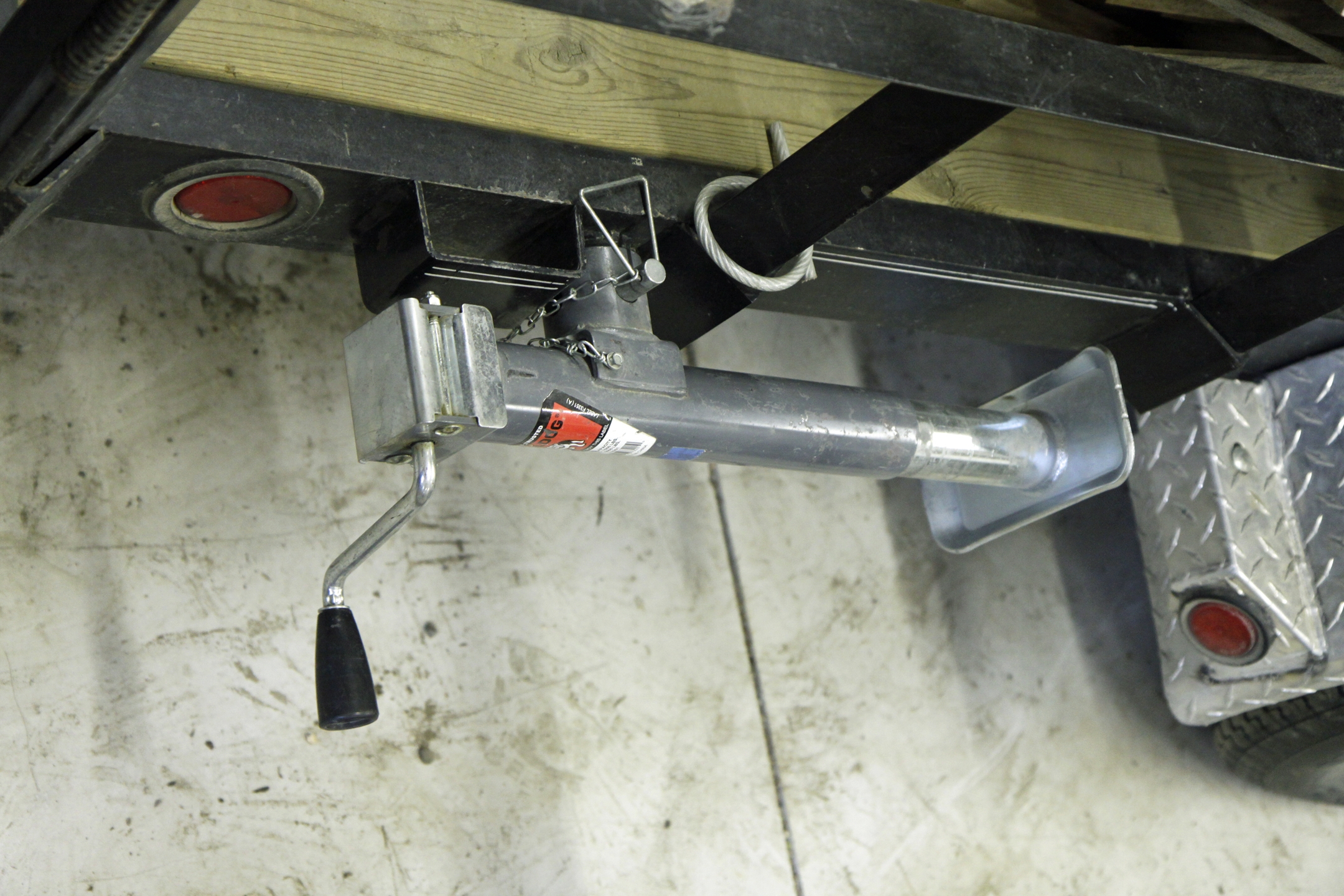

I have a 24 foot long trailer. Four 7 foot long hickory detachable ramps in the back. When I load my tractor it lifts the back end of my pick up off the ground. Have loaded it without blocks under the back of the trailer and with them. The better method and the best for the trailer and truck? thanks
   / Block rear of trailer or not? #2
Add 2 trailer tongue swing jacks. i did this years ago for my old ramp trailer. my new trailer is tilt bed.

My last trailer had a leg that was welded to the ramp that would allow the suspension to drop an inch or two before stopping the travel. Worked great and didn't require any extra steps on my part. It was a piece of 2x2 square tubing with a 3x3 flat plate on the end to keep it from sinking into the dirt.

If the ground you are unloading or loading on is unlevel, wouldn't the adjustable jacks grsthegreat suggests be better? Most locations we are working on is not flat.

Having jack legs on the rear like other have shown is great. But I don't have them so I always carry some wood block with me. just remember to keep them shorter than need so when loading and you get weight on trailer you can get them out.

I carry a pair of jackstands and just put them under the rear frame of my trailer. Like paystar says, gotta leave an inch or two gap so that they dont get stuck once you load anything heavy. Some permanent swing jacks would be nice, but I dont weld things myself.... yet...
   / Block rear of trailer or not? #9
my 20' trailer has jacks at that back that I always use. You can add them on to yours. Makes it so easy and SAFE.
