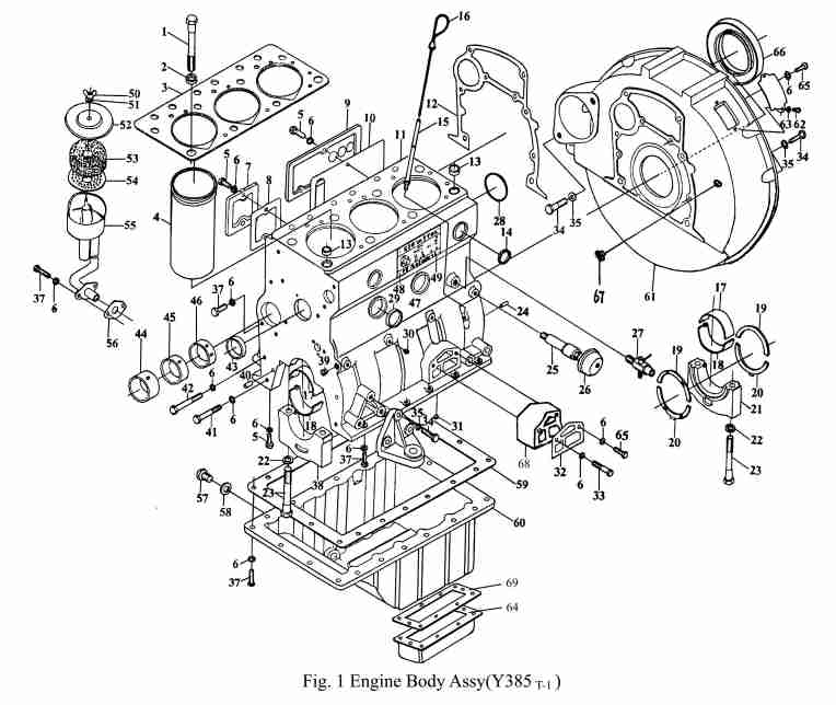

Re your freeze plug question, there are 11 in the diagram - an engine block used in many smaller Jinmas over the years. Although it's not the same engine that goes into FT404s, the diagram should be reasonably representative with regards to freeze plugs. They are item numbers 14 (x3), 29 (x2), 31 (x1), 43 (x2), 47 (x3). The reason there are 5 different numbers is that each has a different diameter. So you have to find a block heater the same diameter as the freeze plug it's going to replace. Oh, and you have to select a location that has sufficient clearance inside the block to actually accept the heater element - and still seal up the hole.

Guys i appreciate all of your input. I will probably go with the lower radiator heater to start with. 20 bucks and very minimal install effort, i need to probably drain/ change antifreeze anyway.
sorry if this was covered in past ,but i could not find anything about a foton 404. As i stated before i am newb when it comes to tractors. I just dont want to damage anything.
thank you for the freeze plug locale w/ schematics.
