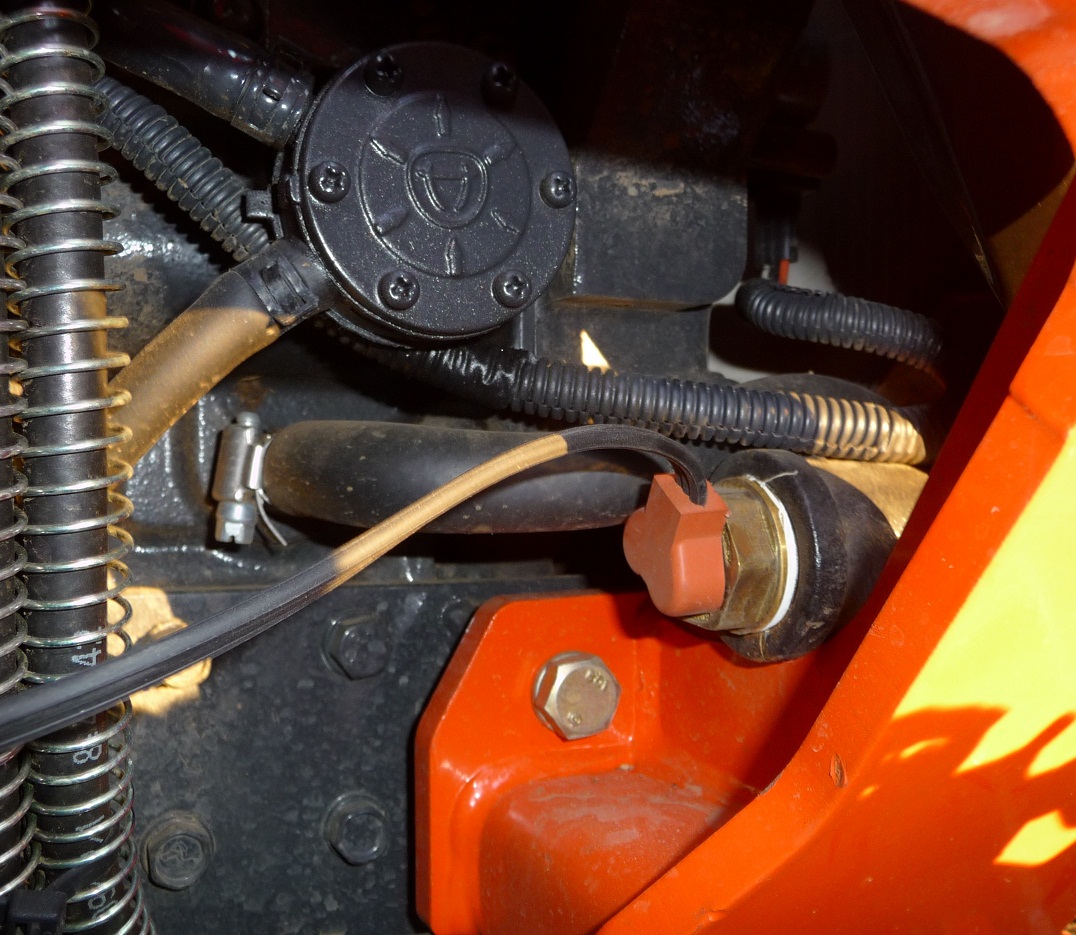

Daedong diesels are indirect injection diesels. In other words, preliminary fuel combustion takes place in the pre-combustion chamber in the head. The glow plugs fire directly in the pre-combustion chamber (800 degrees is 4 seconds). This is what helps the diesel combustion in cold temperatures. From our experience, a properly operating glow system will allow the tractors to start even in extreme teperatures. May take a couple glow cycles with the auto systems, but 99% of the time, the engine will start.
So..it's been our recommendation that if you want to assist the engine in cold weather, warm the oil. Since the glow system is there to heat up the pre-combustion chamber, warming the oil for circulation at cold start should be the focus on in-direct injection diesels. We have installed radiator and oil pan heaters when requested, we have not installed block heaters. Our hesitation with block heaters is the ability to "dry" the cylinder walls. By warming the block, the residual oil on the cyclinder walls warms and runs faster than it would cold. Block heaters may be the best solution for a direct injection diesel, it's been our position that it may not be for an in-direct injection diesel.
Just our approach.

Use a radiator hose heater. That's where your heat comes from.
Just a note. On the SE Cab Tractors, it is REALLY tight to get the lower hose heater in. There is hardly enough room since the cab heater hose is spliced in where the radiator hose heater would normally be installed. We've gotten them in, it's just really tight. Look at the left side of the engine compartment, you'll see what we are talking about.
/ Block heater #28
there is no way to install a lower radiator heater in my dk45 cab tractor. the hose is too short and has a 90 degree bend to boot.
/ Block heater #29
Mine came with the rad hose heater already installed. I will say, it does look tight, but my dealer puts them on every tractor they sell, so they must be getting pretty good at doing it.
That's the thing about experience- it makes impossible looking jobs feasible!
It is possible as MIE and you have both stated- but not an easy job....
I still prefer the block heater over the rad hose heater- just my own preference, others may have different views on this subject.
