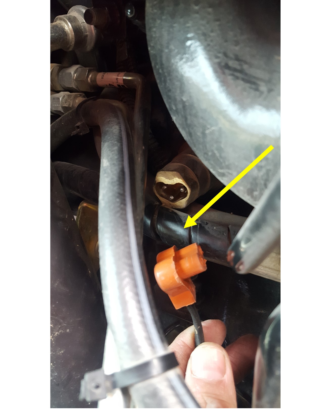

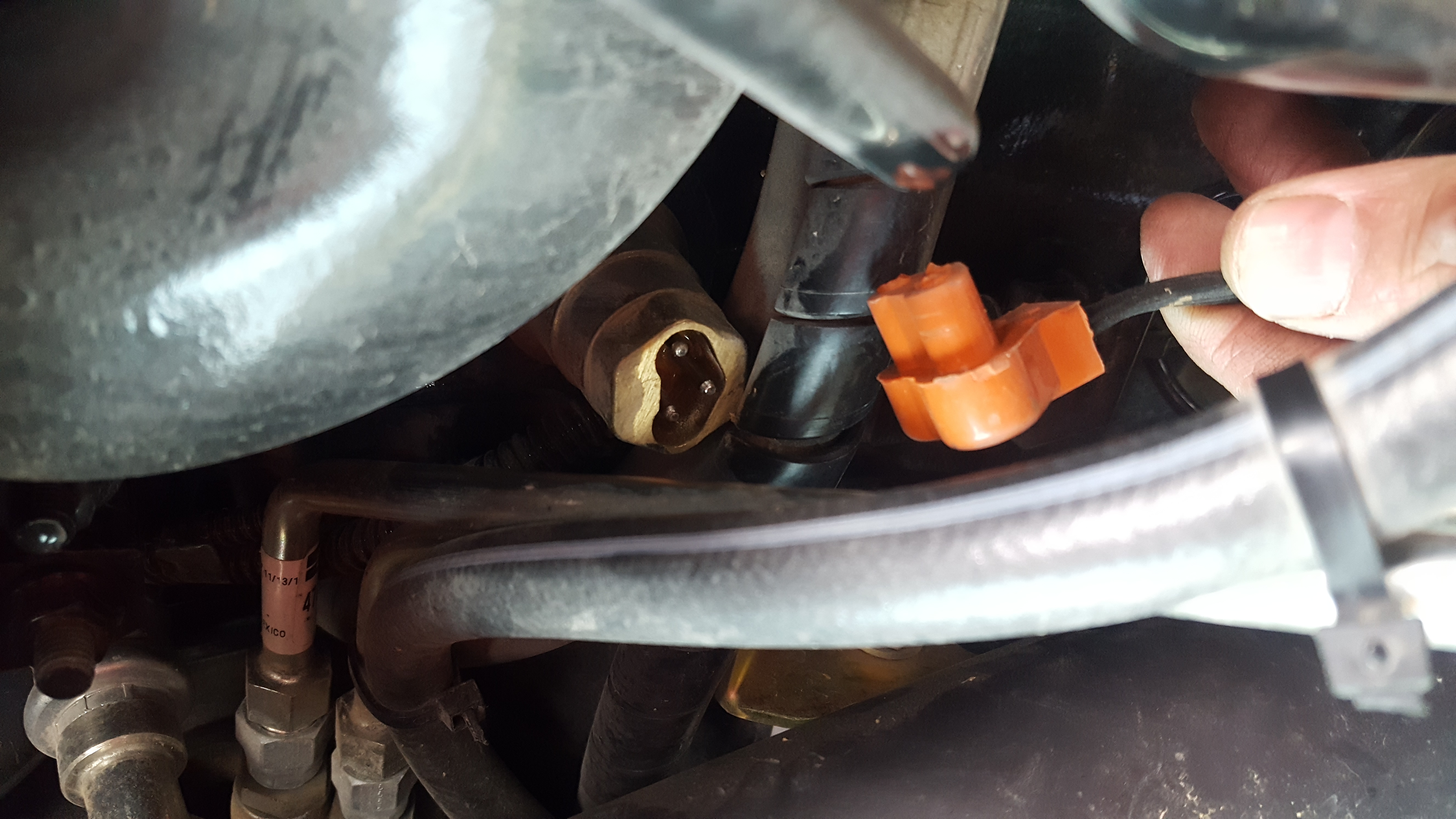

Finally found the plug in the side of the block for the cord to attach to. It was behind this hose which will not flex enough to get the plug in. Going to have to warm things up to see if I can get any more flex out of this hose to get it attached. I think engineers that design these things should be forced to work on them.

Thanks for the information on where to purchase zip ties. Now could you please explain what exactly your are referring to when you mention the zip tie? I want to make sure I cut the correct part of the hose. Are they expensive? Easy to replace?
In all seriousness it is not the hose with the zip tie. Its the hose that runs horizontal directly under the plug in the engine block. It was originally covering the connector. Part of the engine block prevents it from being pushed up. Its too tight (no extra play to pull out away from the plug). I was able to push it down just enough to expose the plug but the direction of the connector housing prevents it from being plugged in as the orange housing has a 90 degree turn straight down into the hose location. Going to have to have to remove the hose and replace with a longer one.

The "zip tie" is right be low your thumb in the picture on the hose below your hand. If you follow the hose to the left in your picture there another "zip tie" tying the hose to what looks like a steel line. I am not sure if this hose is the problem. I can't tell what hose you might mean behind/below it.

Problem hose is indicated by the arrow in the updated pic. It's a hydraulic line that is run so tight there is no play in it at all. Going to take a lot of work in order to get to this hose and replace with a longer one just to be able to plug into the block. I've tried pulling the line forward in order to slide the plug in behind the line but there is just no play to it at all.
