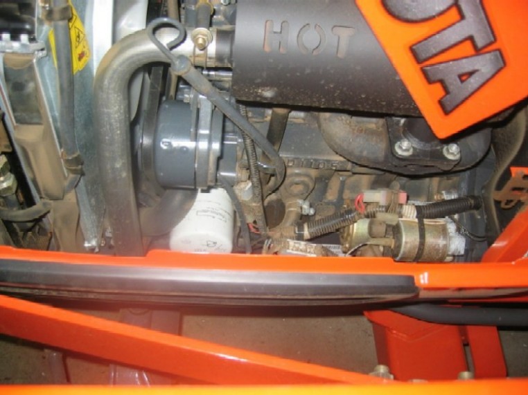

Got a block heater with my B7610 when I bought it the first week of June and forgot about it until I had to put on a sweatshirt the other day. I don't want to be fiddling with it in December so I guess I'll have to address it now.
In the attached photo you will see the heater on the workbench - what do I use the hose clamp and the little pellet for?? I was planning on threading the heater into a hole in the block near the starter motor. I'll also post a pic of what I think is a freeze plug - where I'm planning on putting the heater.

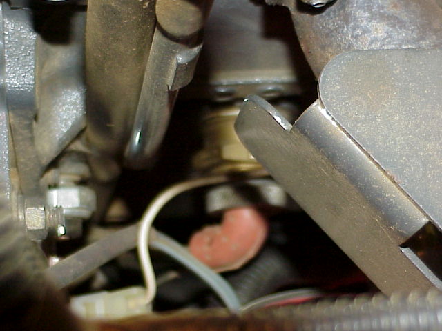

OK and here us where i am planning on threading in the heater element. Is a block heater that threads into the block better or worse than one that is cut into the radiator hose"
Is this a freeze plug and can I pull the freeze plug out with a 3/8" or 1/2" drive ratchet?? or should I buy the allen wrench, Any ideas what size allen??

An 'away' shot of the side of the motor, anybody know what the D1105 casted into the side is??

I have no idea what they are talking about in those instructions. Just purchase a 17 MM Alan socket to go on the end of your ratchet and remove the plug from the side of the engine. Install the heater in the threaded opening using some thread sealant material such as pipe dope. Don't use Teflon tape. Teflon tape is for use on old pipe threads to take up for worn threads. You are free to disagree with me, but I learned this from the people that originally came out with Teflon tape when I was in the truck equipment business. We used it on all old pipe and used pipe dope on all new piping. Take the heater with you to your local tool supplier and purchase the proper wrench or socket to tighten. Just make tight enough to be snug, you don't have to moose it into the block. If you over tighten a tapered pipe thread, you can crack the engine block. If you find that it leaks, then you can always give it an additional twist. The pipe dope will seal the threads so there should be no leaks. This is also another reason not to use Teflon tape. It doesn't give you any "feedback" of how tight it is and you can over tighten it. Refill the radiator and coolant overflow tank and take for a ride.

Here is a picture of mine installed in the block..... just like yours. The instructions packaged with your block heater are for a different unit.

D1105 is the model number of your engine.
