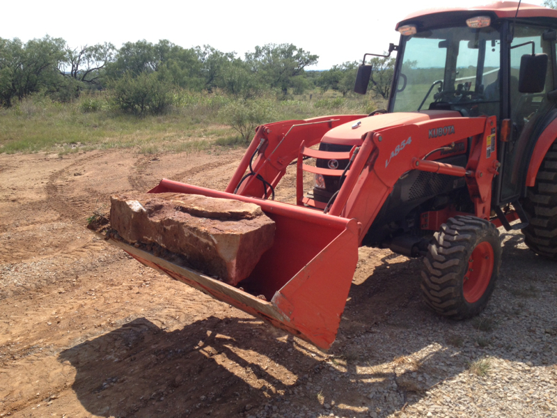

So I popped this rock out of the ground on a hill and when I started to back down the hill my right front tire dropped into the hole left by the rock.
Was a little off camber and the weight of the tractor tilted to the right side and I now see grease has squirted out the tiny hole n the zerk.
Do zerks fail, did I kill it?

Is the little check ball still there? If so push on it with the tip of a sharp object and see if it is still "springy". If so I would not worry about it. shoot some more grease in and go on.. But if you want to change it out change it out.:)
