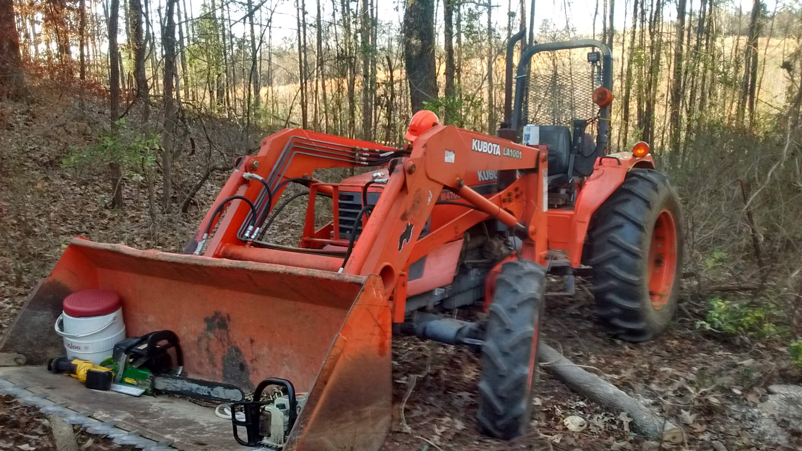

I am trying to understand how the T would matter. Both sides of the cylinder or cylinders, no matter how many in paralell are closed at the valve when in the neutral position. So if the circuit under pressure failed, the other side would go into suction and that "should" be substantial.
It seems that would be true but I'm wondering what caused the OP's loader to fall when the hose failed. He said it "dropped like a ton of bricks".
Edit: I'm wondering if its possible that the extreme vacuum, on the rod side of the cylinder when the hose failed, could shift the valve spool and cause the drop? There would be little if any pressure on the other side of the spool with the failed hose.

How could the load fall if there is a vacuum to supposedly hold it up? You guys surely have some thoughts on this.
   / Blew Hydraulic hose on FEL, instant drop. #28
A perfect vacuum is like -14.5 psi. Not nearly enough to hold the load.

Its only going to fall as fast as the hyd oil comes out the hose . It has to force the oil out ..
