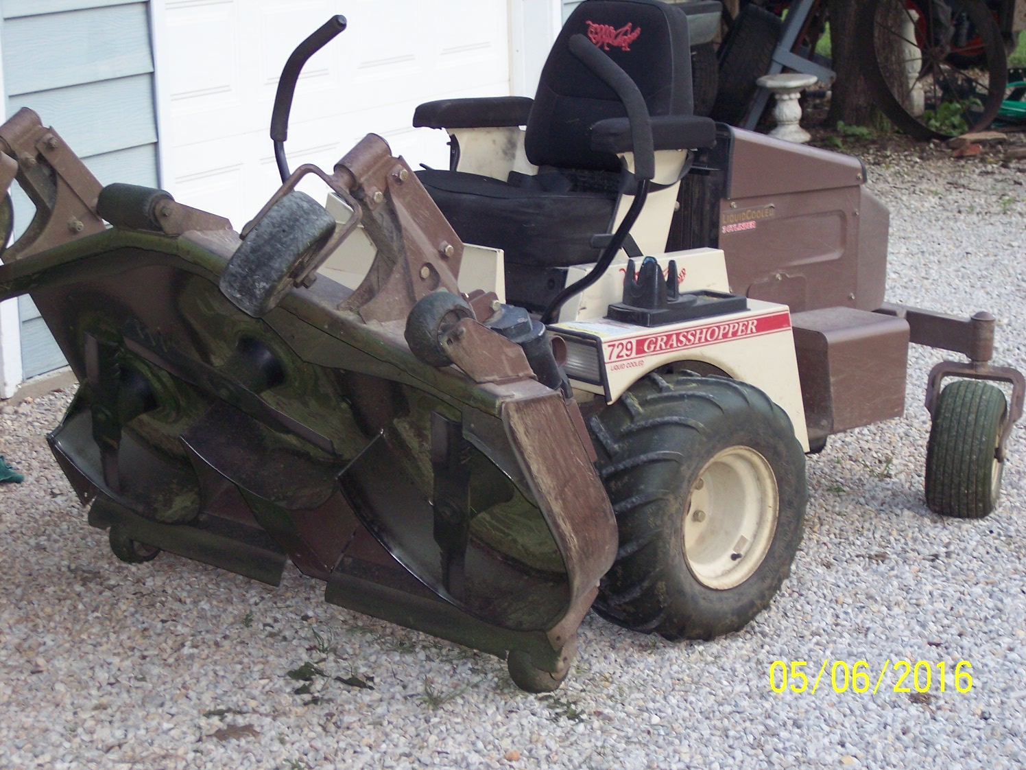

I use two sets of blades. At the end of the season I pull the deck then lift it up on its side with the FEL to clean it and swap out the blades. Then sharpen the blades some time over the winter.
Picking the deck up and moving it with the FEL is quick and easy with a couple of chains.
   / Blade sharping. #14
My drive-over deck allows me to take the deck off in minutes. Then, I lift it with the loader to hang it in the air while I scrape the deck and sharpen blades. This is a spring job for me, but since I started using Meg-Mow blades, I haven't had a need to sharpen. There are four blades, yes four, per spindle.

There is a price structure in the link. Looks like for a 52" mower the price would be $239 plus shipping. Personally I can do a lot of removing and sharpening for the price difference. 3 blades for my mower cost about $55 so I can buy 5 sets for the cost of one set of those. I cant see them staying any sharper for me since my biggest item to dull the blades are crawfish mounds and rocks. Even replacing the blades is not cheap at $8each x 4 per spindle + shipping $15 IIRC, so that would be $47 per spindle x 3 = 141 for each blade swap out. WAY too much for me and my tight wallet.
I bought 2 sets of blades with my mower 3 years ago. I just discarded one set last week and still use the other as a spare. Last fall I bought a new set and just put them on today. Generally I use my FEL to raise the mower up, take my impact gun, remove the dull blade and put the sharp one on. From start to finish including scraping out the underside of the mower deck is less than 15 minutes including the time it takes me to get my B26 out and positioned to raise the mower. I bolted on a piece of 3/8" chain to the front of the mower to hook my lift chain onto. It makes quick and safe attachment to the mower.

The blades are not your average blade. After 2 years of mowing with the blade, I have yet to need to sharpen, and they mulch where the standard blades do not. Unless I get behind and have to mow heavy deep wet grass, I do not have windrows that require raking. A higher blade tip speed would provide better results, but they do better than the average factory blades, and require minimal sharpening. I don't have time to spend removing blades to resharpen a few times per season. My time is money, so they work fine for me.

My BX2230 has a 54", 3 blade deck. When reinstalling the new blades, should they be positioned a certain way?

Nope, just put 'em on like the old ones came off.....i.e. with the bent (curved) tips up.

I remove my MMM each fall before annual service and installation of snow blade.
Tilt the deck onto it's back to remove and sharpen blades.
Remount MMM in the spring before mowing season.
