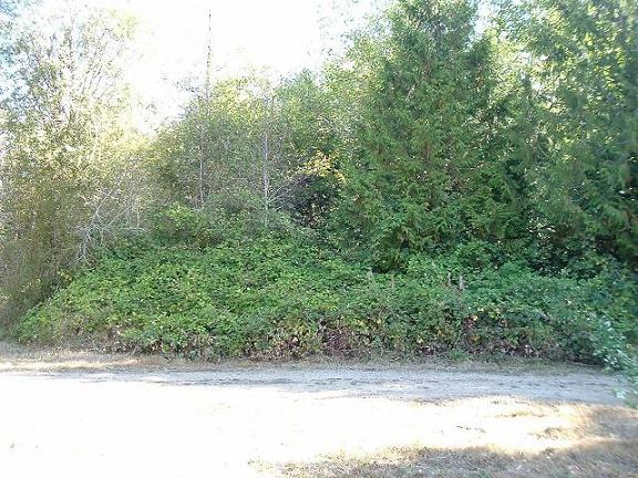

Here in the northwest we get 8 foot tall fields of solid blackberries. There is no good way to take care of it without a tractor, FEL, and brush hog. It is a very quick and gratifying job with the right equipment as shown in these pics. This method leaves no debris to dispose of, no chemicals to apply, and no fire to burn. Dare I say that it's environmentally friendly? Nah.
Step one: the problem. There might be a car in there. This particular patch is grown up into the trees where it chokes them and climbs even higher.

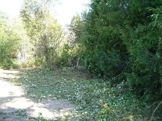

No chemicals, fire, or hand work. Total seat time was about an hour with about 1/2 gallon of diesel burned. Beats the heck out of a machete don't you think?

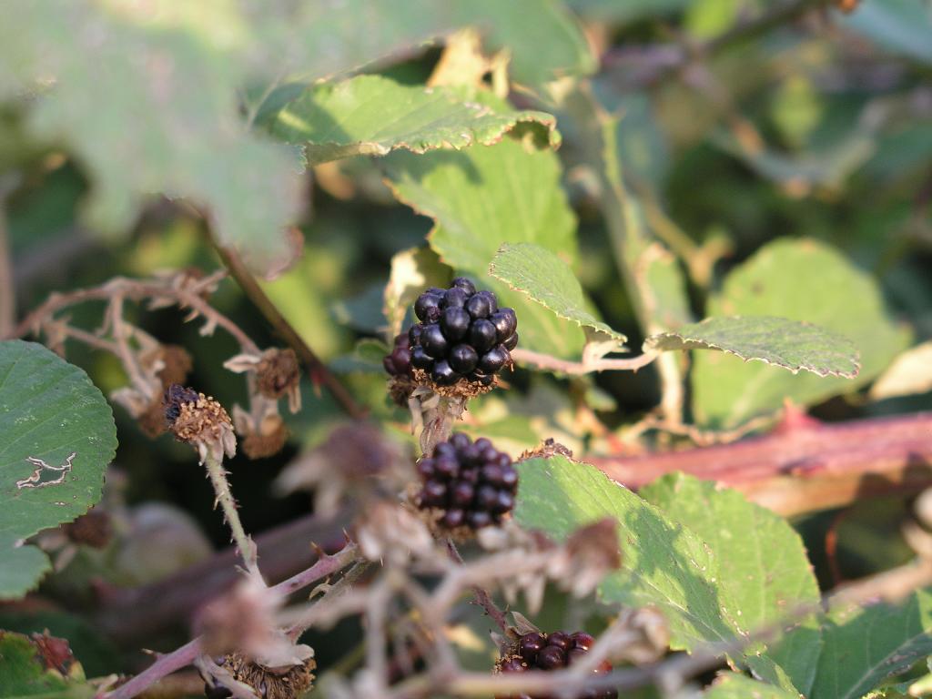

Do you know what did you missing???
Something very tastey and sweet /forums/images/graemlins/wink.gif
