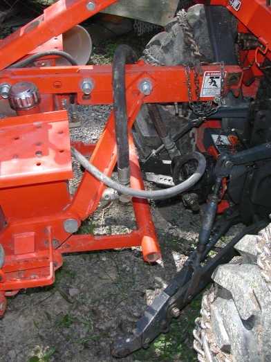

I recently purchased a BL4690B Backhoe and B7800HSD Tractor from my local dealer.
Reviewing the Kubota Operator's manual for the BL4690B, the dealer has set up the mast assembly as though the tractor is a B2910HSD with a 3-hole receiver at the top of the 3-point hitch (set-up is shown on page 30 of the BL4690B operator's manual).
The B7800 has a 2-hole receiver, similar to the B2710HSD set-up shown on page 29 of the operator's manual.
Should the dealer have set up the BL4690B mast for the B7800HSD similar to the B2710HSD, or similar to the B2910HSD?
Thanks in advance for your feedback!
   / BL4690B Backhoe Mast Set-Up for B7800HSD Tractor #2
I don't know the answer. I would have guessed that it should be set up the same as the B2910HSD that I have. The B7800 is often referred to as the B2910 without the extras...
Anyway, I will post a few pictures of how BL4690A mounts on my B2910. Make sure the dealer has inclueded the longer "subframe" brackets on the bottom sides of the tractor, and the heavy duty top link bracket.
Picture 1 is overview shot...

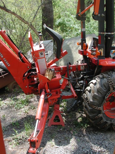

   / BL4690B Backhoe Mast Set-Up for B7800HSD Tractor #3
Top arm and HD top link bracket...

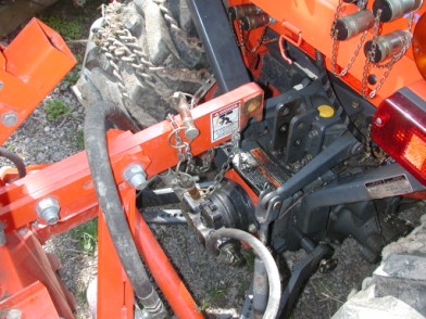

   / BL4690B Backhoe Mast Set-Up for B7800HSD Tractor #4
Hoe end of top arm/brackets as done by my dealer...

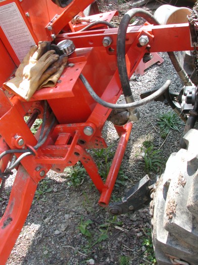

   / BL4690B Backhoe Mast Set-Up for B7800HSD Tractor #5
One more shot, taken before I hooked up one day...
Hope these pictures help in one way or the other. I am puzzled why the B2710 and B2910 would be considered different. I always thought that except for the engine size, they were identical... /forums/images/graemlins/confused.gif

Because the B7800 does not have the telescopic lower link ends. It should be setup like the B2710. My B2910 is set the same a Henro's is.
While we are talking about the Top Link. I will add a reminder to all about making sure your tractor has the Heavy Duty Top Link Bracket installed. See page 25 & 26 in BH manual. Here is a link to a thread on this subject. Click Here
