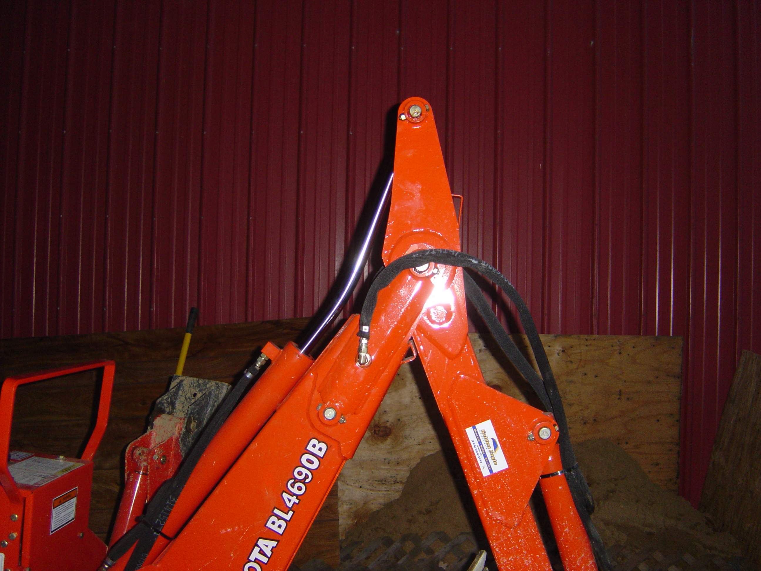

All 4 of the bends have been straight in-line and down as shown in initial post.
If you want to restrict the extend of your dipper cylinder, you can weld
on or add to the stop pad on your boom/dipper, instead of putting stop
collars inside your cylinder. Not all hoes have these pads, but the 4690A
has one (photo), and they are common on FEL booms. You can experiment
with bolted on steel plates until you get the stroke the way you want it.
I collect data on hoe attachments, and it is interesting how the different
designers approach the dipper digging force issue. The length of the
dipper moment arm varies widely for the 7.5' class of hoe, from a tiny
8.5" for the JD 448, to a huge 13.5" for the BushHog BH750. A longer
arm gives you higher dipper dig forces at the cost of having a longer
cylinder stroke.
I do not know the dipper moment arm length for the 4690....do you want
to measure it and post? It is the spacing of the upper cyl pivot to the dipper
pivot.

/ BL4690 Bent cylinders #28
pivot.
I forgot you posted a photo.
It looks like your arm is about 13", if your pins are 1". I would add to your
stop pads to limit the cyl stroke.

/ BL4690 Bent cylinders #30
I'd be willing to bet a beer that if you tee'd in a pressure guage at the base end of the Dipper/crowd cyl you'd have an overpressure condition in that cyl while digging/curling bucket cyl only while dipper/crowd was extended out and stationary ......
Of course this rod doesn't bend retracted in because the column strength is greater when collapsed and less when your hyd rod is extended......adding "Stop Tubes" only covers up the real problem......Too Much pressure on the base end of the cyl.....
This is called an induced load from external forces......(getting pushed in from leverage by the bucket curl cyl.......
The BH should have a larger (bore/rod) dipper/crowd cyl to carry this load or a WPR to relieve the overpressure........
I've seen this on small backhoes before.........I've done this test with other units with the same problem.....

/ BL4690 Bent cylinders #37
hawkeye08;2108684...it just plain looks like too much force being exerted on that link....[/QUOTE said:
Too much force, but only too much when the rod is fully extended. It
is not too much when the rod is not so far out of the cylinder. That is
an extremely long cylinder, and the rod is only maybe 1.125"?
/ BL4690 Bent cylinders #38
so,
Stronger rod,
Shorter stroke (limit stroke for that cylinder, either with cylinder stop or boom stop),
or less force.
Really seems like a design problem more than an operator problem. The video really showed it was not operator abuse (at least not the normal sense of abuse).
Edit: someone find the right part number of the stronger cylinder with the right fittings and make it a sticky.
Ok, if I bend the cylinder and it is not covered by warranty, why wouldn't just get one that is stronger? It sure seems that if I pay $300 for a new one, but a new stronger one is $400, then I buy the $400 and be done with it.
