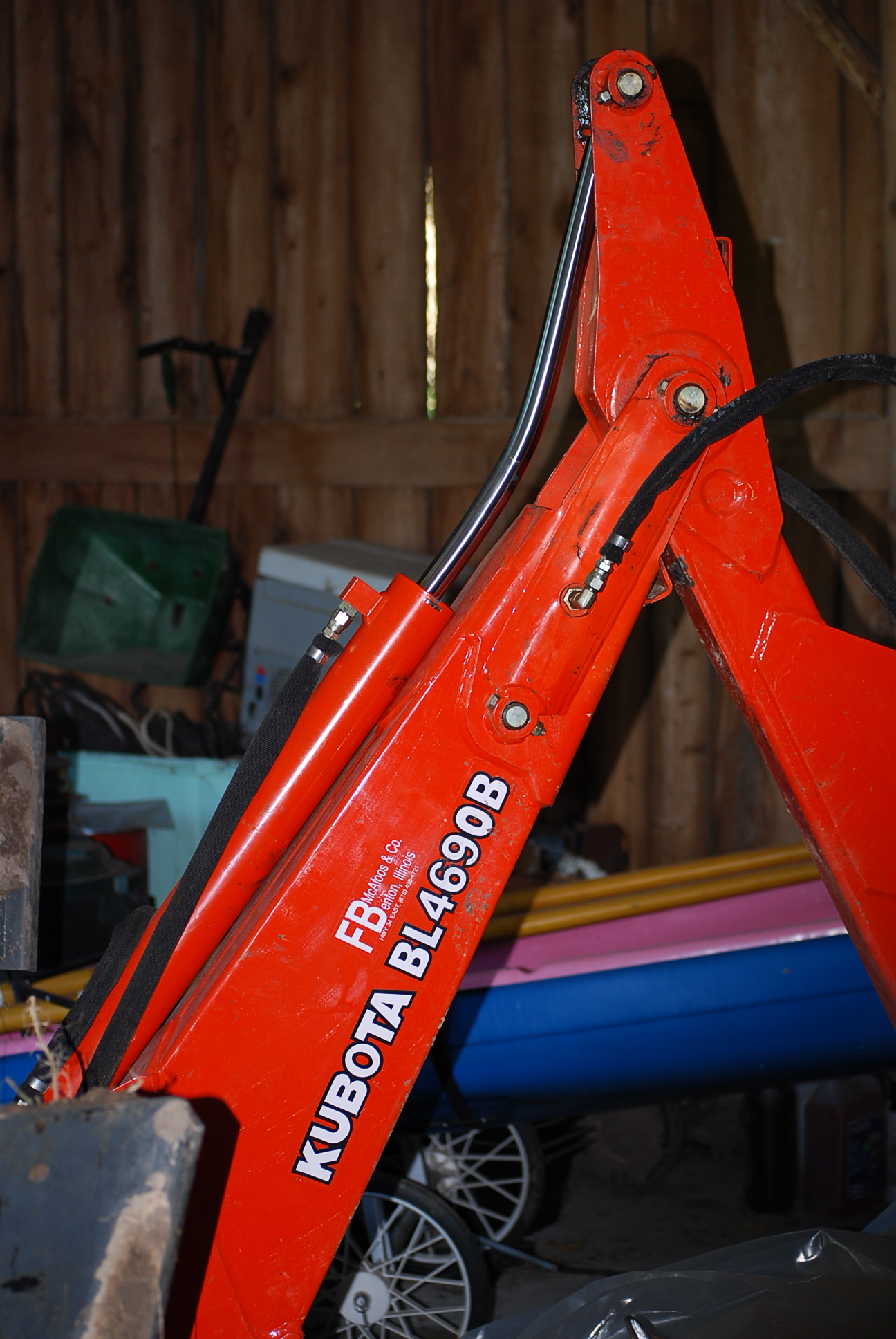

This is the second cylinder I have bent on this BH. First time I thought I did something wrong. This time I was finishing up a 200' trench and I heard a screach, cylinder shaft bent! What gives? I was just digging away doing nothing weird. I'm thinking of a stronger cylinder?

Has the hydraulic pressure for system been checked. I have watched that cylinder on my BH closely. Have never seen it flex yet.
/ BL4690 Bent cylinders #3
Last time I saw one bent like that the fellow was wondering what was holding the tractor back when he was pulling ahead and he didn't have the boom up high enough.
/ BL4690 Bent cylinders #5
Something pushed the rod back into the cylinder. I know you think you did nothing wrong, but rods don't just bend.

Question the OEM for a print of the boom design and measure the ratio of extension to retraction of main boom to the bucket stick. Your Photo suggest the mechanics of the ram piston ( rod ) is extending beyond the internal relief of the barrel. Have a hydraulic shop use a cylinder press to pull the damaged rod out of the barrel to confirm the evidence. I suspect the cylinder extension capacity is beyond the mechanical advantage of the boom stop weldment on the curling action of the bucket stick. If the original cylinder failed in this exact configuration the load inertia moment has shifted from the intended design of the manufacturer for mechanical advantage of breakout force considering the hydraulic circuit relief is correctly set. Go figure...200' into a ditch, everything expanded by heat of the working load and you are curling back to clean the bottom and this **** happens...
I was finishing the trench and reaching in close and down. This extends the dipper cylinder all the way. When I curl the bucket to take a scoop this puts pressure on the fully extended dipper cylinder and it bends. If it is not supposed to operate in this position then why can it be put in such a position? Or why not a warning not to operate close to the tractor?
/ BL4690 Bent cylinders #8
I bent two that same way digging up close ith dipper all the way out. After the second time i learned not to do that. Differnet model than your'es and not saying you will bend it all the time that way but you are closer to the limites of the cylinder when digging in that posistion is all i can figure. some say they never had problem digging up close and do not know why it does not happen to everyone? Its been two years now with no problems for me, long as i make sure i'm digging nothing tough up close and move the tractor away and keep from digging up close no problems. There may be more too it with you'res, just telling you my experiance which i've posted on the form many times. Just when i saw you'res , same place rod bent on mine. You're looked worse than mine and i think is bent the opposite of both mine.

I just called my Kubota dealer $393.00 for the "Cylinder Crowd BL469". That is better than my last rebuild price, pleasantly surprised with Zubota's price. Also this is the first time I've seen the term cylinder "crowd", any one familiar with that term? I'll try and keep from digging close and deep. Thanks.
/ BL4690 Bent cylinders #10
That's a good price for the whole cylinder. Keep the old one for parts. I would also price out the rod and seal kit separately.
Crowd cylinder is a common name for that particular one. I don't know how it got it's name, but I have heard many manufacturers refer to it as that.
/ BL4690 Bent cylinders #11
Well it is nice that I finally found others that can bend the BL4690 crowd cylinder. And now I know what to avoid. It seems that when things are digging well and you get to a critical point in a trench that is when you will bend that cylinder rod. I just bent my fourth cylinder yesterday, a 12" deep trench crossing a hard packed road. Crowing in while curling the bucket to clear the bottom of the trench.
I bent the first one while digging my first trench from my lake to the house for geothermal lines. That was in soft soil, Kubota said it must have been abuse, so I bought a new cylinder. They are fairly easy to replace, guess I now know what is behind their design. It did not take long to bend the new cylinder, about 15 feet from the house crossing a hard packed drive. Dealer took the hoe back for analysis, and finally said he replaced the valve assembly due to a sticky pressure relief valve.
All seemed to work well after that for a year of so, then out of the blue while digging a trench for a knee wall by the house I executed the now known maneuver for bending crowd cylinders. That was about 3 years ago, since then I have dug lots of different areas with out incident. Doing that
same crowd while curling. Seems that the key is the hard bottom where the bucket can cause the greater torque while curling and force the dipper arm back on the crowd cylinder.
New cylinder from Kubota Georgia plant goes for $373. My guess is they get cheaper the more they have to replace them.

Another good case to install a cylinder stop tube to reduce or eliminate damage to cylinders.
Did you have the bucket level or near vertical? that is critical as the circuits do not have
individual relief valves.
The "Crowd" term in excavating is actually the forward motion of a dipper bucket excavator
system but the damage is still the same.

I think that these hoes have a slight mis-alignment of the boom/dipper pivot
or the upper dipper cylinder pivot.
Is there a consistent direction that the rods bend, left or right? That's
a clue. If it always bends in line with the boom, then it is still a mystery.
Some hoes have significant clearance between the dipper and boom at
their shared pivot. Kubota shims this clearance with the B21 hoe. I don't
know what they do with the 4690. I have added shims for my hoes.

The issue is one of a bad cylinder more than anything where a stop tube would have prevented the amount of damage to a greater degree.
I am almost postive the the piston created a gouge/slash in the barrel when it was retracted due to the flexing of the rod damaging the packing gland and stuffing box of the cylinder and the piston became wedged when the dipper arm was extended and the cylinder barrel became egg shaped and no longer useable.
The ONLY way that dipper arm will continue to work properly is to install a shorter dipper arm cylinder with a stop tube that is sized properly for the desired stroke as the cylinder is tooo d*** long period which is WHY IT BENT!
The stroke will be maintained, the cylinder will be located closer to the pivot point, and a stop tube sized for the stroke will limit the fully extended length which will reduce any chance of damaging to near zero.
The little pyramid welded into the dipper arm is a way to cheat and gain more reach in the trench thats all its good for, and as there are no circuit reliefs its going to happen again............

The bucket was level, clearing the bottom of the 16" deep trench. Front of bucket hit a hard pack something while crowding, I was not at full crowd when the cylinder bent. All 4 of the bends have been straight in-line and down as shown in initial post. Finished digging the trench with the new cylinder, but I maintained the boom distance to prevent the close crowd.
Yes, I have no confidence in this backhoe, will be looking to replace it with a good WOODS hoe.
