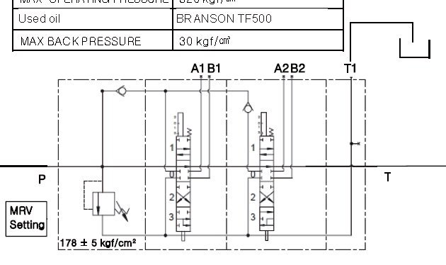

Hope I can ask this clearly. This is a new FEL on a new 2017 3725 on case that makes a difference.
Should I be able to both lift the bucket and curl at the same time? Or, lower and dump? I feel like I can only do one operation at a time - lift the curl.
Is that the way the valves are setup? Or, is it possibly still new and stiff?

I have the same unit with 40 hours on it. I've done a fair amount of loader work so far and it does do two functions at once but there is a very small sweet spot where this is possible. Basically only with both valves barely open if that makes sense. Higher RPM makes this sweet spot larger as well.

I'm wondering if Branson uses a valve too big for the GPM of these tractors. A bigger valve would decrease the sweet spot gap immensely. Or just a pump that doesn't produce enough GPM for these size cylinders.
I have no experience with Branson loaders, however I've built one for a Kubota B7000 with a couple of cylinders found in the scrapyard. The lift cylinder came from a truck cabin lift system which had a really restrictive orifices for the ports for safety reasons. This ended up working great with my setup as I could easily do two functions at the same time.
I'm thinking if you could use a flow control valve on the lift cylinders to reduce the oil going to the lift cylinders and force it to go to the dump cylinders. This, however, might reduce the lift speed of the loader but might increase that sweet spot gap.
