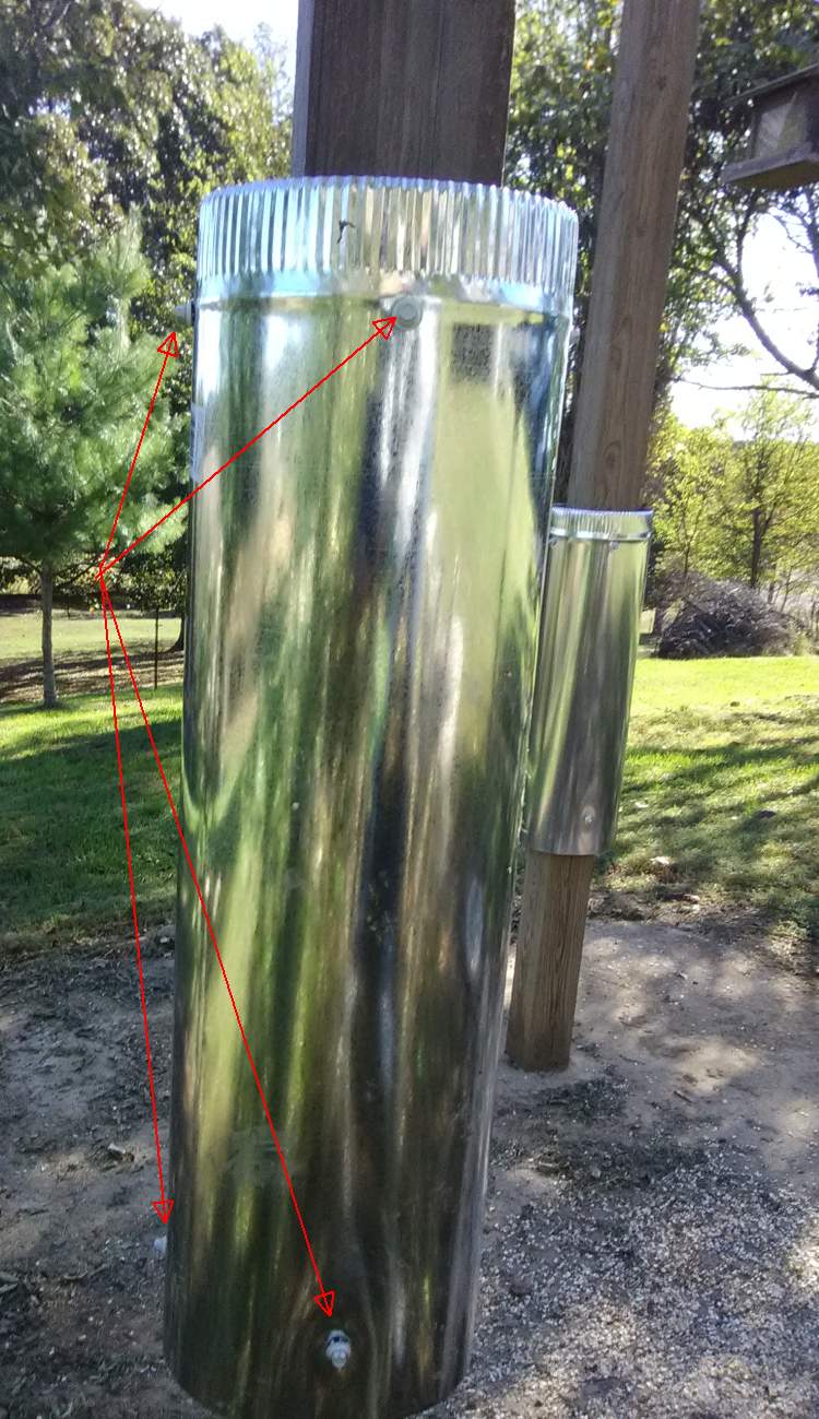

How long is the galvanized duct? Attach with screws? Do you flatten the duct to match the shape of the 4X4s or just leave it cylindrical?
Standard 24" length available at Big Box stores. Stock 7" diameter provides clearance around a 4x4. Used 3" roof metal screws on each of the four sides of the timbers (arrows). Added short pieces of 1/2" PVC pipe as standoffs/spacers for each screw. Theiving little acrobats found that they could stand on another's shoulders and get over the first 24" piece, so I had to add another piece above it.
I was afraid I'd have an issue with wasps or spiders nesting inside, but so far that hasn't happened.

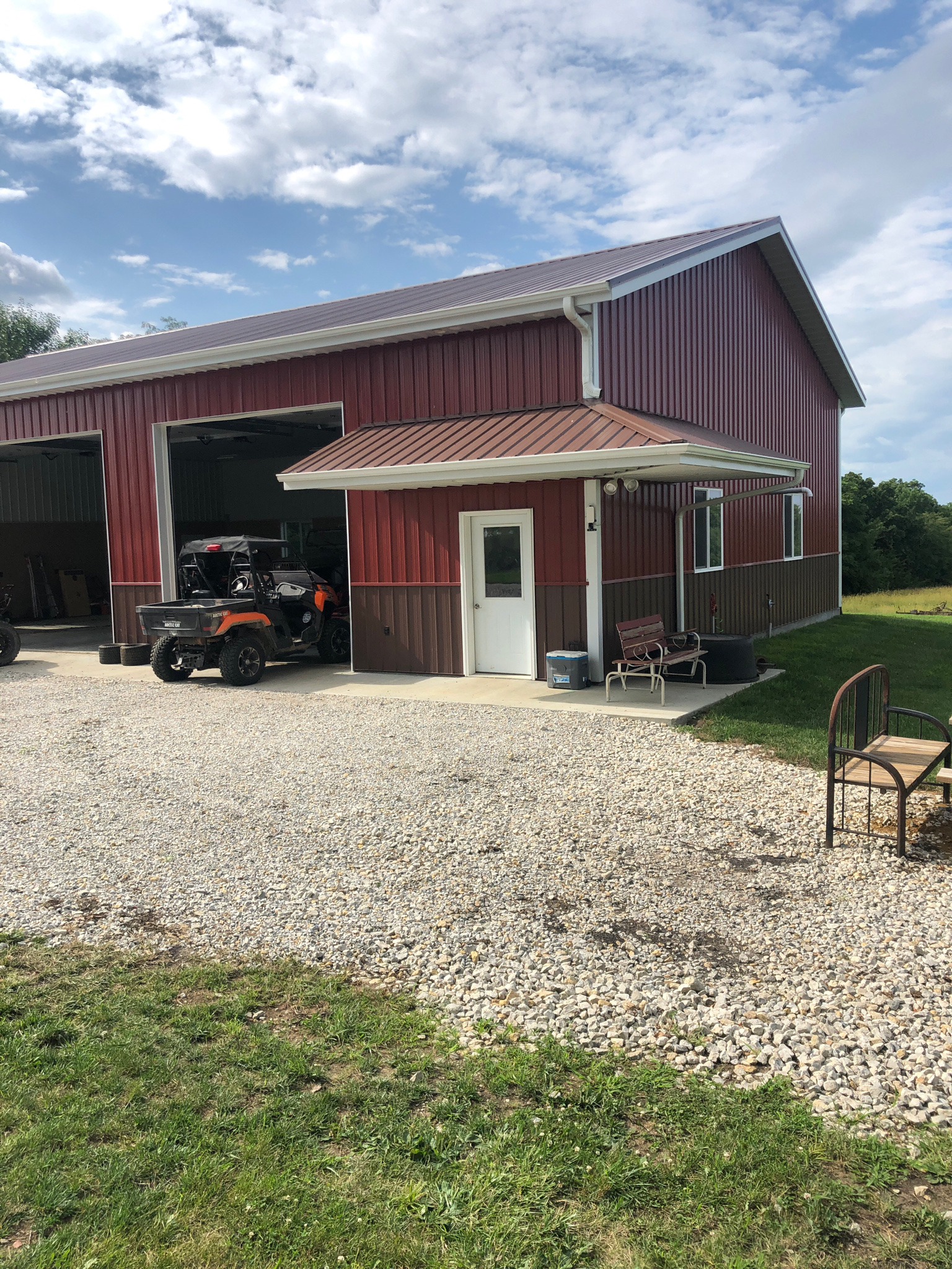

I like the look of how you finished off your shop. The metal seems to brighten up the space. What material did you use on the walls? I assume this is a metal building.
   / Bird feeder ideas
#25
40x60 shop. Builder wanted to do all tin, I just wanted OSB, he REFUSED to put OSB on, so we compromised and did plywood, then painted it.

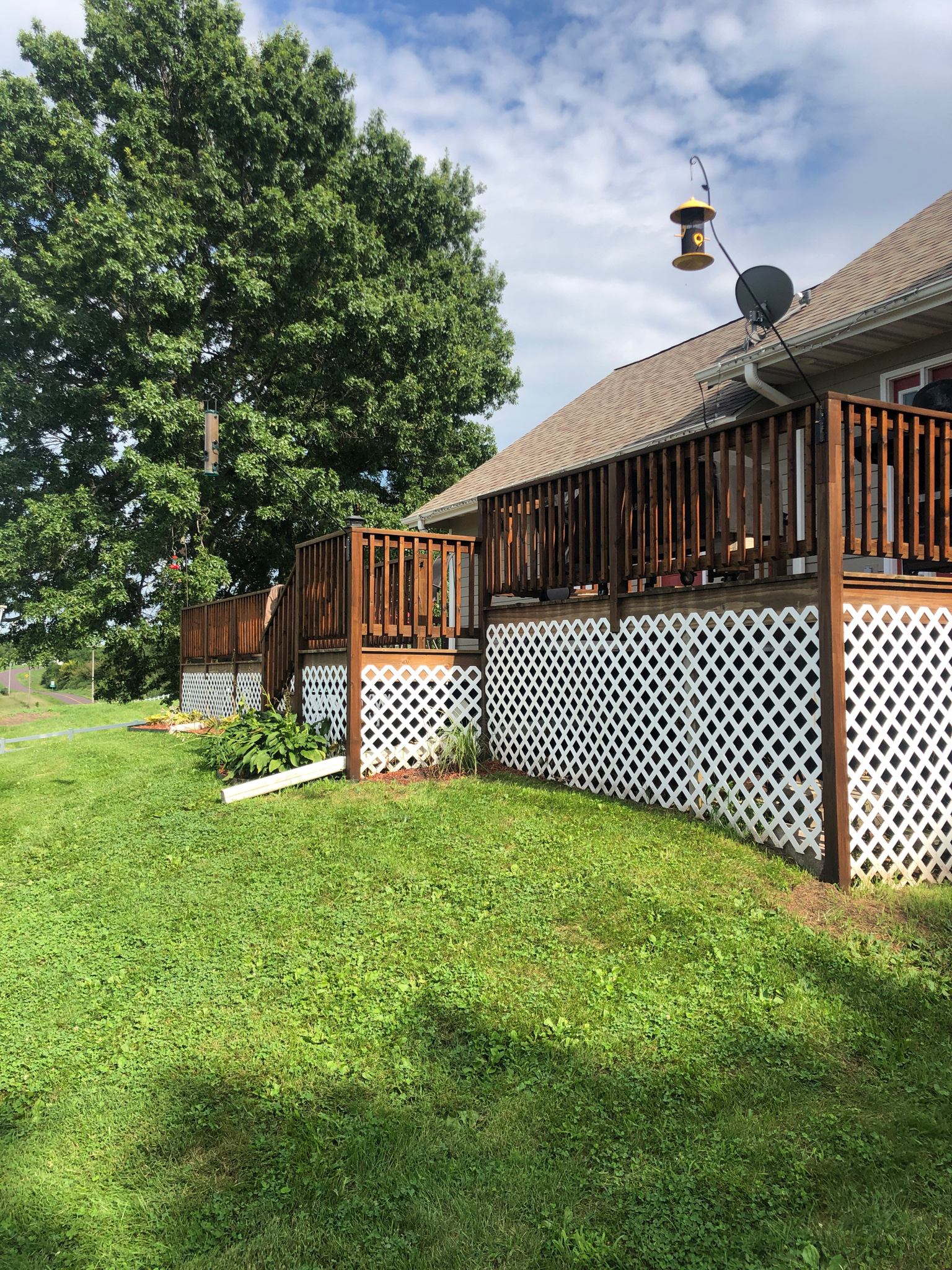

Got the feeders back up today!

Appreciate the picture and instructions. :thumbsup: Does "so I had to add another piece above it" mean the length is 48"? :confused3:
   / Bird feeder ideas #28
Yup. Probably just could have moved the one piece up higher so they couldn't reach over it, but it is what it is.
