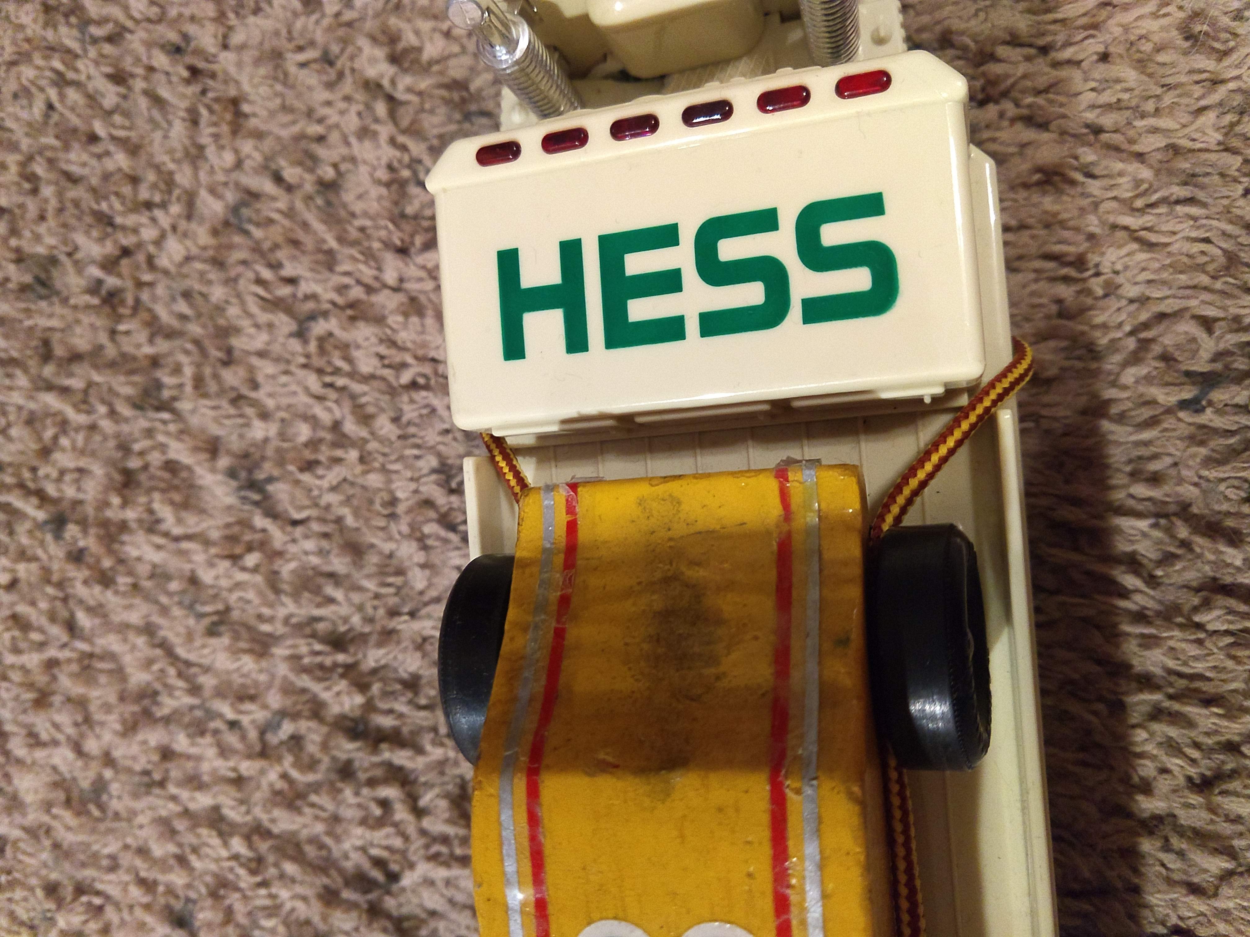

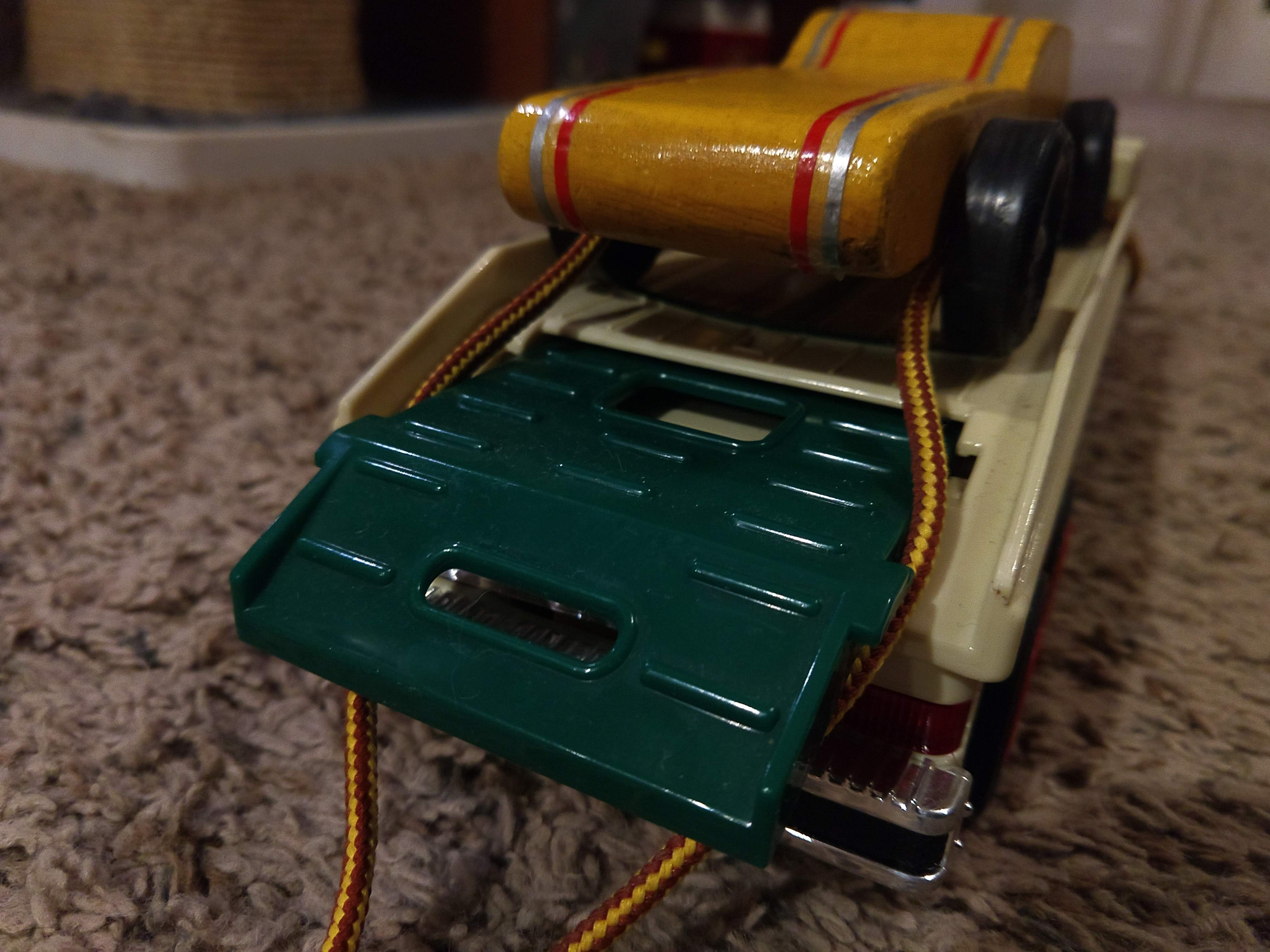

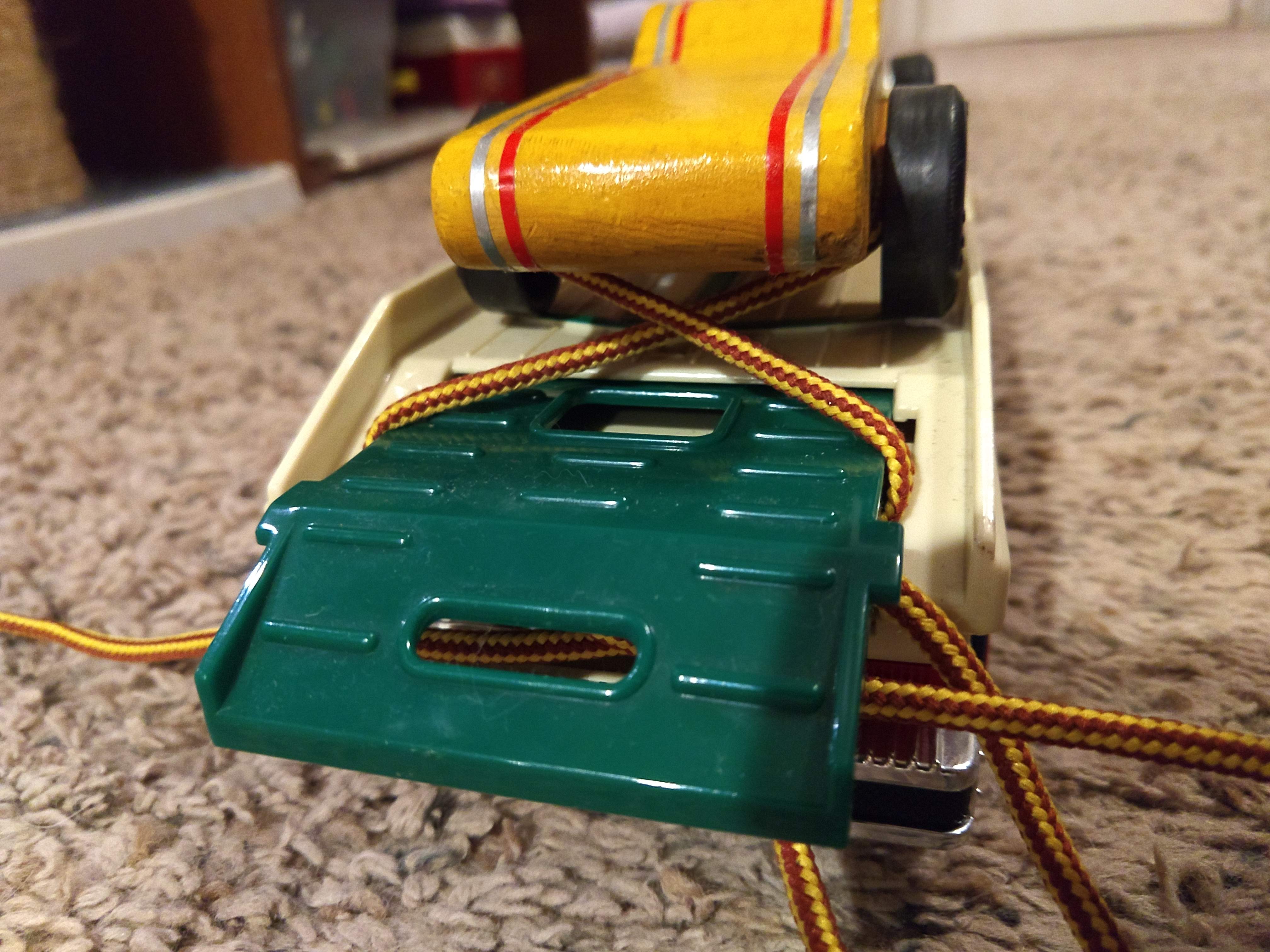

Here are a couple examples:
A tie down that is too flat and doesn't cross enough:
Very strong at preventing movement from front to back, weak at preventing moment up and down or side to side.
45 degrees up and down, left/right and front to back:
Roughly equally strong in all directions.
Cross tie:
This lets you overcome the lack of room to tie things down by tying down to the opposite side.
Aaron Z

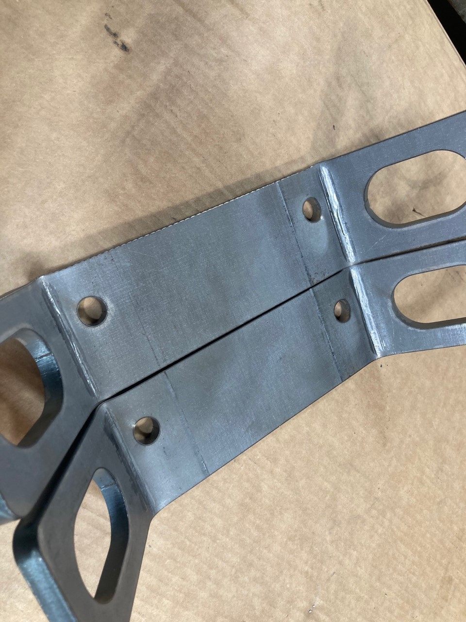

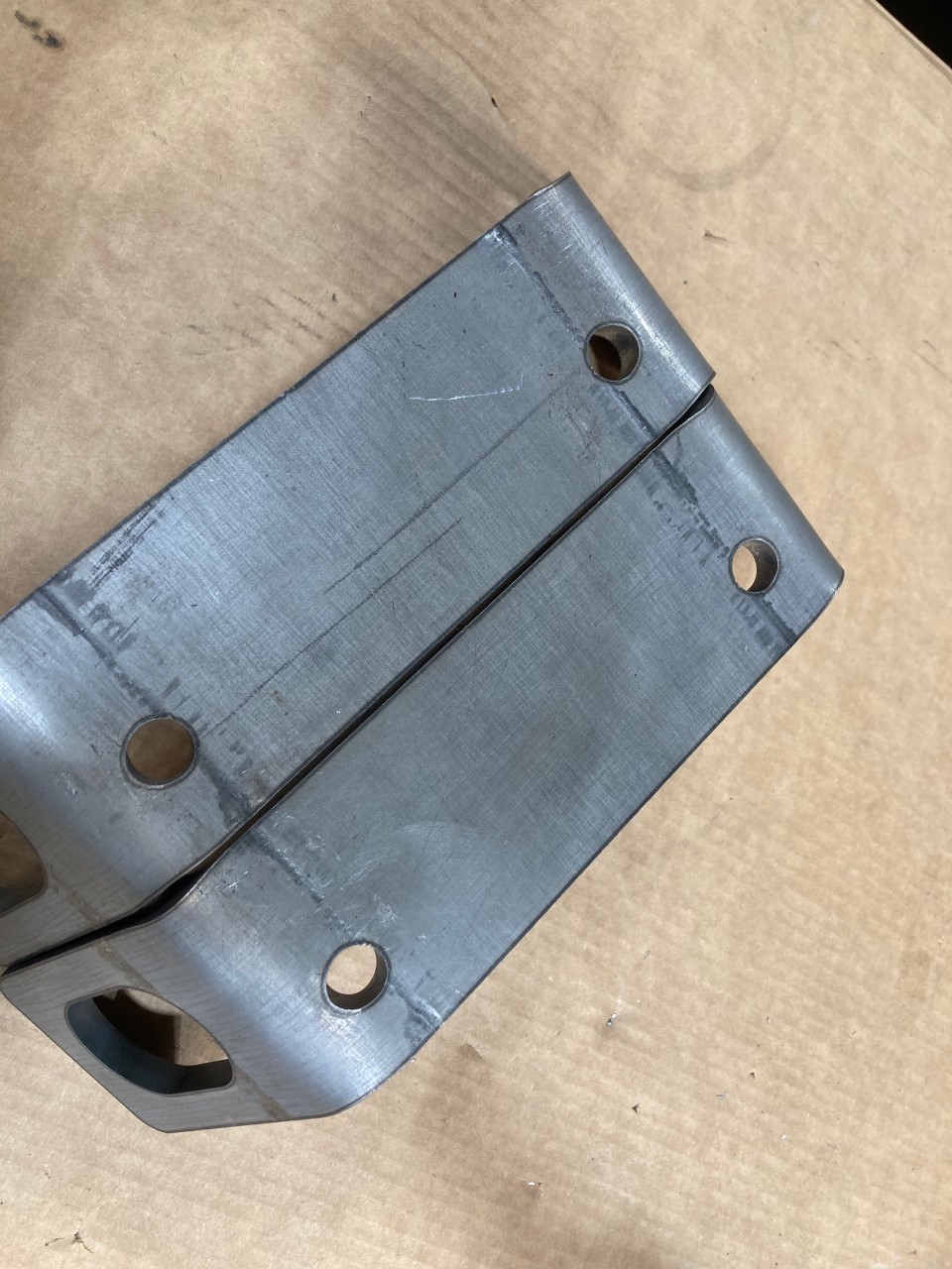

I also have worked in logistics, loading aircraft and other items while in the VANG. This design would be reliant on two grade hardened fasteners attached to the rear most housing of the tractor itself. I feel this design is reasonable to contain a tractor weighing under 7k (including implements in the 7k figure). If the rear housing cannot support the load via two fasteners then it痴 poorly casted or inferior materials were used to manufacture the item.
-Chris
/ Binding Tractor to Trailer #29
-Chris
Such a load will largely be a tensile load, if it's a 3/8" fine thread grade 5 bolt on each side, the breaking strength is 7450#, thus the WLL would be 2483# per bolt.
I wouldn't trust that for a 7000# tractor.
The hitch on a tractor will generally have at least 4 bolts around the PTO housing for vertical loads, then 4 more bolts into the underside of the axle housing to handle horizontal loads.
Aaron Z
Thing is the tractor doesn’t weigh 7k...closer to 4K without attachments. Would you trust it now?
-Chris
-Chris
No, I would tie into something stronger, you are still putting the bolts into tensile load and I have seen too many pictures of people who have had bolts tear out of castings.
Yes, grade 5 bolts are good for 2400# each, but are the castings going to hold that? I doubt that the castings are grade 5.
DOT rules for rolling stock under 10,000# are "The sum of the working load limits from all tiedowns must be at least 50% of the weight of the cargo." (Driver's Handbook on Cargo Securement - Chapter 9: Automobiles, Light Trucks, and Vans | FMCSA )
I like to have it so that I meet that with any 2 of the 4 tiedowns that I use to attach the tractor to the trailer.

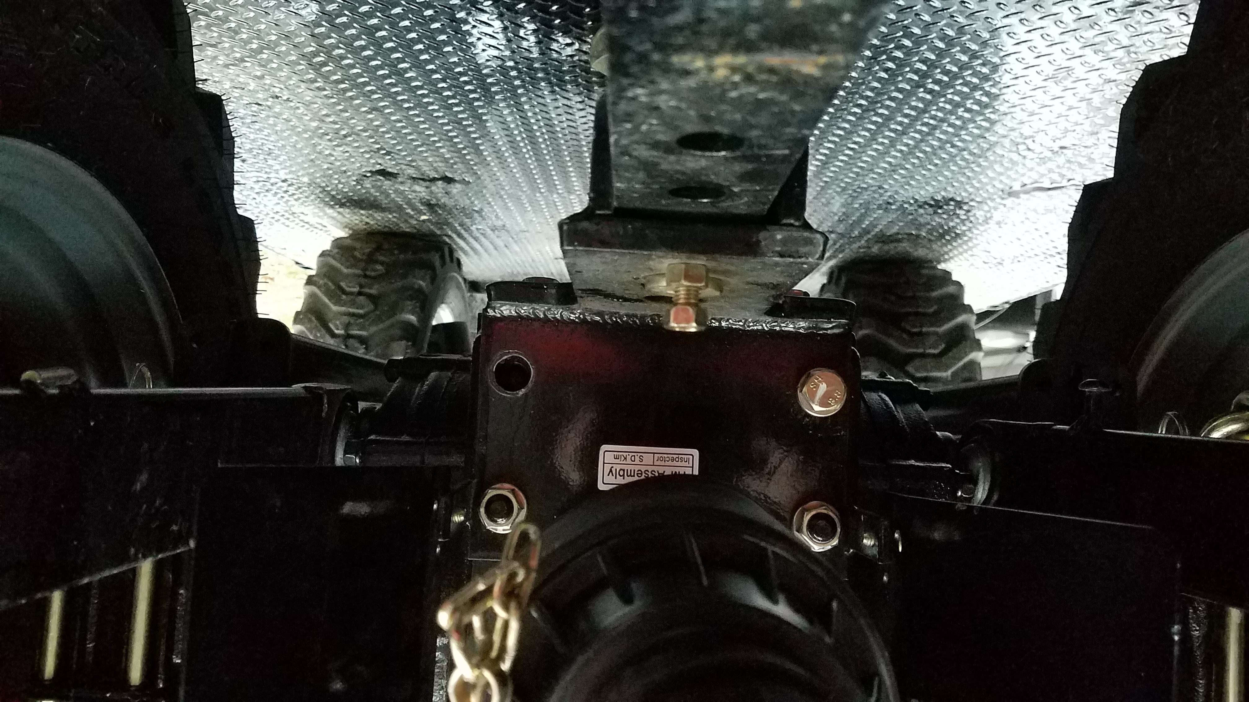

I will have to post a picture of what I use on the back of our L3830 which is similar in size.

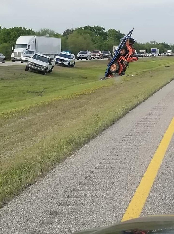

I go to lots of shows over here in England and sometimes I am appalled at some tractor owners turning up with their pride and joy hardly fixed to their trailer bed, I saw one last week and just had to tell the owner that if he was stopped by the police they would fine him for an "unsecured load" after explaining my experience on a motorway being pulled in to a testing station by VOSA who police the motorways lorry's etc. in England
Although I had 4 straps holding my tractor down the officer explained that if in the case the trailer came adrift that the load should stay fixed to the trailer and stated it should have 4 straps IE. one or each wheel and be positioned so no forward or reward movement should take place, the one I saw last week had only two one front and back and when I explained that if the trailer tipped over his tractor would just pivot on them and would come off, he thanked me for bringing it to his attention and I noticed when he left the show it had been strapped down with four straps plus his existing two.
As the DVLA officer explained "if it has four wheels all four must be fixed
I was trying to find out if there was any legal requirement over here in England but could not find anything definite, but I did come across this photo which proves what could happen

From the research I performed it appears the rear housing and two lower bolts are sufficient to withstand the forces being applied.
Thanks,
Chris
the bolts may be strong enough but is the threads and housing strong enough? I have seen many disappointed tractor owners who have broken their housings doing what they thought were bullet proof.
Personally I'd use the pin and drawbar.
