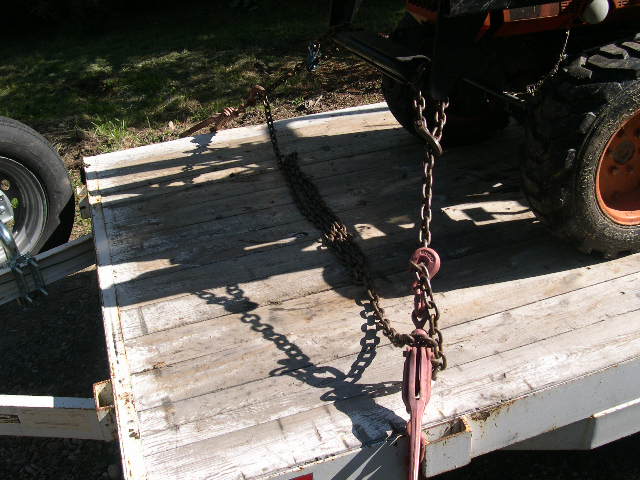

Previously posted pictures. The back of my tractor. I have a 16' trailer; even with my smaller 4' rotary mower, the tail wheel hangs over.
