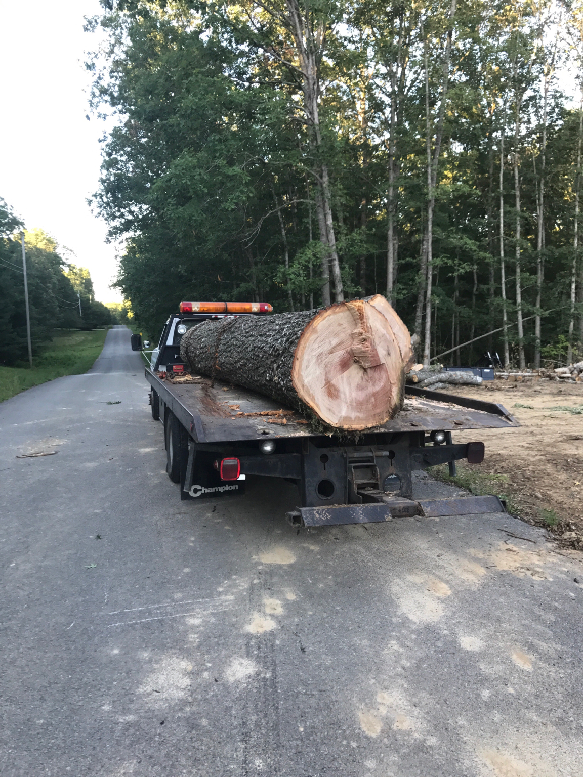

I dug up all my stumps and put them in the corner of the property (I have over 40 acres). For you I would recommend grinding over digging. No stumps to deal with afterwards and you can do it with a 35 to 45hp tractor. A CUT will go through the woods much easier than an industrial TLB. Add a logging winch and you'll be surprised just what one will accomplish. My Kubota will easily skid a 2' diameter 50' long red maple log.
What size winch do you have? That's a 8500 pound log according to log weight calculator ( which is generally on the high side). This log was between 7-8k and it was all my 15k winch wanted to get it out of the hole it made when it hit. IMG_0072.JPG
   / Biggest cheap tractor I can find for the money? #14
I've been borrowing my neighbors Farmi, I think it's rated for 11k lbs with my Kubota. I know it's more winch that I've needed but I've never had anything get planted. Usually I don't use a winch as I have enough trails on my property to get to almost everything. While I do have some maples that are up to 4' in diameter most everything is 2' or less.
