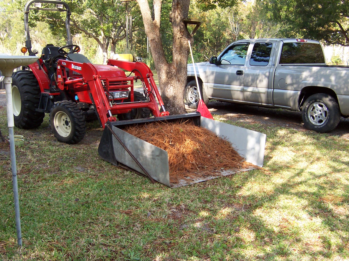

I have a 4720 with a BL20a loader. I am wondering if there is a bigger bucket available or any other options? I would like to be able to move lighter material a little faster.
Thanks Bob

Turkey litter buckets might be what you are looking for; high, deep and WIDE (if you can get them through your gates).
Try a search for those.
Easier, simpler, cheaper to find if you have a skid steer compatible loader.

That is what I am looking for. I don't have the skidsteer compatible QA at this time. It may just be easier to fab up a match for my style quick attach.

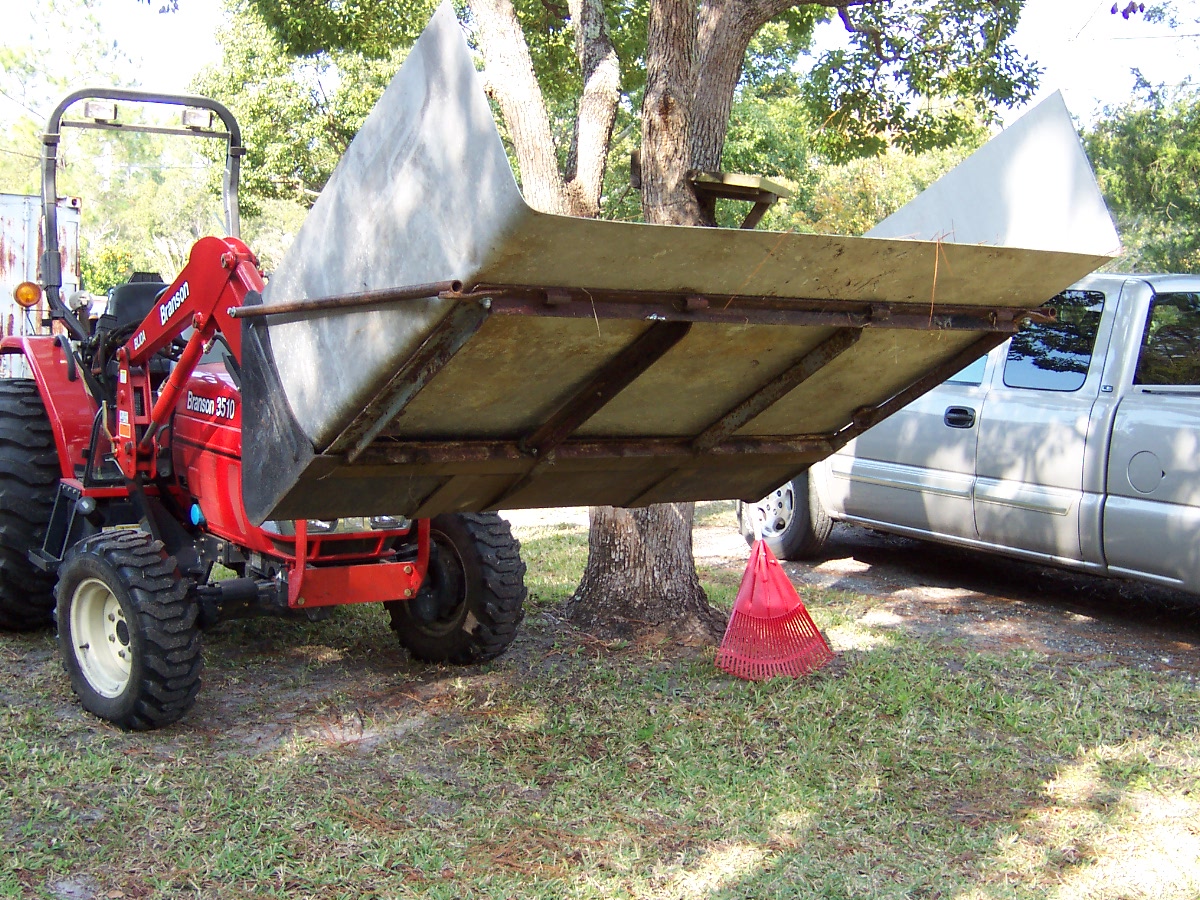

Here is what I did to the bucket on my 3510. It works great for pine needles, leaves and branches when I am doing yard clean up.
I can install or remove with two bolts and a ratchet strap.

Is that sheet metal or something heavier?
/ Bigger loader Bucket? #7
It's a 4' X 8' sheet of about 1/8" aluminum. A friend of mine gave me the sheet when I told him what I wanted to build. I bent it using the edge of the bucket on concrete and prying it up to 90* on each side.
/ Bigger loader Bucket? #8
Thanks, that would be great for spreading mulch, etc.
