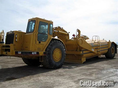

One of these would work for you. But, they are over $500K. :eek: :eek:
I'll take two of those!
