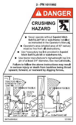

I've two Kubota tractors, a B7610 (23hp) and an M4700 (50hp) bought in 2013.
I bought a Woods BH70-X in 2009 for the B7610. When I inquired about putting the backhoe on the M4700 Woods technical support said they did not make a frame for it but it was perfectly OK to mount it with a 3 point kit they sell:
470352d1464654756-big-tractor-little-backhoe-woods-bh-3point-jpg
