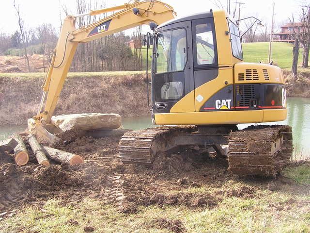

CHARLZ, good points on the support. I may try and move it again if the ground freezes. Right now its rainy and just too soft and muddy.
Do you think some concrete piers would work? I could auger 9 inch holes into original ground and then place Quik-Tubes or Sono tubes and pour concrete. I may even be able to get an extension for the auger and go another 18 inches. About 4 feet in the ground with the rest of the pier above the existing grade. Then fill with dirt above the piers(to protect the piers while resetting rock) and try to get it set back into place.

Pat32rf, yes the pond will freeze some winters. Thanks for the heads up on the 8" tubes. What about pouring 8 or 10-8" tubes and then placing some sheet steel (4'x8')on top of the piers with the rock sitting on the steel sheet? Just a thought. Do you have any other ideas as far as getting it to stay where I reset it?

I'm wondering about the practicality of using tubes. Your flat rock sunk in the groud from it's weight. With all that surface area, it sank. This really boggles my brain, and I'm not getting how a sonotube is going to do anything. I don't understand what you'd do with a sonotube?
They are for bringing concrete above grade. If you drill some post holes and fill them with concrete, then what will this accomplish? The flat rock sank in the ground with all it's surface area. What will a few sonotubes do? Where will you put them?
OK, the rock sank. The rock is flat and it sank..... The rock has allot of surface area and it sank....... I think you need more surface area.
You have the trackhoe. Why not dig a trench perpendicular to the rock. Make the trench go under the rock and extend it out into the field on either sides. I'd got two feet deep. Then I'd dig another trench just like the first one, but four or six feet away from the first. And to finish it off, dig three more trenches connecting the ends and middle to creat an sqare looking 8.
Put in plenty of rebar and tie it all together. Pour concrete to within four inches of grade. Let it dry for a week or two, then push the rock on top of it. Cover the rest of the concrete with dirt and smooth it out.
The bigger you make the 8 shaped footing, the more weight it will hold. The more surface area, the more strength.

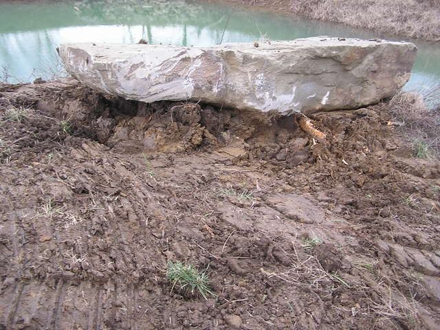

Yeah, concrete 'tubes' would just get driven into the ground unless they go down to something solid, like bedrock. If you think about it all you are doing is taking the wieght on the top of the tube and moving it to the bottom. If it is the same type of soil/dirt it won't help any. The 'mushroom' mentioned above might help.... but then I am not an Engineer so take all of this with a bag of salt ;)
With the abutment I was thinking more of trying to keep the rock from eventually tipping and sliding into the water. The dirt under the overhang has a place to go.. down and out. Couple this with erosion from rain water, melting snow etc. and I don't think it would take all that long based on what the soil looks like in the pictures.
As Eddie noted if keeping the whole thing from sinking is a concern you probably need to take that weight and spread it out over a larger area. Really depends on your soil, it may settle some and thats it. But I think it would always be prone to sliding down into the water without something to keep the dirt under it.

Eddie, I understand what you are saying about the figure 8 footing, but I'm not sure that there will be enough area out on the peninsula for it. I'll keep that in mimd as an option though. Also have to figure the cost of the concrete. If I want to spend that much. Maybe curly dave is right. No economical way of doing it.
I was going to auger the holes and then pour the piers to the grade I needed the bottom of the rock to be. Which is slightly above the existing dirt grade. The dirt gets lower the more I mess with the rock.Then fill and compact the dirt to just above the top of the poured tubes. I thought the multiple tubes would give more bearing strength to what the rock was setting on. Maybe I just need to forget it though.
I don't know that the rock really settled or the ground towards the front eroded away and caused it to settle.
What does anyone think about digging a footer 3 foot deep and then compacting crusher run stone in the footer ditch. Would that give it more support than just dirt?

How about, after the rock is out of the way, use the hoe to dig entire area down to natural then fill hole with rock, compacting as filled and lining the slope on pond side with rip-rap to reduce smaller rocks from eroding or sliding. Then slide rock back into place. This way you have an entire footing under the rock and should be much less costly than concrete.You could use timbers or steel runners to assist in the slide.

This rock is just like a giant teeter-totter. You can either lift the overhanging side up and try to brace it, or you can dig down behind the other side and push it down to become level.
I think it would be 100 times easier to dig underneath the "earth" side of the rock to bring it level. If you dig down you may have to pull the rock back to make it level.
Either way, it looks like that bank may be susceptible to erosion and eventually it would be come unlevel again unless you remove the rock and build up the foundation.
I think in this case it is 6 in one hand, half dozen in the other and leaving it the way it is looks better and better the more I think about ;)
