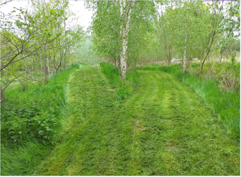

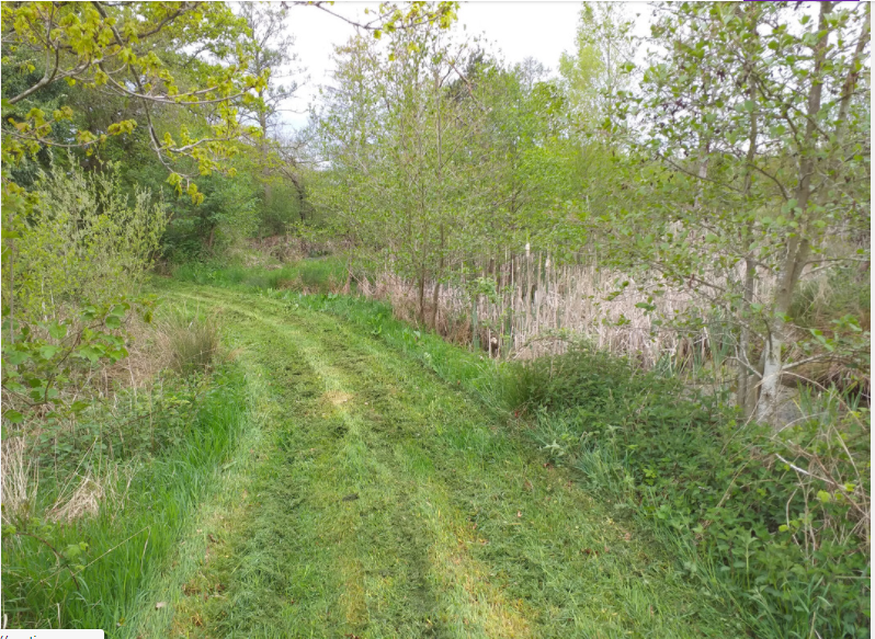

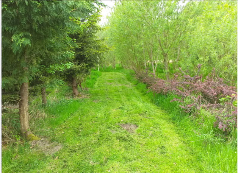

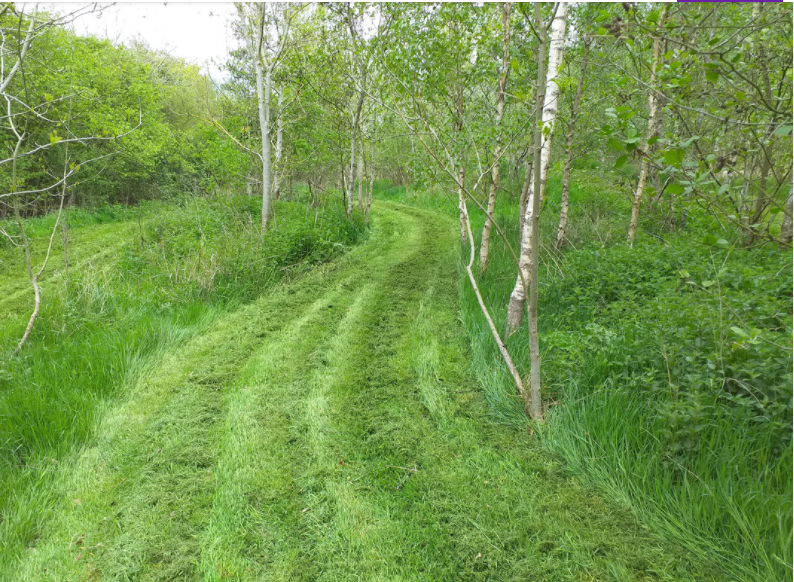

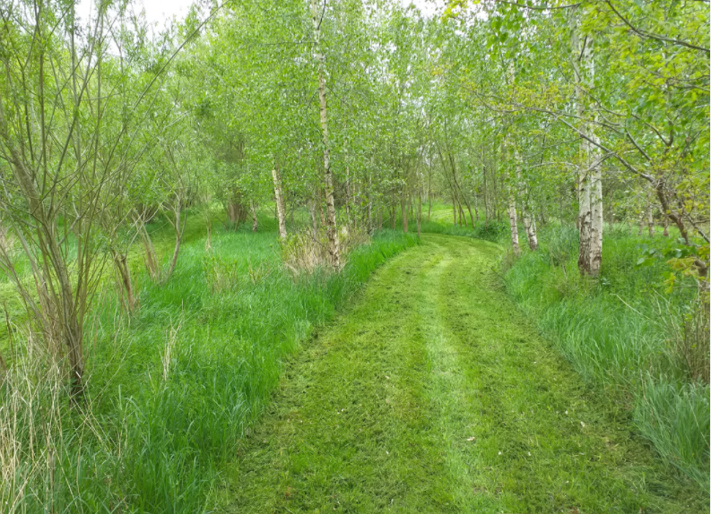

hi its a LR 300tdi which is a 4 pot, foot pedal will be sufficient for now, i dont do a lot of mowing im not a contractor i just have some trails through the woods that i planted that i like to keep clear, maybe an hours work once every 2 weeks through the summer
its all forward direction mowing no tight spots or reversing around trees or i would be looking at rear steer and hydraulic drive, a full size tractor just squeeze's through but all the branches are now hitting the windscreen so something a little less in height would be an advantage
all those pics are a few years old but all i could find, out of interest i will go and stand in the same spots and take some up to date ones ro see what difference a few years makes
