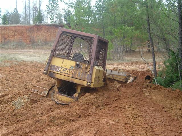

Try laying a log across the back of the tracks and chain it to the tracks on each side. Back up slow and the chains will pull the log under your tracks and you can walk right out.

Cut logs to get under front blade. Put enough under till you can lift front of machine and break suction. TRy to force some under front of tracks to support weight. chain log to rear of tracks. after suction broke try reversing as log pulled under shove next log with it. rear of machine should start to lift keep feeding logs under rear tiil on mat. Dont forget to unchain fist log.........Have had to chan logs together so first log will pull next ones under when working alone. Good luck Breaking suction in that grey mud is important.......

Well, She's out!!! And she managed largely under her own power with only a minor assist from our Montana 4340C. Chaining the log to the tracks made all the difference. Now, as promised: Pics!!!!
Here's a general overview of the situation as it was around 9:00 this morning, after sitting all night.
Here's a closer shot of the dozer before we worked any today:
And a side-view so you can see how deep the front end was buried:
A view from the front. My dad is standing behind the dozer (looking rather confused) trying to disconnect the chain that survived our aborted attempt last night:

We chained the log to the back of the dozer again, only this time we wrapped the chain around the pyramid grouser twice before hooking it so that the chain would be taking the force rather than the hook. Started the dozer up and it took the log under, moved back about a foot and then stalled. At that point my dad went back up to the barn and brought our Montana tractor down and hooked on to the back of the dozer.
In this pic, you can see the montana hooked up to the dozer just after our first pull. By this point the log is already up to the front of the dozer and we've stopped to disconnect it.
Here are a couple of pics showing how far we got on the first pull:
This next one was taken before we disconnected the log before we pulled the second time.

Before we could get the log loose from teh right track I had to spin that track forward some more and raise the front of the dozer up with the blade. As I was raising the dozer up the downpressure from the blade snapped the post. The irony here is that the post we're using is the last remnant of a post I broke out from under our pole barn parking the dozer about a month or so ago. We didn't bother chaining up another log to the tracks for the final pull. Using the Montana to keep tension on the chain and keeping the dozer at full throttle she climbed right out of the hole.
Here's a few pics of the aftermath:
Looking from the back:
From the front:
From up the hill looking down:

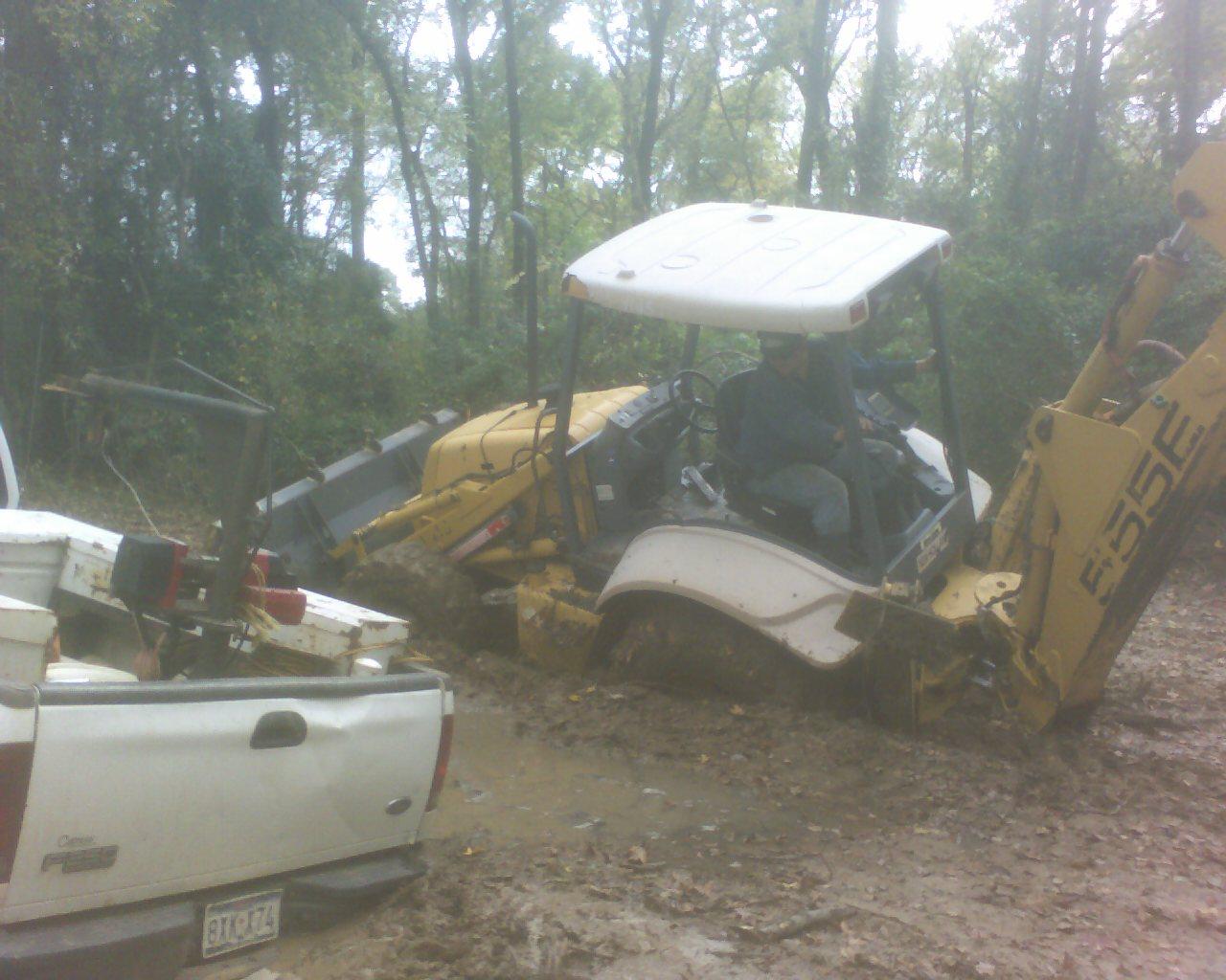

Been there, done that. As you can see in the picture I've attached, I did something similar. In my case, I was filling in a hole from a tree stump that I had let fill with rain water. It was a spur of the moment idea to fill in the hole as I was driving the dozer back to the barn towards the end of the day. I saw that water in the hole and thought to fill it in and stop it from holding water. That was a big mistake.
The dirt turned to oatmeal in the hole with the water. The more dirt that I put into it, the better it looked, but then when I tried to drive over it, I sank. The first time, I got out, but I'm not so smart, so I did it again. That's when I sunk. Then I made it worse by trying to get out and digging myself down deeper.
It took a full day of digging with my backhoe and shovels to get it out. The tracks were just spinning and the weight of the dozer was on the belly pans. It acted just like a suction cup and nothing was going to happen until the tracks got down to solid material. I had to tunnel under the dozer and remove that mess in order to get the tracks to get down to the solid dirt that I had dug down to with the backhoe.
In your case, I don't think that pumping the water will work. I'm not even sure that the problem is water table related, but it could be. I think that you broke through the sand, which was more stable and able to support the weight of your tracks, and into the silt, which has no ability to support any weight.
I don't think you can dig down to something solid to get out, so that leave you with two options. Neither are good.
You can try to pull it out. With enough power, this will be the easy way to go. One advantage to a small dozer is it doesn't weigh very much. I got a JD 450G stuck in the mud once and was able to pull it out with my backhoe. Just hook the chain to the dozer and the hoe bucket and pull with the hydraulics. You will always have more power with the hydraulics then you ever will with tires and traction. If that's not an option, then a tow truck might be needed with a big winch. In the end, this might be the cheapest way to go. Just bight the bullet and write it off as a learning expense.
The other way, and the physically demanding way is to cut and place logs under the tracks. You need to create a mat. Imagine a log raft like Tom Sawyer would have used. Get some logs that are longer then the width of your tracks. You will probably need at least a dozen of them, but it might be more depending on how bad it is. The size should be big enough not to break under the weight of the dozer. I'd guess at least 6 inches, with bigger being better if you can handle them.
I did this one time and cut down the trees with my chainsaw fairly close to where I was stuck. It wasn't as bad as the picture, and I was out in just a few hours. I never took pictures of that one.
I couldn't get the logs under my rear tracks, but was able to lift the front end off the ground with my blade. I had to put some smaller logs under my blade to stop it from sinking it, but once the blade was solid, I was able to get the front tracks off the ground a few inches. With a shovel, I slid the logs in under the tracks. My first attempt failed because I tried it with just a few logs. They just sank into the mud. The next time, I put allot more logs in there. Maybe too many, who knows. But it worked. I was able to get up on the tracks and just drive on out of that wet spot.
The longer the longs, the more they will support. It's just as simple as making that raft or mat. If you are unsure of this, go to youtube and do a search for excavator and mats or stuck excavators. There is a guy that uses them all the time with his excavator while working in mud. He's amazing and if you find his videos, you'll see how crazy or good a guy can be with them and working in bottomless mud. If I find the links, I'll post them here.
