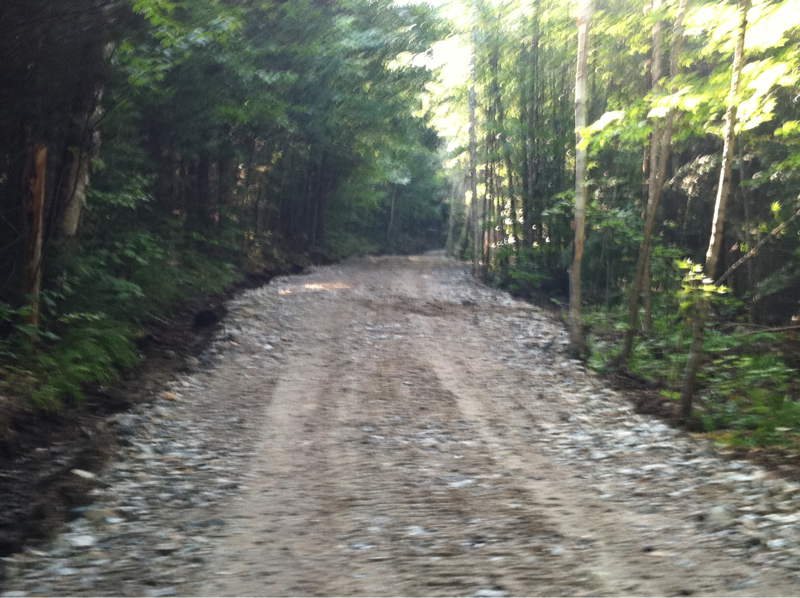

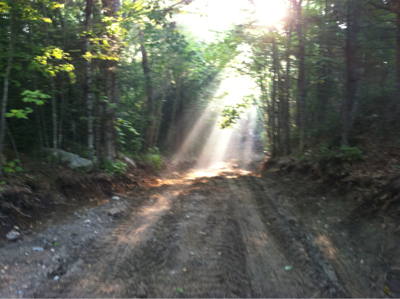

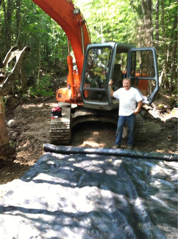

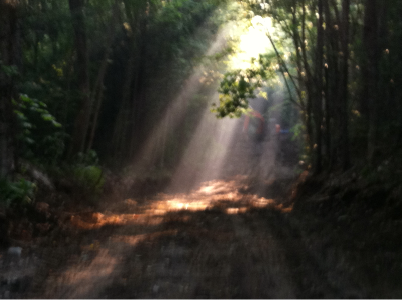

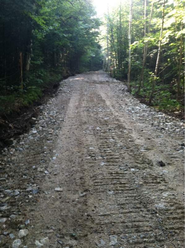

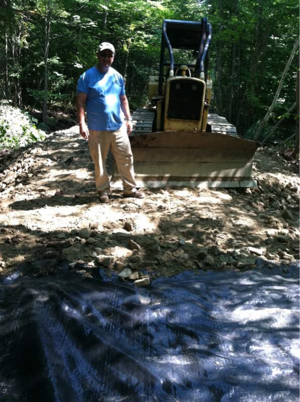

Finished the road yesterday. It took twice as long and cost almost
twice what I expected. The result is pretty good. We used six inch gravel spread at a thickness of 8" to 24" depending on grade. In the wet area we first put down road fabric. We also put in six culverts four 18" and two 24".
I started out planning on using the excavator and Kioti dk45. After upgrading to New Holland work master I ended up shelving that and buying John Deere 450 C dozer. I should have bought the dozer to start with, we flew after that.
At first we could only handle one 17 yard truck an hour. By the end we were waiting on three an hour. Lesson: right equipment for the job saves time which saves money.
Some pictures are attached I hope.
Taking a week off and then on to clearing the land,'selling the wood, putting up the pole barn, setting up the electric fence and getting some pigs in.
Total spent so far including land purchase, equipment, road materials and wages to my foreman about $200,000. I will be taking up a collection next week!
I am going to try to get an aerial shot of the road for perspective.
The adventure continues.
More to come.

Looking great!
Hard to beat a dozer & hoe combination!
   / Big Multi Year Project About to Begin...help! #116
Looks like a good start! Keep the pix coming.

That road will take a lot of maintenance for the next many years until it is 'finished' project. You will need to keep working it, leveling, filling holes, etc until it has a solid botom and then finish off with 3/4 or 1/2" minus "with lots of fines" for the top. When I bought my shack it came with a 3 car, 100'long drive that had been in use for at least 30 years. It still cost me a full dump from one of those tandem bottom dumpers (?30? yards) and then about 5 years later a 'blading' and antoher dump of the same. It is now almost concrete solid but still has 'weed problems' I look at them as part of my ?landscaping?. :)

The plan is to but down some 3/4 inch next summer after we see what the spring does to the road. Winters are hard in this part of the state and I expect a verdict on the job we did by spring. I expect some maintenance every year.
