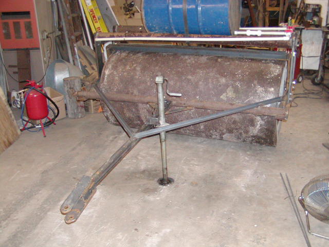

I built a couple of rollers, one 36" dia x 6', filled with concrete.
The water barrel on top is for when I want to roll some asphalt.

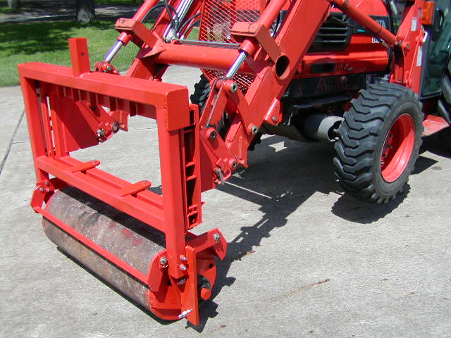

the small one comes in handy for special applications. Is mounted to the fel so you can lift it up or lift the front of the tractor and move with just the roller & tractor rear wheels on the ground.
It is 16" dia filled with concrete.
Also made double row sod digging attachment to go on this roller.
