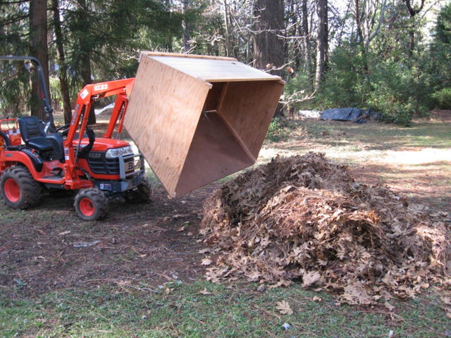

I built this big bucket for my scut to move raked leaves to a central burn area. The bucket is almost 2cuyd capacity (1.97 struck)...and it works!
The bucket in the photos is a wooden prototype but built strong enough to function to see if it would work and see if any modifications were needed in the design. I'll post the prototype construction in the Build-It Yourself forum.
The bucket is not "self loading". Unless you had an enormous pile I don't think you could "scoop up" a load. I use my small tractor homebuilt rake to load the big bucket. Two or three pushed loads of the rake fills the bucket. Sometimes I need a small bit of pitchfork work to top it off once the bucket is curled. I'll also get photos of the landscape rake to Build-It Yourself. It has served me well the past 7 years and continues to excel in its job.
BTW - The big bucket is designed so that the ends detach, the top folds down against the back and the pair of these fold down onto the bucket bottom. You could add hooks to it and hang it on the wall like a thick table top!
The Bucket opening is 6'-8" wide x 3'-10" high

One modification I'll do is to make the next bucket wider. This is too tight of a fit for my 6'-4" rake.

Curl and Go
Boy this is easier than a pitch fork and a trailer!

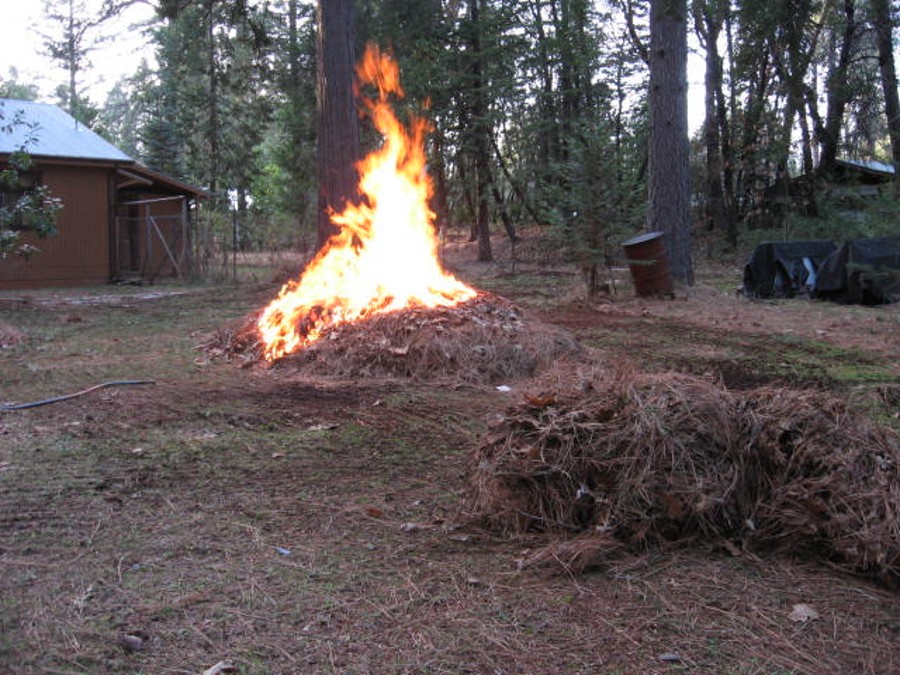

Once the pile is burned down a bit I plop on another load.
A nice thing about dumping is that the pile is "loose". I used to push into burn piles with my rake and piles took longer to burn because they were compacted without as much air space.
Ahh. Where's the marshmallows

When you call that a proto-type are you meaning that you plan to build one out of steel? I would just keep using that one - it works and looks like it works great. No reason to have the heavy duty steel and add all that weight to the front. Great job and one **** of an idea

You're right the wood box works fine and I'll keep using it until it breaks. Eventually it will (break) but I may get several years out of this one. The next generation would be of light sheet metal over metal stud framing members. Only the bottom and back need to be stout and uneven then the back can be pretty lightweight if reinforced correctly. I would keep the weight down to less than 100 pounds.

Yes, you are right. Building with steel will be difficult to keep the weight down below 100 pounds. But my intention is to keep it "lighter duty" than yours. I have not picked the metal materials thus have not calculated anticipated weight. My hope is to build with sheet metal and frame with steel building framing members. Steel studs are strong but light, getting their strength from the shape of the stud. Since I normally overbuild, keeping it light will be a fun challenge. For now the wood prototype works great and my guess is that it weighs in at 75 to 85 pounds.

We do compost a fair amount, about 25%-30% overall, but mostly the oak leaves. Pine needles do not compost well and add to the acidity of our already high acid soil that we fight to get gardens into the neutral zone. That, and there is just too much volume to deal with. I may be off but I guess each acre produces 8 to 10 cuyd of debris a year. 5 acres x 9cuyd x 3 yr for pine needles to decompose (that's "sort of" decompose!); my whole property would be a compost heap.
Ironically we burn the needles for fire protection. When you live in a National Forest the fact of life is when, not if, a forest fire comes by what shape will you be in? My annual burn is probably not equivalent to 1 second of a bone fide forest fire which, by the way, is a natural occurrence. Earth can handle this. The pollution from my vehicles and tractors (and yours) is a different story.
