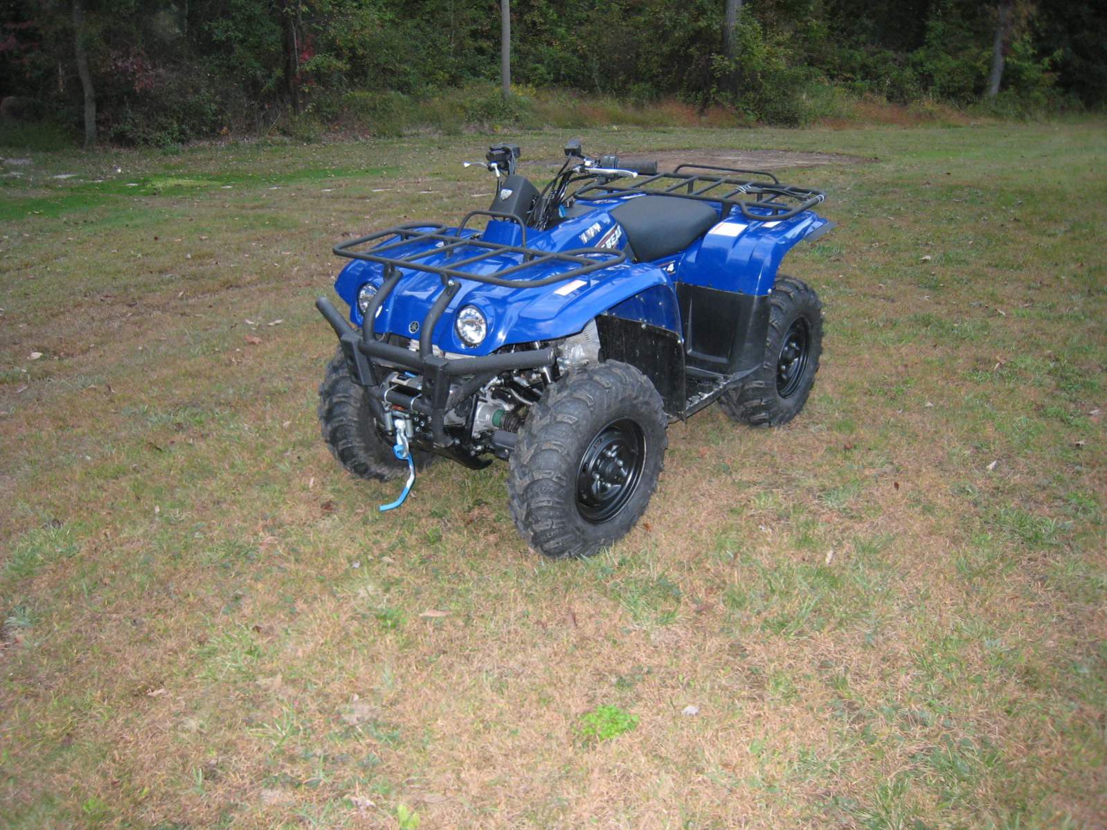

I have a 2009 Big Bear and I wouldn't want any other utility ATV! The big bear does need time to warm up before the shifting loosens up but once its warm, it performs excellent (mine only has 23 miles on it). I got a great deal of $4600 before tax and prep fee. It is my second ATV and I am impressed with the torque, how easy it is to start, how smooth of a ride it has, and the overall simplicity of the machine. I bought the plow set-up (and winch) and hope it plows as well as my old Honda Rincon. After riding my friends Polaris (pulling a small trailer) and smelling the belt burning, I did not want any belt driven ATV. The Big Bear has two drive shafts and seems pretty bullet proof.
