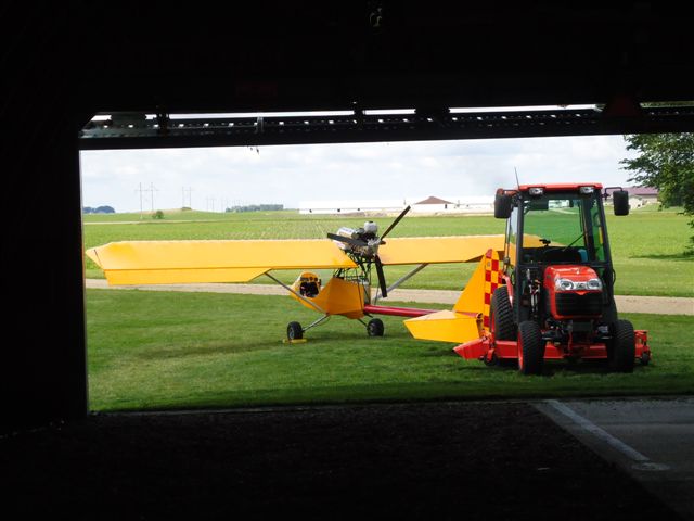

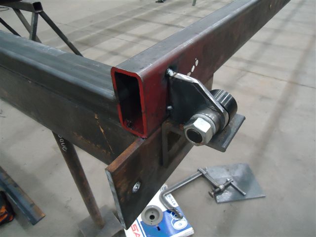

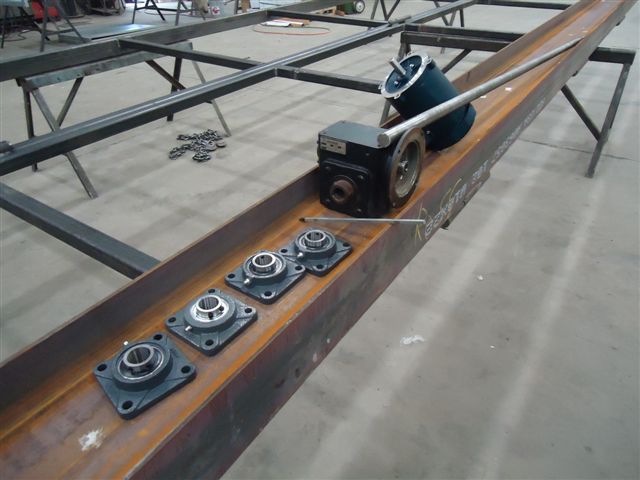

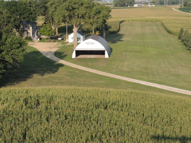

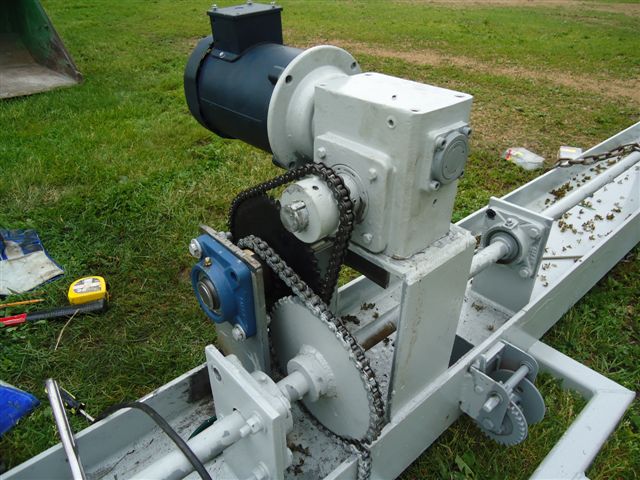

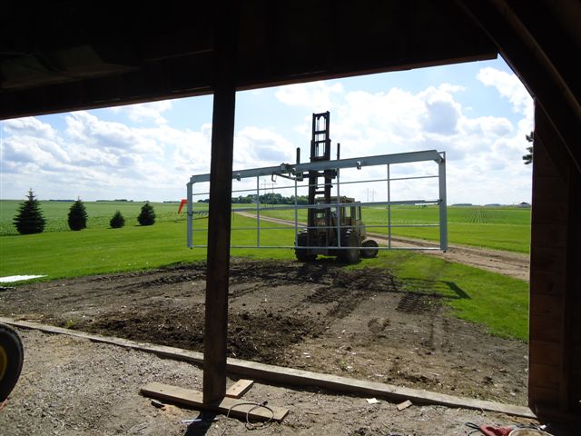

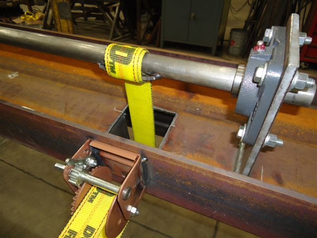

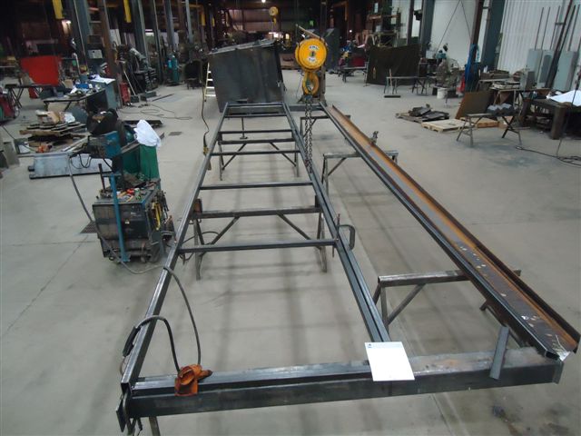

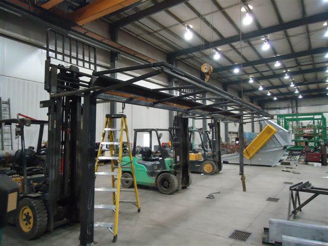

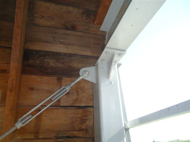

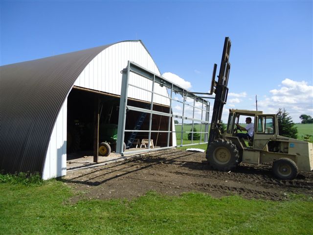

I saved a few pictures from the Bi-Fold door I built last year. Using only a half HP motor.
Enjoy !

That is great! Looks like you have access to a nice fab area. Your strip looks great. wish I had my Kolb flying. I gather you are near P.I.
   / Bi-Fold aircraft Door 30' x 8'
Where in Minnesota do you live, which Kolb do you fly. We should get together. Where is P.I. ?

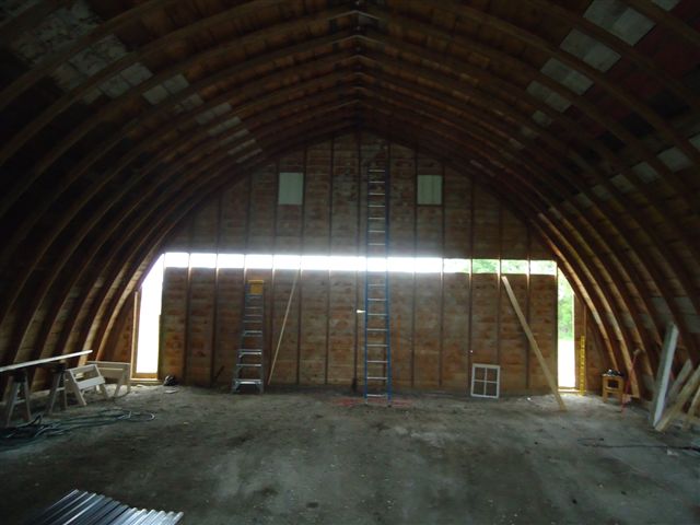

Nice door, I like the wood arched hanger.
Dave
Dave
The Quonset shed was popular in the sixties...a sight for sure but they do have some major drawbacks to the simple design. Mainly the walls pushing out and roof saging. I had to reinforce this one with buried rebarb and added fill to the outside walls.

Friend of mine has a Kolb. That thing would climb like a beast compared to our Phantoms.
Kolbs & Kubotas are a good match....They out perform the competition Hands down !

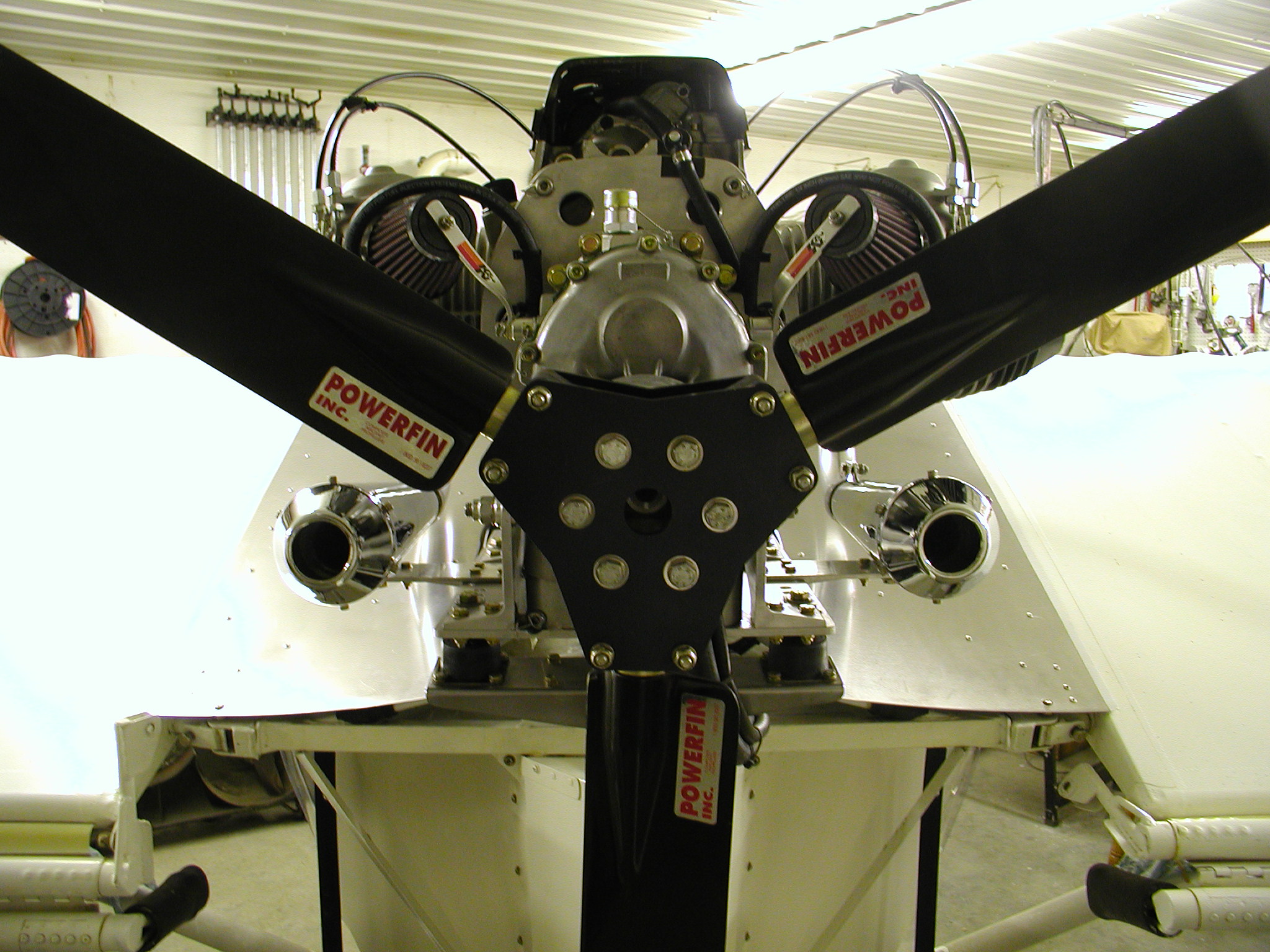

Nice! Makes me almost enthusiastic enough to clean the carbs and start up the old BMW-powered pusher.
Do you have any more pictures please, often wondered about the BMW power plant on my Kolb.

a few...
