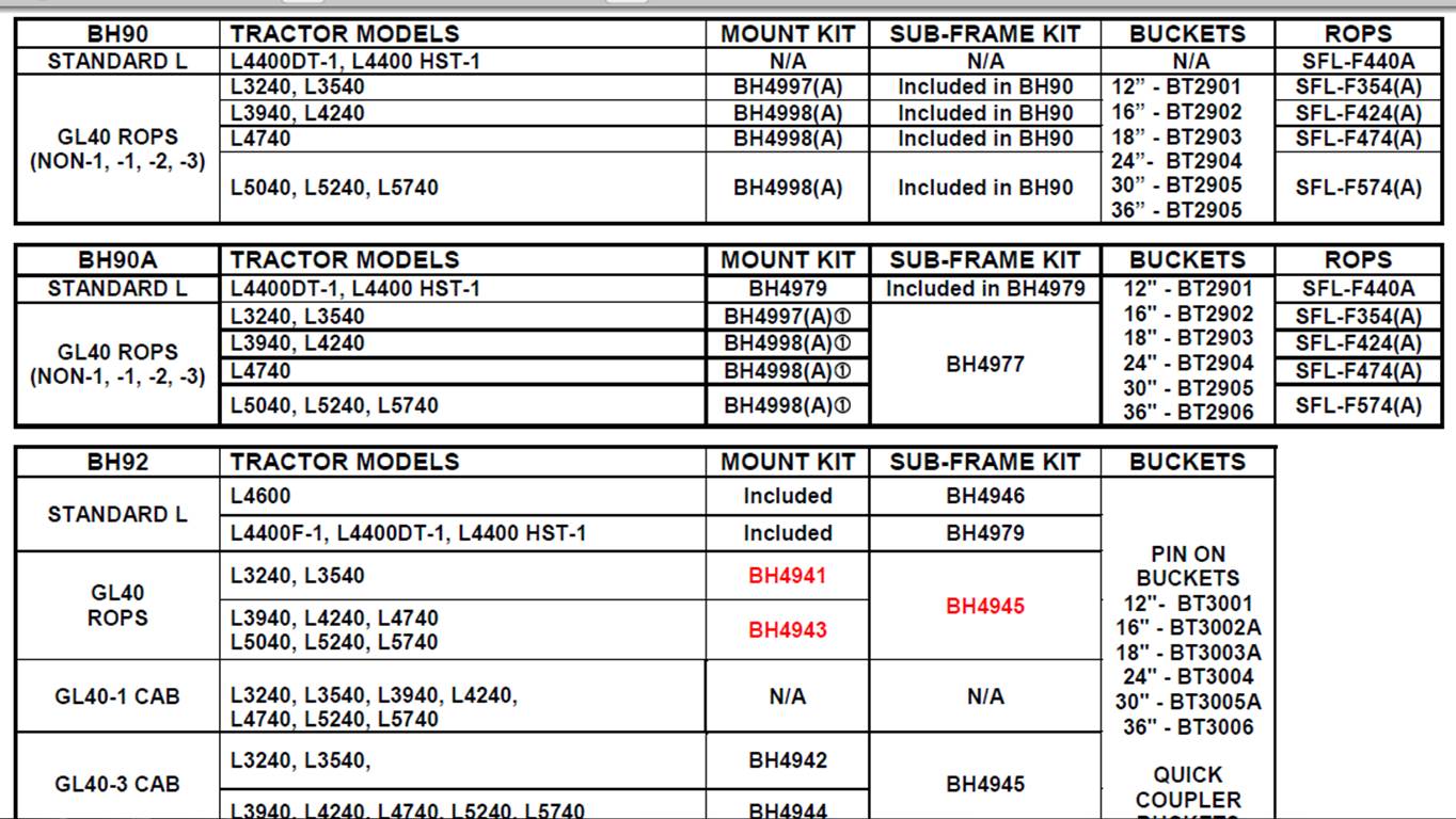

Does anyone know if the pin-on buckets from the BH-90 fit on the newer BH-92?

Jan 2, 2014 / BH92 bucket same as BH90? #4 M moship Veteran Member Joined Nov 2, 2007 Messages 1,258 Location PA Tractor Kubota L3130 HST 4x4 Kubota L4740-3 HST According to the Wholegoods 2013 the buckets are different p/n's between BH90 and BH92.
Jan 2, 2014 / BH92 bucket same as BH90? Thread Starter #5 OP FatTire Veteran Member Joined Oct 2, 2007 Messages 1,355 Location Colorado Tractor Kubota L5740, Unimog 404 w/ snowblower, Deere 620i UTV, MX5100 (sold) moship said: According to the Wholegoods 2013 the buckets are different p/n's between BH90 and BH92. View attachment 352935 Click to expand... Thanks, I'll watch for used buckets in the BT3000 series...
