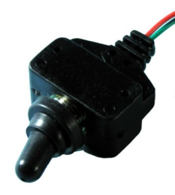

like a trigger.... i run the hoe with the palms of my hands on the top of the handles. something i can pull towards me. Oh goodie! something for me to ponder and locate on Amazon or Ebay!
