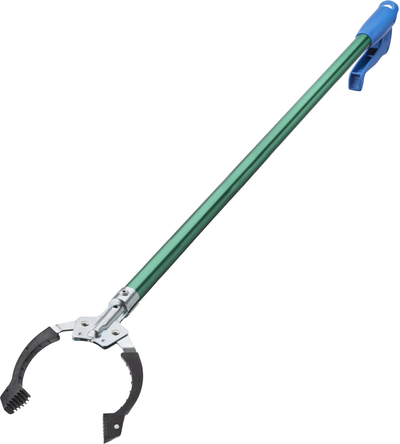

I had a BH90 hoe behind my L3430HST. It took me on average 15 to 20 minutes to swap between hoe & 3 point. I found it worth the expense even though I only use it 3 or 4 times per year. I got back most of what I paid for it when I traded it for my current MX5800 & BH92 hoe.
If your have HST, you can do what I do and clamp pieces of rebar to the FEL joystick and HST pedal. That way, you can move the tractor from the backhoe seat. When necessary to turn, I use this grip extender tool to grab a spinner knob mounted on the steering wheel.
