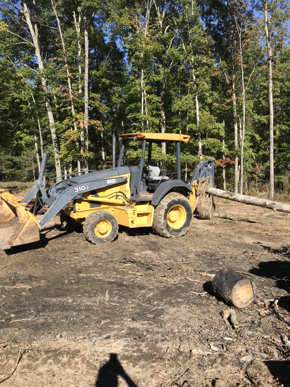

Yes you can use both seats at once. I’ve done it with my previous tractor backhoe. If the tractor has cruise control you can drive forward yourself from the backhoe seat. Yes you have to take the 3 point arms off but it’s pretty easy to do. Stumps are a pretty tall order for a tractor backhoe. I wasn’t happy with my BH-90 so I fixed that problem. In hindsight maybe I over did it. A L45 isn’t a much physically bigger machine but is a much more capable machine than my L3240 was or the 2501 you’re looking at. A L45 will outperform the l2501 by at least double probably more. Even a B26 is probably 50 percent stronger.

Great. Thanks for that input. Really wanted to here from someone who had actually done it. That L45 is a much heaver machine and the extra HP and pump capacity really would make a difference. One thing Im learning about tractors. You always need a bigger one, and more than one! Thanks again.
