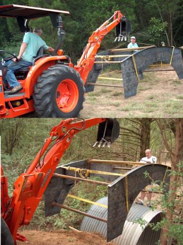

I have the BH90 - no problems in over two years. I have dug ponds and stumps and have removed tree limbs and moved bridges.
