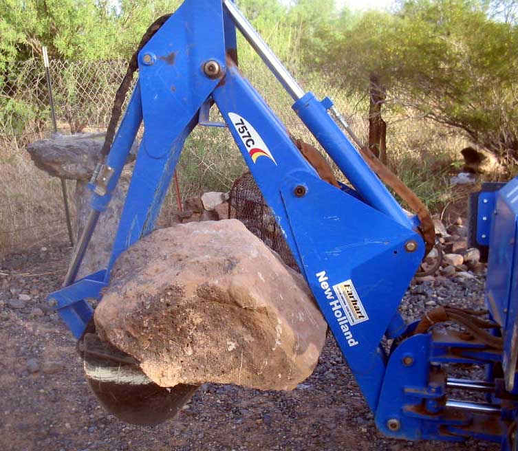

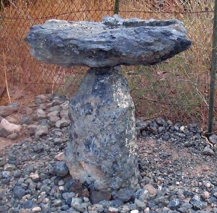

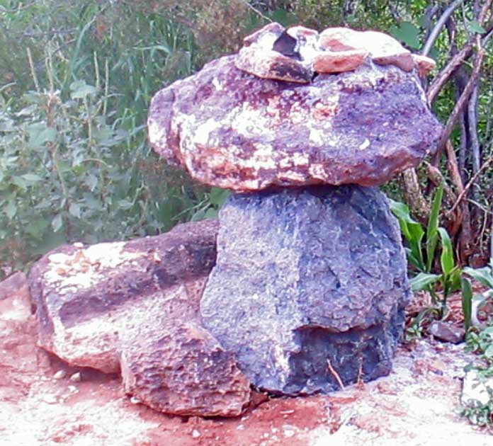

/ BH72 / 92 backhoes. Useful? #13
2'+ Rocks not a problem with the 757C, do have play a little getting them in the 12" bucket and they hang out a little. :laughing: But I have picked up and moved even larger rocks.
The balanced rock bird bath was done with the back hoe, each of those rocks is about 4'. Other B/B the rocks are shorter about 3', but a lot bigger.

/ BH72 / 92 backhoes. Useful? #14
Nice work! :thumbsup:
